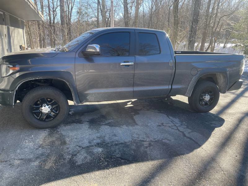

    537
    Quick hit with the wire wheel and a rattle can and the stock steelies are on! Looks like a police truck now! LOL. It's up at ECS now, as soon as they have a DYNO opening, we'll get the numbers!

  2. Feb 20, 2024 at 8:21 AM
    #692
    Ghost Rider
    Ghost Rider Mods wouldn't be an issue if money wasn't.
    Jul 7, 2021
    #65274
    1,618
    Ian
    Cypress, Texas
    2021 White Tundra CM SR5
    fingers crossed the wheels will not snap.... those are some rust on that, but hopefully just surface rust....
  3. Feb 20, 2024 at 8:35 AM
    #693
    TurboKits
    TurboKits New Member
    Nov 11, 2022
    #86522
    537
    Yeah it was just surface, they cleaned up nice.

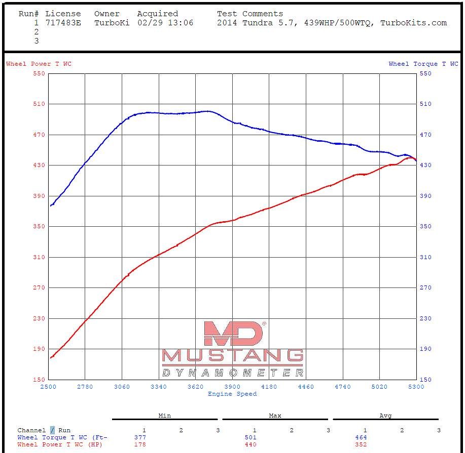

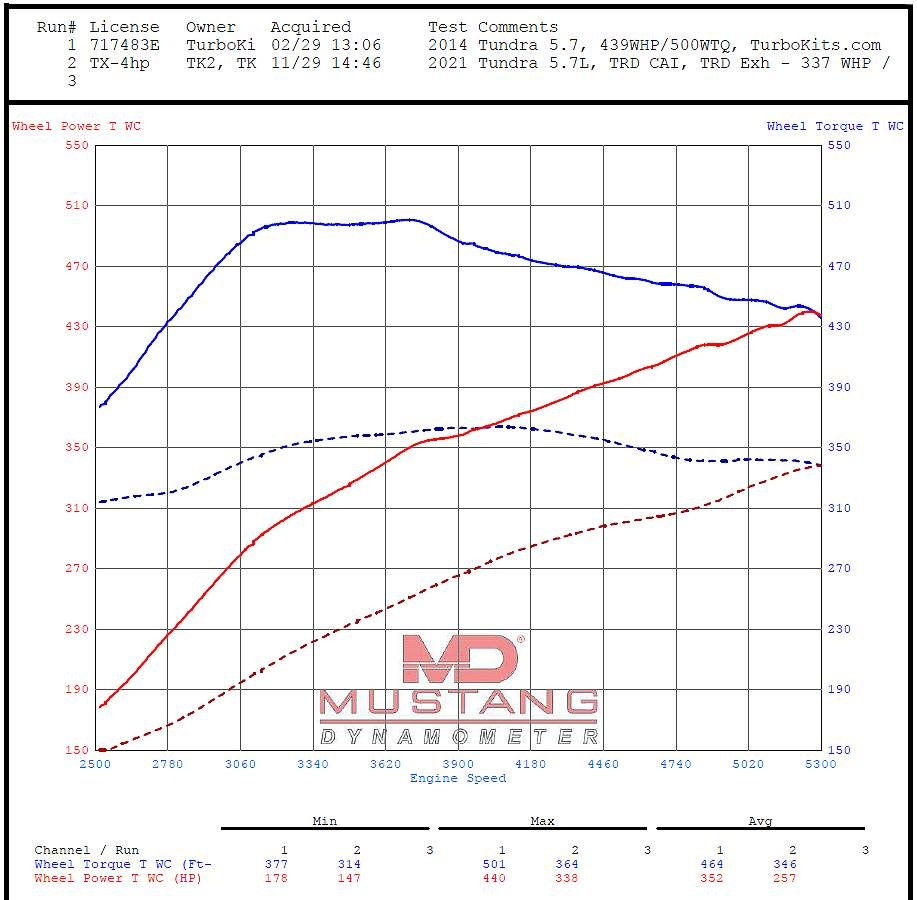

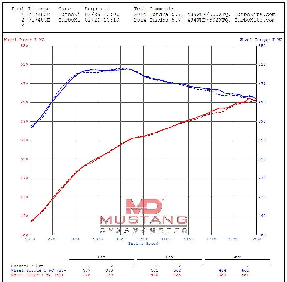

  7. Mar 1, 2024 at 10:26 AM
    #697
    TurboKits
    Nov 11, 2022
    #86522
    537
    Hey all, pulled some charts from the DYNO session yesterday to show more data! Enjoy!
    2014 Tundra Stage 1, Banks CAT Back and Turbo Kit Only - Main Run
    2014 Tundra Stage 1, Banks CAT Back and Turbo Kit Only - Back to Back (Consistency)
    2014 Tundra Stage 1 -vs- The 2021 Stock Run (TRD Intake & Exhaust) on the same DYNO.
    Have a great weekend folks. We'll respond to all the questions once we get caught up form this. Thanks!

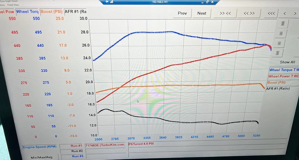

  11. Mar 1, 2024 at 12:35 PM
    #701
    TurboKits
    Nov 11, 2022
    #86522
    537
    12 - 11.5, keep in mind we have water meth for chemical cooling and are at a chilly 4.5 PSI. The logs are PERFECT, even on those crazy overloaded runs on the first DYNO, not even a hiccup, the knock feedback was flatline!
    Silver17[QUOTED] and coTony like this.
  12. Mar 1, 2024 at 12:38 PM
    #702
    TurboKits
    Nov 11, 2022
    #86522
    537
    Here is the raw photo from the DYNO run that was in the video above! Keep in mind this is at the tailpipe, which changes the readings slightly from the AFR sensor we have in the downpipe.
    Silver17[QUOTED] likes this.
