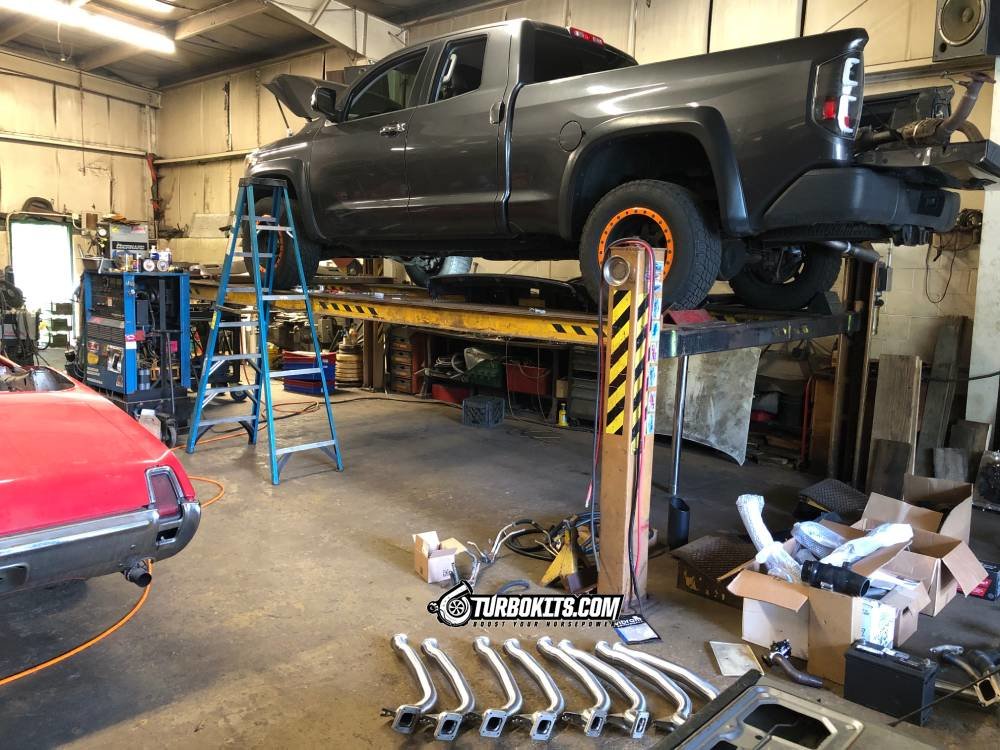

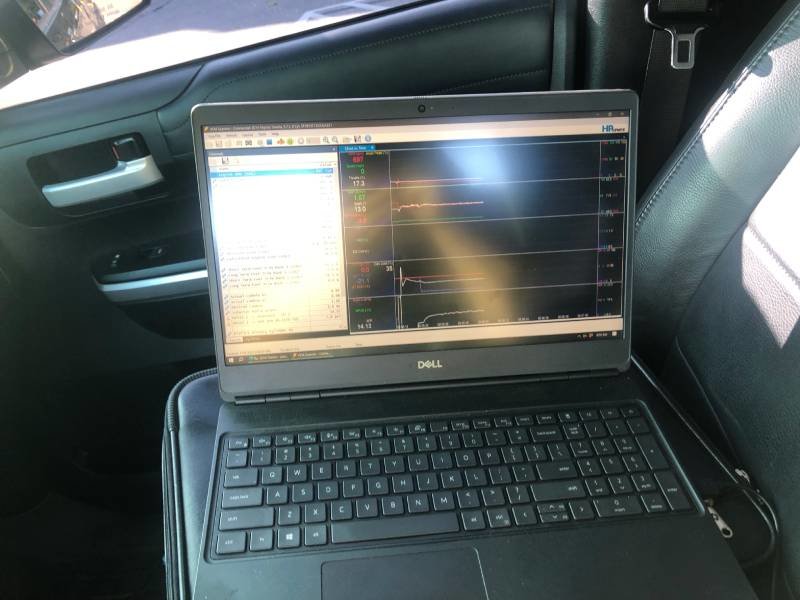

    More progress, almost there...

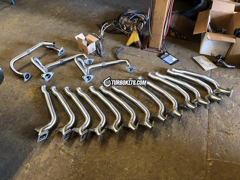

    We have our Stage 1 kit back up and running on our new shop Tundra. We pre-installed the intercooler so we can jump to the stage 2 quickly once we have the stage 1 wrapped up. We are working on dialing in the Stage 1 tune now, then back to the DYNO, then Stage 2 install and rinse and repeat!
    Timeline since we lost access to the black Tundra and had to put it back to stock and give back to the customer.
    - Located and purchased another Tundra
    - 100% stock DYNO baseline
    - Final QC on our first stage 1 production run, test fit randomly 6 kits to assure fitment for all customers will be the same
    - Final install of the Stage 1 on the shop truck
    Upcoming milestones
    - Stage 1 tune dialed in and back on the DYNO for results
    - 5 DIY testers of the Stage 1
    - Upgrading to Stage 2 on the shop truck
    - Stage 2 tune dialed in and back on the DYNO for results
    *we would hope while we are working on the Stage 2 results, we will be receiving feedback from the DIY testers to post as well.
    Thanks again for all of the support!

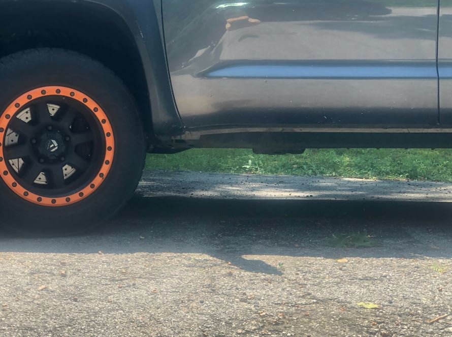

    Can you grab a pic of the truck sitting with the crossover pipe installed, from ground level so folks can see how low the pipe is compared to other underside components?
  10. Jul 28, 2023 at 9:42 AM
    #610
    TurboKits
    TurboKits New Member
    Nov 11, 2022
    #86522
    539
    Absolutely, it's tucked up nice and does not sit any lower than anything else. If not an inch or so above the rear diff and the front lower control arms.

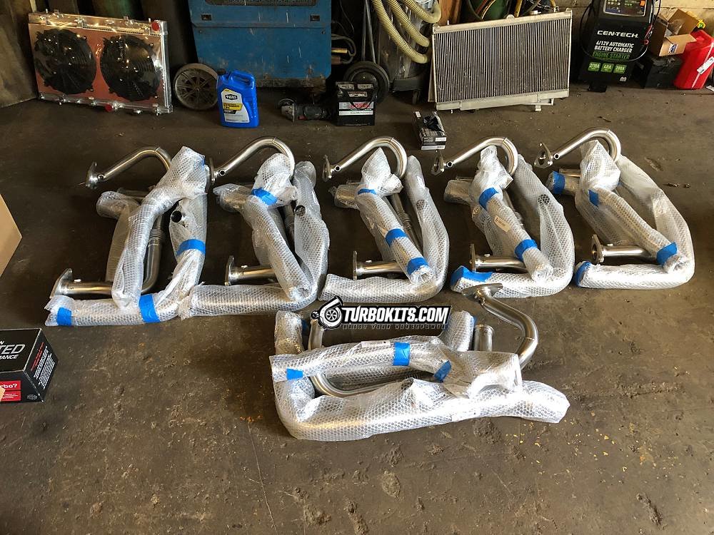

    Yes, actually tons of progress on our end for production release stuff, but nothing major of note that would get you guys excited. It's race season, so most of the people we lean on are busy at the track. Our fabricator is busy keeping cars/trucks on the track. The company we use for our DYNO is actually the world record holder in the EVO 4G63 world, so they are prepping for racing most weeks. It tends to be a tad slow going in CT mid/late summer. Progress tho, has been made.
    - We received our stage 2 sample intercooler piping from our mandrel benders. Those dropped right in our test truck. No revisions are needed and we are moving into production, so the Stage 2 will be available shortly after the Stage 1
    - We received the production sample on an additional custom coupler to make the Stage 2 even easier to install. Same as above, that fit right in, no revisions needed, and is going into production as well.
    - We are reworking the Stage 1 coupler to get a little more MAF flow out of it, hoping we can allow for a solid 4-5 PSI on stage one, bumping the Stage 1 power up 20-30HP.
    Otherwise, we have 5 Stage 1 kits pretty much ready to go. We have not pushed for testers, as we want to get back on the DYNO and release the #s along with the post for Stage 1 testers to get on board.

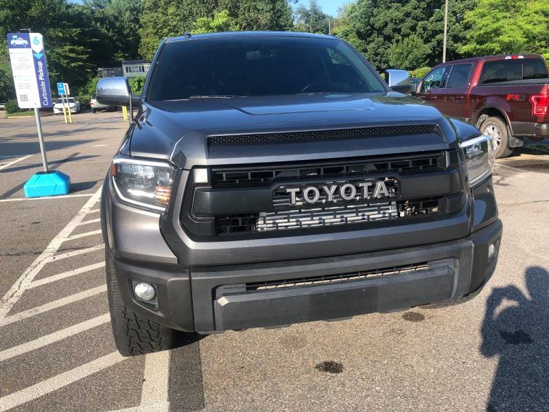

    Do you happen to have a picture of said location?

    Man that HP is ideal for me but the low hanging fruit is not ideal. Notch the skid then you expose the pipe and make it vulnerable and I am sure that is not a cheap item to replace.
    Awesome job on the kit and all the dedication you have put into it, not a lot of the peps that start a big project finish it :hattip:

    You do realize he said not the cat plate and not the skid and that anything in front of the transmission fits like normal?
    This is also why I bought a $3000 k5 to wheel and not my $38k tundra. Way cheaper to fix and maintain and if I break it, it can sit.

    The picture is all I needed to see

    We posted a while back all of the measurements. It's not really low hanging fruit. It's just lower than the rest of the kit, but if I recall, was still about an inch+ higher up than the cross member, rear pumpkin, etc.. Meaning you'll be hitting other, STOCK parts of the truck before you hit the downpipe.
    Here is a pic of the truck on the flat:
