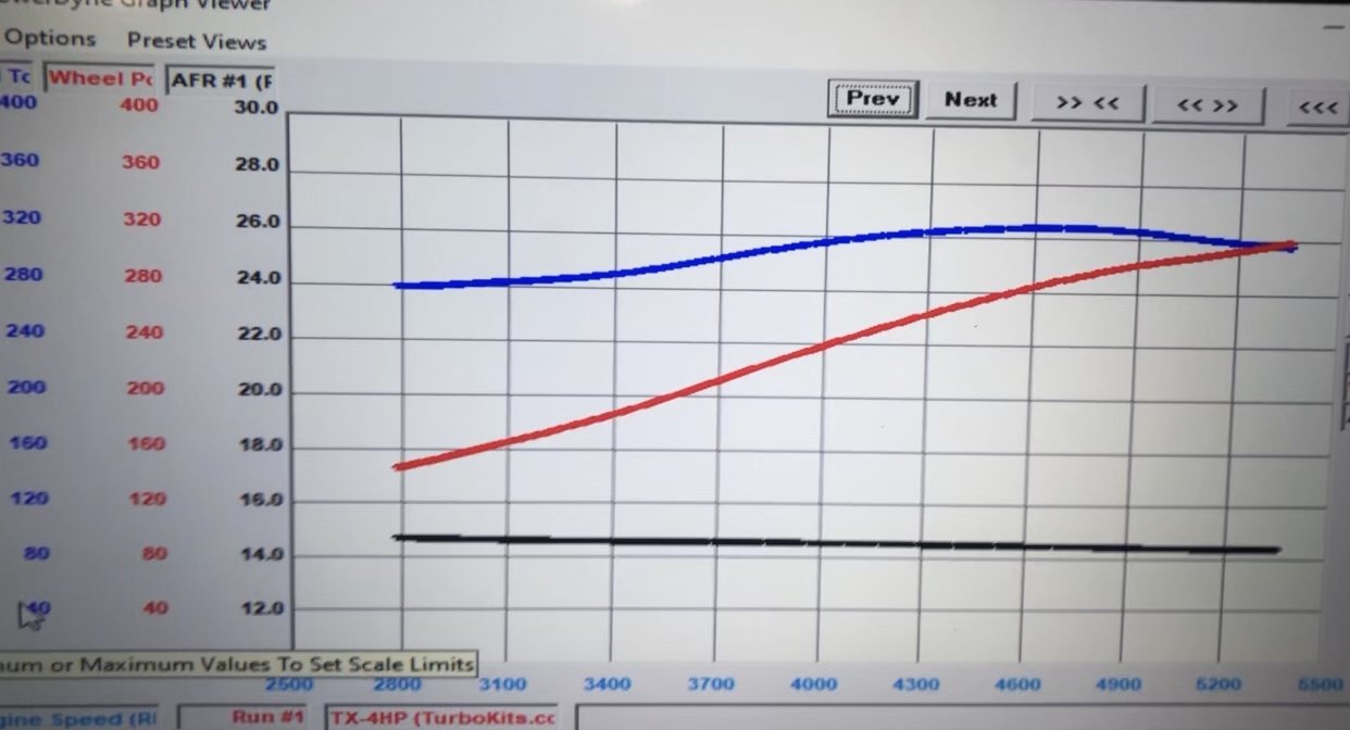

    Truck is in Connecticut, right off the bat straight to the Dyno. Running the TRD dual Cat Back exhaust and the TRD Cool Air Intake my Tundra Pushed 323 HP at the rear wheels with 350 foot pounds of torqueness!! I think that what he said. Files to large over the phone. I will get a copy of the print out. I saw all the stage one parts and also saw my 4.5 inch pip with the mount for the MAF (custom made) for stage two. Stage one will be put on and tuned the to the Dyno. After that they will take that apart and start the stage two. That will be tuned along with the trans and everything will be done correctly. My truck will run great before the call me to come pick it up. 4 to 6 weeks. As I gets reports I will post. I forgot to get the custom piece picture but here is the stage one laid out

    EA0609CF-6DD1-400F-8FE8-DDD4214DB8E6.jpg 320 to 330 rear wheel and torque of 340,, will post graph in a minute
    Give or take a couple HP! That is the first Dyno on a stock Tundra I have actually saw and talked to the people that did it!:)

    Are you on stock sized tires? Those power numbers seem on the high side already for stock.

    Stock tires but dual cat back TRD and TRD cold air intake. There is no reason to make up numbers, see true on a mustang Dyno! No reason to tell fibs on any of this!! Look at the chart

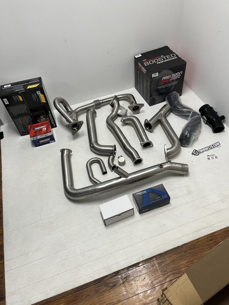

    Precision it’s on the box in the corner. All of the stage one will be what will be sold as a bolt on kit I assume after the first of the year. And that be a single turbo for the stage one and two. They have to turn the turbo for the stage two too!!!:)
    The high flow CAT should be there Wednesday? I thought that was what he mentioned?

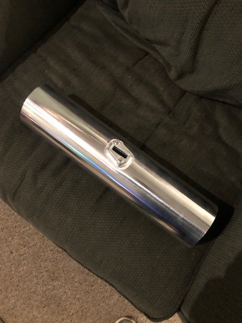

    Sending an email to get a picture of the 4.5 pipe for the MAF!! I saw it and the weld around the mounting plate looks great!!:)

    Here is the big piece for the MAF.
