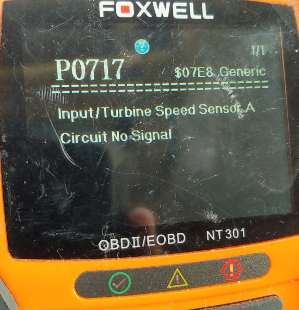

    I have2014 tundra 5.7 v8 sr5. Check engine light came on aswell traction control off message. Code p0717 comes up says turbine speed sensor. I am out of warranty so I’m trying to fix on my own. Anyone know where the sensor is located or how to fix

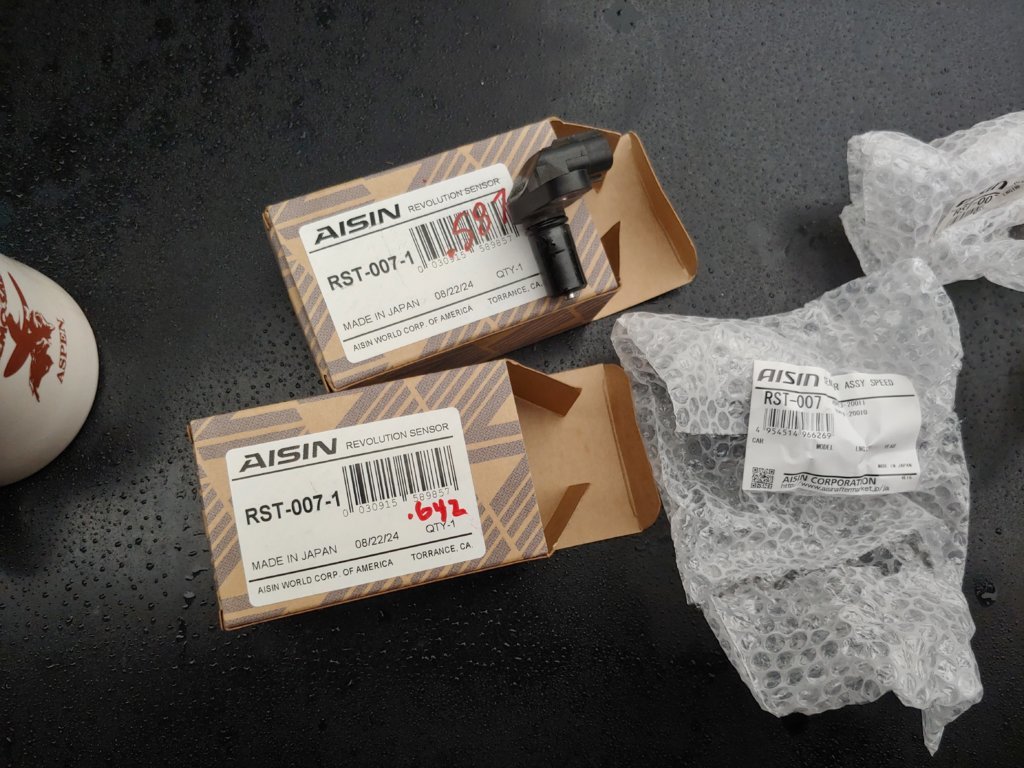

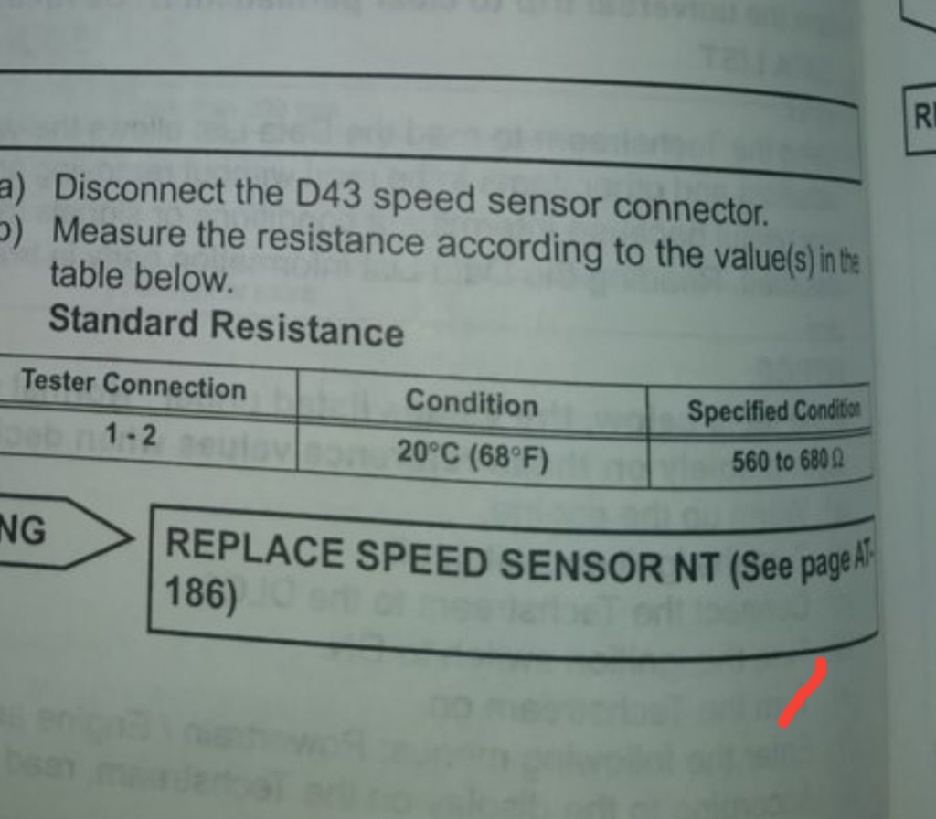

    P0717 NO SIGNAL OF TURBINE SPEED SENSOR A.Code ! DO NOT BUY THE AMAZHON IN PUT SPEED SENSOR even it's cheap 21 Canadian dollars, END WITH THE WRONG PARTS CAN NOT BE INSTALLED! EVEN IT SAY IT FIT YOUR 2014 TUNDRA .Today in Toronto the weather is very good, I tried to installed the parts which is above the coolant pump ( I guess , I saw two black coolant hose goes there) , the job is not that hard if you don't have a huge hand. I used flexible head rachet 10'mm, and spend some time to clean the bolt, the job was not that hard to do, I use a long screw driver to take out the sensor (a little bite to the transmission body) I had check resistance read 667 om, looks good, compared with Amazon it read 670 om, but Amazon sensor the fastening is a straight line one ,it would not fit , the original Toyota had 45 degree. The hardness connector not long enough to reach there, if you want use this parts you had do cut the connector to extend the wire in this way you can connect, I did not do this way , because I love this truck, I reset the code and drive to Don Valley Toyota , the check engine light went on after 3 KM, I had paid 235.00 for the QEM parts had do wait above a week, I will update what happen after I stalled the new parts.

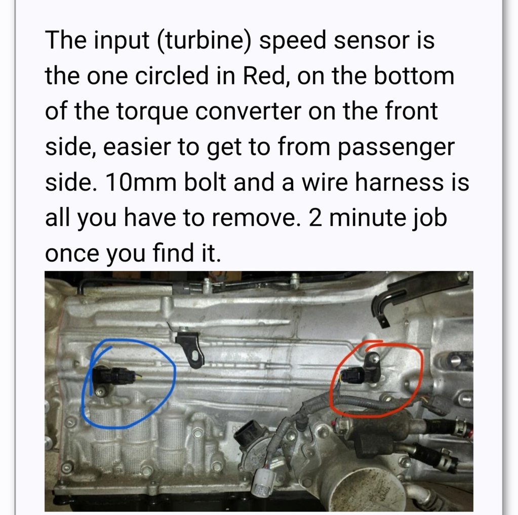

    I found this old thread while trying to resolve the above issue with my 2010 Tundra. I bought the input turbine speed sensor but for the life of me can't find where it's located. I checked out a photo of the location but it appears that at that location on my truck there is a recess where maybe the sensor could go, but it doesn't appear that anything was ever mounted there. I did locate the aft sensor. Would there be any reason for no forward sensor to have been installed? Thanks!

    Found what appears to be the forward sensor on the opposite (drivers) side of the transmission. Could that be the correct sensor? Found an illustration of a transmission that seems to go along with sensors on both sides of the tranny:
