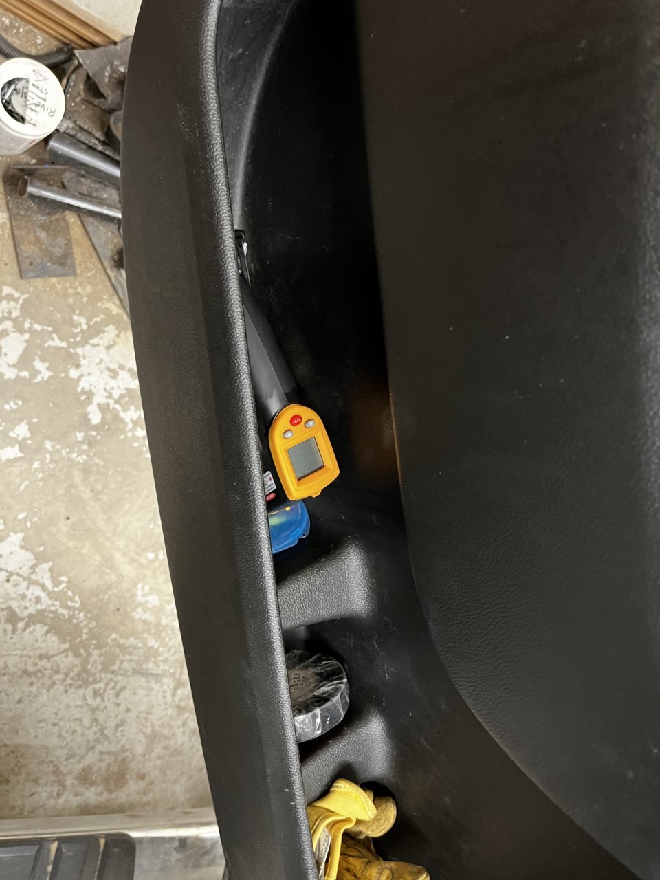

    Sorry, missed this quote.
    Heat, speed, and max capacity is what was killing his tires. Sometimes when you have a blowout on one tire, the tire next to it can get damaged as well. It has happened to me on a few occasions.
    One of the tools I carry at all times is a thermal gun. It’s amazing how hot your tires can get on a trailer. I have seen 168*F, but it was 90+* out and was at max GCWR of ~25K lbs.
    Every time I stop the tires, brakes, and rear differential temperature is taken. The day I seen 168* on my tires…I stopped for the day. No reason to push it.
