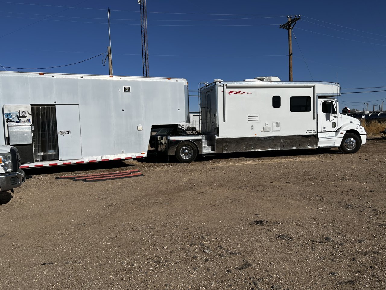

    We aren’t talking about John boats in this thread. Buying a class 8 truck for towing this camper is really over the top since you would need to remove the rear axle (unless you wanted to pull into DOT checkpoints). The Freightliner Sportsman’s class truck is a Class 5 truck and believe it or not, you can find a good used 2007 (pre-emissions) or older with under 150k miles for under 60k.
    I have a really good friend in Texas that has to find this out the hard way. He was towing with a 2007 LBZ 2500 Duramax truck. His trailer was a 47’ triple axle race car hauler. He also had a 60 gallon tag tank in the bed. After blowing out several tires on his trailer and the final straw was a rear tire on the Duramax which destroyed his bed. He also ran the best tires money could buy and kept speeds 65 mph or less in the Texas heat. He finally listened and purchased a toter-home with a stacker trailer. Best 125k he has ever spent.
    59A636F6-FDA4-4571-AAEF-030215C029E5.jpg 8159998D-4DFA-45BA-9715-CFE28A0BAC1B.jpg 37806561-D011-4AAB-8035-3B153658575E.jpg ABBDBC02-7737-42EA-B304-BE713D759F01.jpg
    What some people in this thread just can’t figure out is buying a truck that’s suited for your loads. IF you wanna go overkill…have at it hoss. Some people are fine with mediocrity in all aspects of their lives.

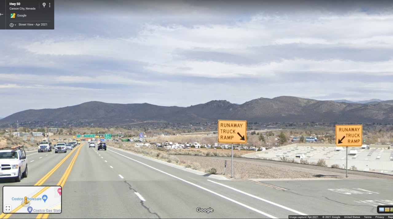

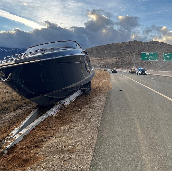

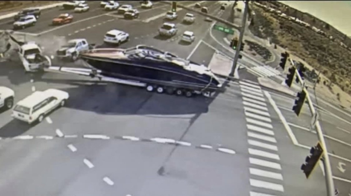

    Obviously, that truck was severely overloaded. He also did not hook up any trailer brakes, and the trailer tires were near bald and under inflated.
    The truck is an F350. And the boat he’s pulling—according to Nevada State Police—weighs 37,000 lbs. His F350 is rated for a GCWR of 21,000 lb, and with that, he was WELL IN EXCESS of not only his truck’s GCWR (ahem, the OP is over his GCWR by 2000 lb most likely :oops:) the GCWR of 26,000 lb, which is the max GCWR you can pull without having a CDL. But the load itself is not the only reason his truck’s brakes overheated and failed. He did not hook the trailer up properly and had no trailer brakes.
    “Required brakes missing on trailer.”
    Someone on a different forum (post #64) identified the boat:
    44’ Riva.
    Dry weight is 29,000 LBS. 12’ beam.
    Trailer of that size is most likely 8k lbs.
    That size of a load (again, according to NSP), and no trailer brakes. :facepalm::facepalm::facepalm:
    Furthermore, that intersection is the first stoplight after coming down from Lake Tahoe on a steady, several-mile-long grade. His brakes were melted way before he hit that intersection. He even had a chance to stop here:
    He should have been in a semi truck, with a valid CDL, and with trailer brakes to drive that load.
    Here is a list of the charges (source):
    “Gonzalez is being charged with two felony counts of reckless driving resulting in death. He is also being charged with the following misdemeanor offenses: unsafe vehicle, obstruction of justice, failure to obey a traffic control device, failure to obey traffic light, inoperative/defective brakes, inspection/repair/maintenance, wheel fasteners loose or missing, required brakes missing on trailer, loose or unfastened tie-down, damaged vehicle structure and pressure points, no record of duty status, motor carrier permit required, no medical certificate, operating commercial vehicle without a commercial driver's license. Also, misdemeanor driver must be able to understand traffic signals, no fuel tax permit, IRO apportioned tagged/reg violation, no USDOT carrier named displayed and no commercial driver's license. He is being held at Carson City Jail with a $100,000 bondable bail.”
    To tie this back into this thread topic: There’s a lot of space between this fool in Nevada towing multiple tons over what his truck is rated for with no trailer brakes and no CDL, and the OP towing a load that realistically puts him 800-1000 lb over payload.

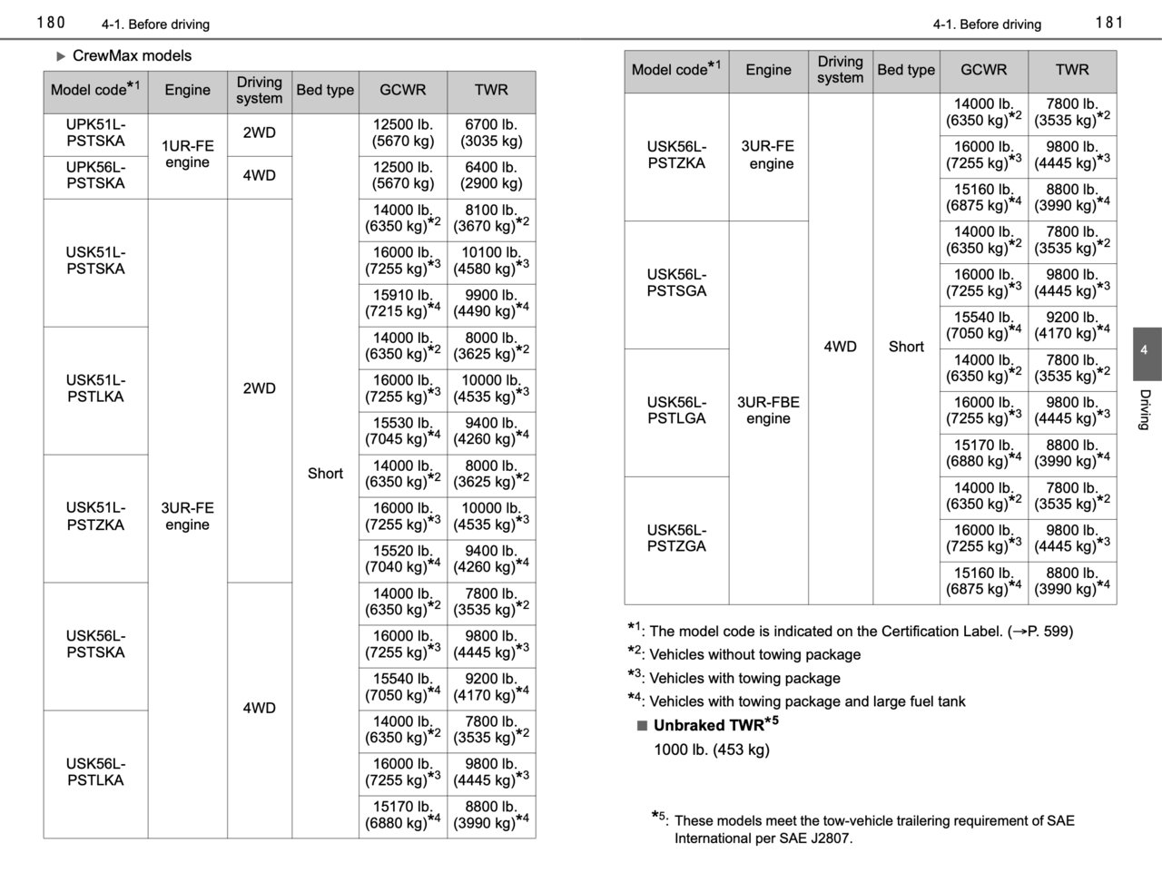

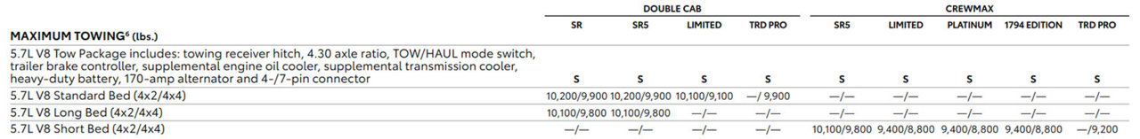

    I would not pull the load the OP is pulling in his truck. The following info is why.
    2019 Tundra info from Let’s Tow That:
    His tow rating is 9400 lb (4x2) or 8800 lb (4x4).
    Also, the 2019 Tundra owner’s manual shows what the max GCWR is for truck + trailer given the factory installed options on the truck. If you look at your door jamb, the 2nd sticker (not the one that shows your payload rating) will have a truck code that is given based on your options. Here are the GCWRs for Crewmaxes with their various codes in the 2019 manual:
    @FedExTrucker ’s Limited Crewmax definitely has the large fuel tank. Probably has the towing package. I’m guess it’s also 4x4. His GCWR is probably in the low- to mid- 15,000s. His trailer’s gross is 9,995 lb, and his truck’s gross is 7,000-7,200 lb. I’m guess it’s 7,200 lb because that’s what my Crewmax is as well.
    Not only are we at least 200 lb over on payload with a pin weight of 1500 lb before anyone or any gear goes into the truck, we’re also at least 1500 lb over our GCWR.
    I don’t lose any sleep being 200 or 500 lb over my truck’s GVWR, but pulling a trailer that puts me 800lb over payload and 1500 lb over GCWR is out of the question.
