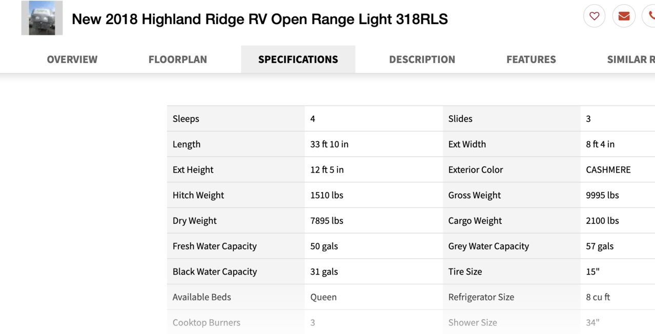

    This is an interesting chat. One can tell who has/hasn't towed with something better vs a maxed out truck.
    This is the trailer, and we know the truck:
    Pin weight is 1510 or 19%. In the event he even puts half of the cargo weight in of 1050 lbs, his pin weight will be 1700 lbs.
    Now we need to add the 158 lbs for his hitch. Now we are at 1857 lbs pin weight. Just a tad over....
    What does this all mean? Upgraded tires...check. Upgraded suspension...check. What's to worry? I may have missed it, but has anyone even talked about rear axle rating (which is 4150 lbs btw). So what do you think an empty Tundra will weigh on a scale with the rear axle on the scale? Wonder why the Tundra has a low payload rating with the 10.5" rear axle? Could it be due to strength? Things I ponder....
    The truck in question:
    2019 Tundra CM. From other posts on here, his payload is probably between 1200-1270 lbs. So he is over by almost 600 lbs before he even gets inside the vehicle. Only he knows his/whomever else is in the vehicle weight. We can just say 350 lbs will be inside the cab. Almost 1000 lbs over payload and only he will know how much over the rear axle.
    I always enjoy the story's of "back in the day" to validate what they are doing now. DOT/OSHA/SAE and other guidelines are written in blood. There is actually a reason because somewhere "back in the day" some dumbass hurt or killed themselves. It's just that simple. I have owned a 1985 GMC 1500 and there is no way in hell that truck would even compare to the current 3rd or 2nd gen Tundra (Hell, maybe even the 1st gen). I would love to see a production 1980's anything out perform its counterpart from today.

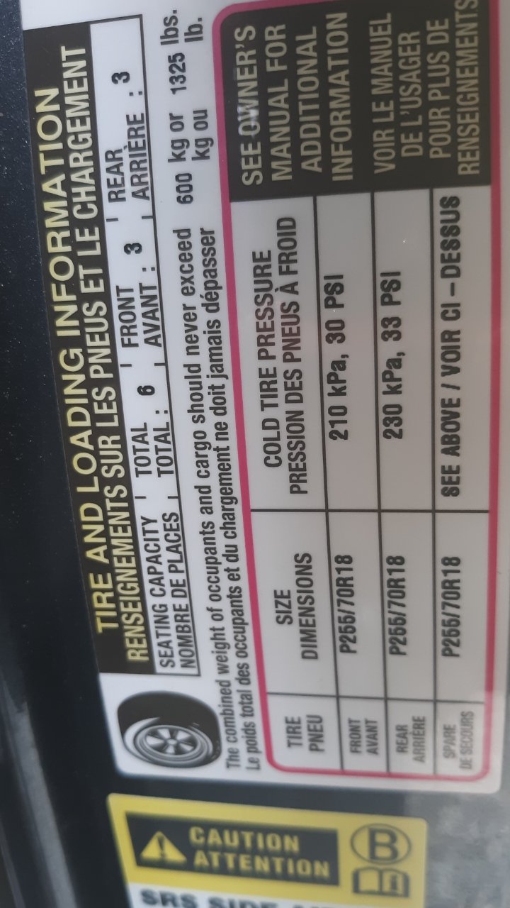

    My 2010 DC LB
    4.6 4x2 tow pkg
    1325 lbs
