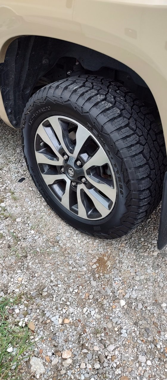

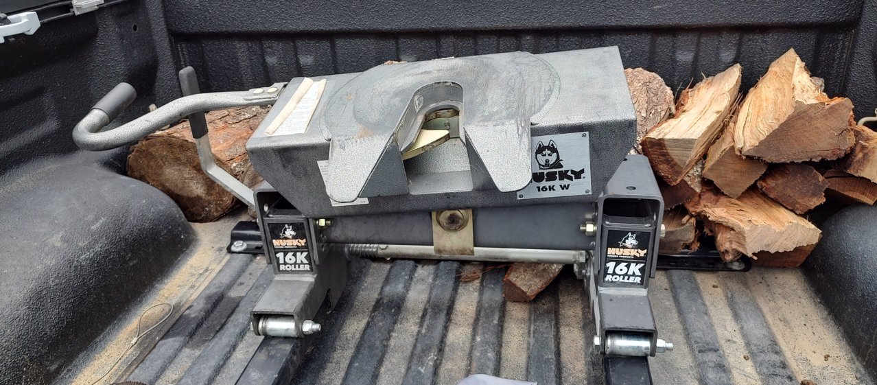

    Thurman
    19 Limited Crewmax
    Nokian Outpost AT
    Definitely appreciate the logic in your post. This is my hitch, it is not a troll... Lol

    19 Limited Crewmax
    Nokian Outpost AT
    Just got these 10 ply E rated tires... I like em a lot!
    D4x4TRD, koditten and Jernik like this.
