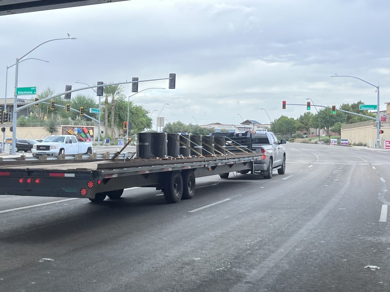

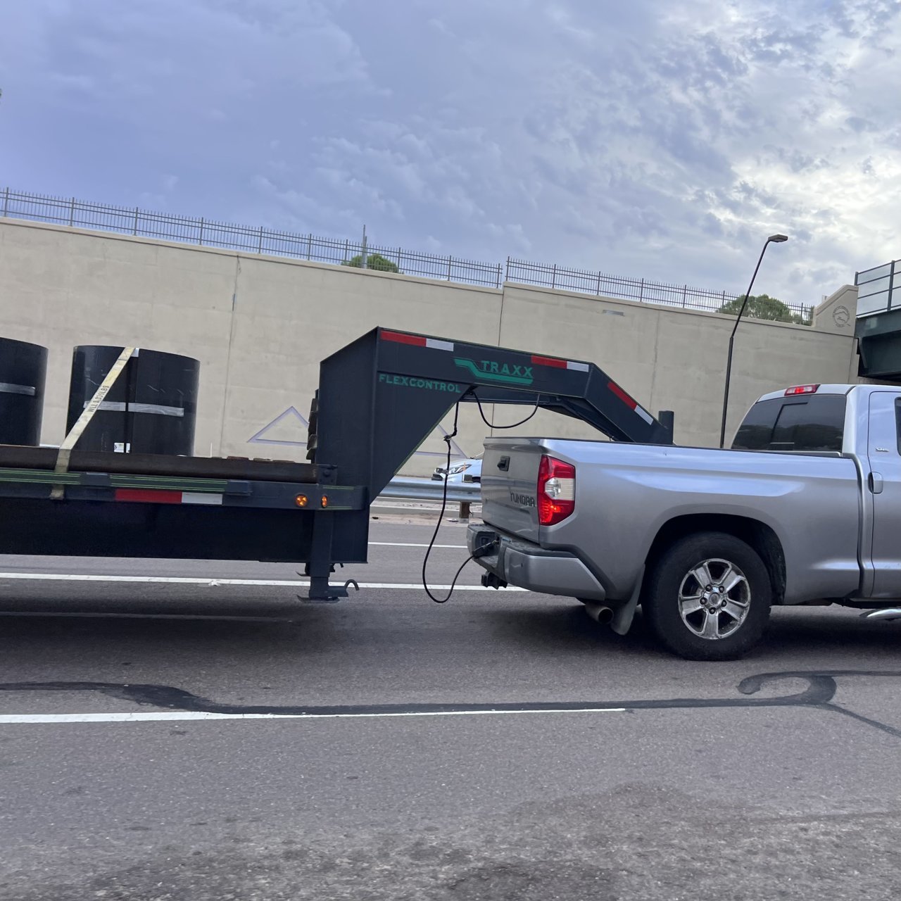

    :eek: Just spotted this, assume it was headed to the Darwin Award Gameso_O

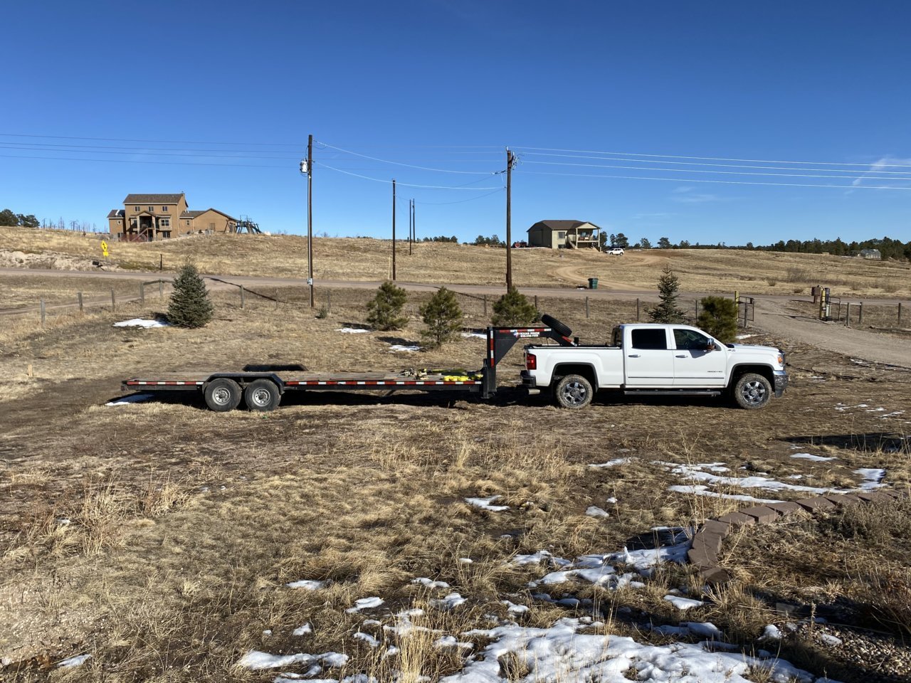

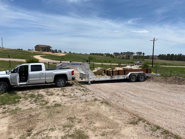

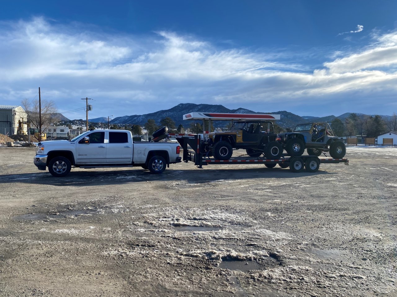

    What size trailer? This one is a lighter duty (still 12K lbs rating) and weighs in at 3040 lbs. Even if the pin weight is 22% it would be 668 lbs. The problem is when you load it up even 50% of its capacity.
    https://trailers2go4less.com/shop/c...trailers/currahee-82-x-18-gooseneck-trailers/
    This is 1040 lbs empty. 24' lowboy. 22.5% pin weight. In this picture pin weight is ~3500 lbs loaded due to the boulders position on the trailer.
    This one is a little less at 1020 lbs. 28' lowboy. This one also doesn't have chain boxes or hydraulic jacks like ^^^.

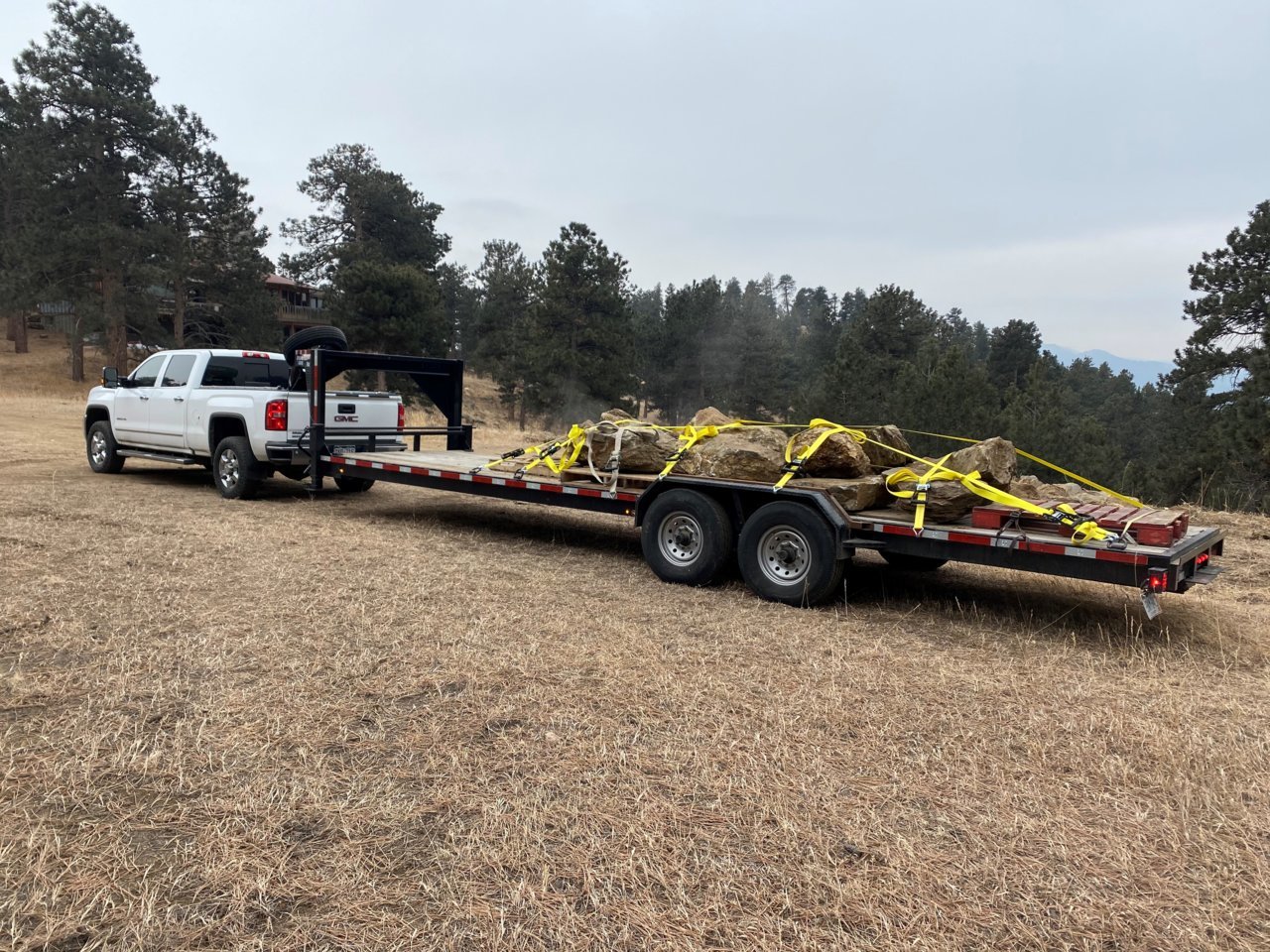

    In this picture, the rocks are heavy but due to having the longer deck and was able to position the boulders differently. Pin weight was ~2800-3000 lbs.
    This pic the pin weight was ~3400 lbs.
