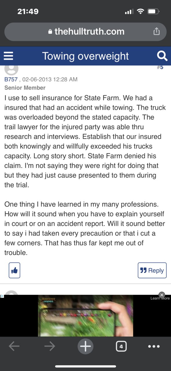

    Respectfully, I think you are wrong on both claims. First, people do make that claim on the internet all the time. "If you get into an accident while over the manufacturer's ratings, your insurance will deny your coverage." No, they won't. They can't. They can jack your premiums way up. But as long as it is accidental (torching your house to collect insurance money is willfully intentional/fraudulent), they have to pay it. Second, if you are negligent, they still have to pay. Almost all traffic accidents are due to negligence. They have to pay up to your limit of coverage. If you get shot robbing a bank, your health insurance has to pay your medical bills, as always, up to your limit of coverage.
    First link: "...it may well be illegal to overload your vehicle." This is lawyer speak. It tells us absolutely nothing definitive. I'M NOT SAYING to do whatever you want. Exercise prudence and caution. The context is Tundras pulling loads that are within some of their numbers but not others. Ex: If I pull a 7k trailer well under both my tow rating and GCWR yet 600lb over payload, I'm not being negligent, reckless, or imprudent. The truck handles it just fine.
    Second link: that's a different country on the other side of the world, the laws of which do not apply here.
    Third link: this is a forum thread from 2006. Read post #6. His insurance broker told him "you are going to be covered, but likely not renewed." To be fair, this falls under hearsay.
    Fourth link: Here's post #5 (@ColoradoTJ already quoted it):
    "I use to sell insurance for State Farm. We had a insured that had an accident while towing. The truck was overloaded beyond the stated capacity. The trail [sic] lawyer for the injured party was able thru research and interviews. Establish that our insured both knowingly and willfully exceeded his trucks capacity. Long story short. State Farm denied his claim. I'm not saying they were right for doing that but they had just cause presented to them during the trial."​
    Seems pretty incriminating, right? Like it's the smoking gun? Except the same guy backtracks it later in post #18:
    "I was not privileged to all the court proceeding but the insured was denied coverage. Maybe I am speaking out of turn by even trying to relate this case with what the OP original question was. There obviously are some details missing and the case was complex. Thus the reason it went to trial. I probably shouldn't have brought it up since I did not know all the details. I just thought it was interesting that no money was ever paid out on this claim."​
    All he knows is they didn't pay the claim. He completely made up the connection to the thread topic. Thus, this fourth link falls under internet hearsay as well.

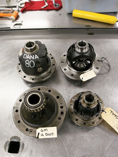

    Taken from Tundra.net Our rear ends are closer to 3/4 ton. Dealer tech told me the same thing when I bought the Tundra. This was one reason I bought it.
    Looks like a Ford 10.25" rear end. It's probably equivalent to a Dana 70 or a GM 14 bolt, just like the Tundra's rear end.
    Here's a picture with the Tundra rear end. Gen 1 is bottom right, gen 2 is top right.
    And in case anyone wanted to know, our rear axle is 1.457" diameter and is a 36 spline shaft
