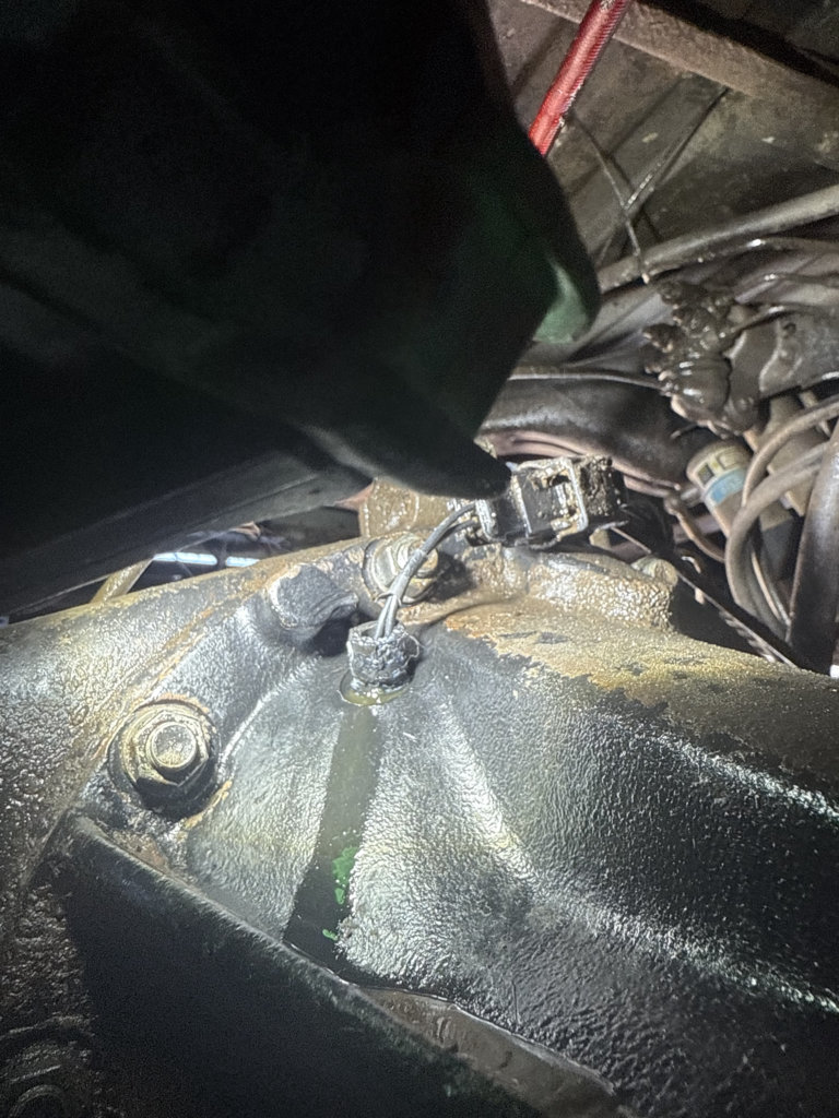

    Maybe. But it's been slinging oil every where for about 300+ miles and I can't stress enough it's a 20hr drive. Did you see all the oil on my driveway? The underside of the truck is coated and dripping

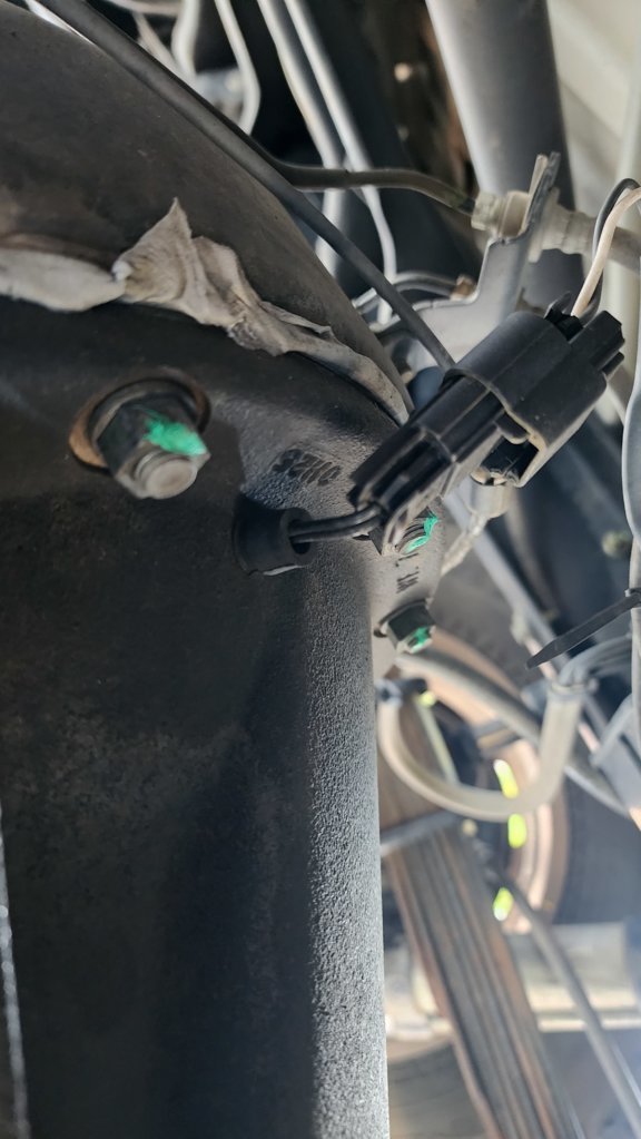

    Is that a rubber grommet just pressed in or is it threaded?
    Tunrod likes this.

    Pressed, clean it and glob some fipg in that hole. When I installed mine I put sealant all around that grommet, mainly to prevent the wires from pulling in or out

    In that case, just disconnect the wires and seal like @FrenchToasty said, easy temporary fix.

    Also this. You could just stick two ear plugs around the wires and be good to go

    Not sure. I didn't install the e-locker myself and never looked that hard at it. I just turn it on and off :anonymous:

    Juan believes that's what happened, the wires got tugged

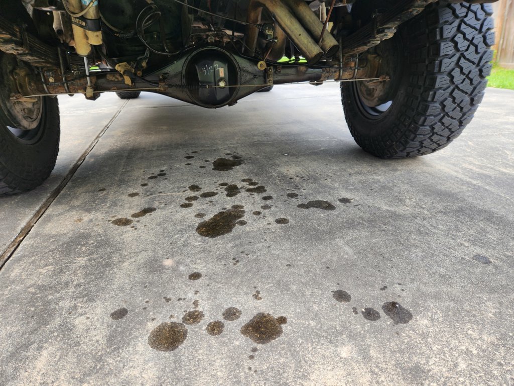

    Yes. Casey pointed it out the last time I went to his house. We topped it off. I took a pic and sent it to Juan at Toy Lex, but he said it looks like a brake leak. Then I totally forgot about it, because the truck has berely moved the last two years and were been addressing so many issues the last 7 months.
    This was the leak in October.
    Vs on 4/20
