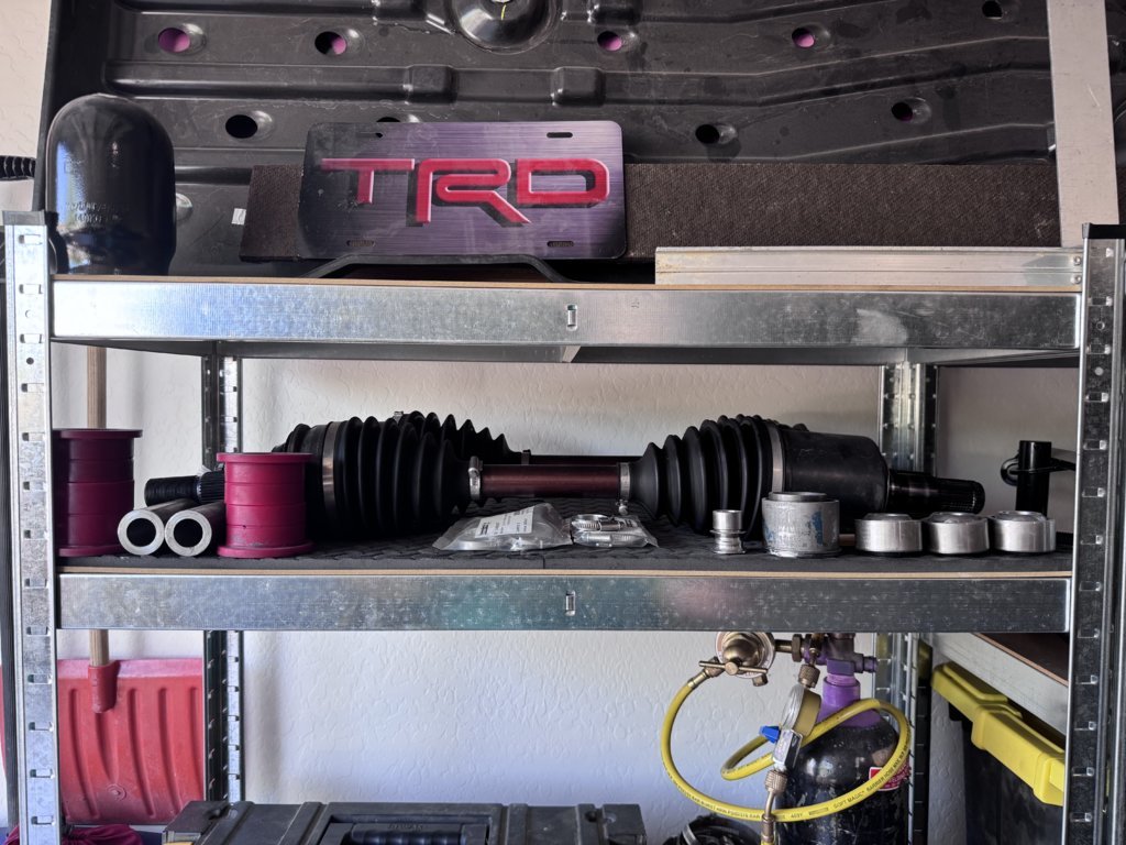

    My to-do list/pile of parts…
    - Rebuild/revalve shocks and rebuild bumps
    - Finish 12 point bolts on suspension
    - Install shorty headers
    - Power steering rack and bushings
    - CV boots
    - Replace spring perches, u bolts, center pins, and friction pads
    My RCVs are trail spares/paper weights now.:rofl:

    Why are the RCVs spares now... Anything wrong with them?

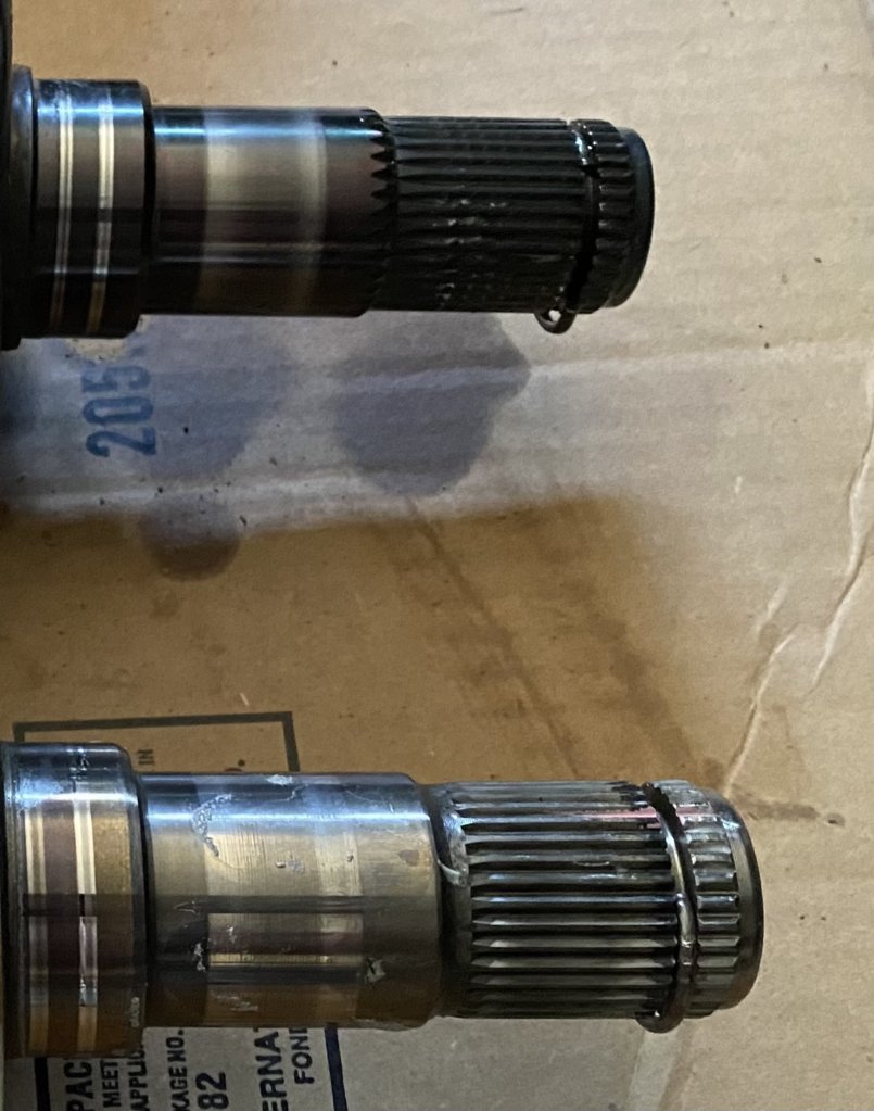

    I ran into 2 issues, no reason to not give them a try though. Seems like a lot of people remove and sell them…
    1 - Inner boot rubs the bump stops, was able to modify the stock ones and adjust boot placement to clear, but no fixing with bigger aftermarket bumps. Pic is where they contacted Durobumps.
    2 - How the splines that go in the front differential are cut, no fix for this. The splines on the RCVs taper instead of having a full stop like oem,and after that got shoved in towards the differential enough times it would get stuck slightly off center and damages the CV joint. Additionally the driver side would smack the center pin of the differential carrier and make an awful noise, probably not good for the differential. Pic shows spline differences - top RCV, bottom oem.

    Interesting... I was under the impression they were better than OEM... perhaps I will wait until/if I break the OEMs to use the RCVs.

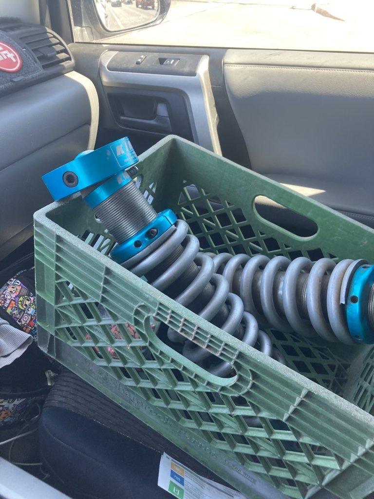

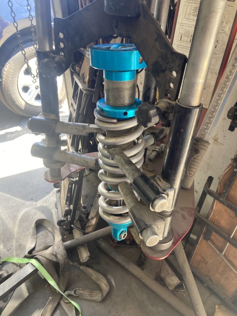

    even with a bench mount spring compressor it wasn’t ideal to adjust the preload collar. Off to alignment she goes!

    Really? I adjusted mine on the truck and it was easy. Of course they were new. Ymmv :)

    Yeah i tried every which way but loose, and couldn’t do anything. Day late, dollar short: dude at work has the spanner I needed

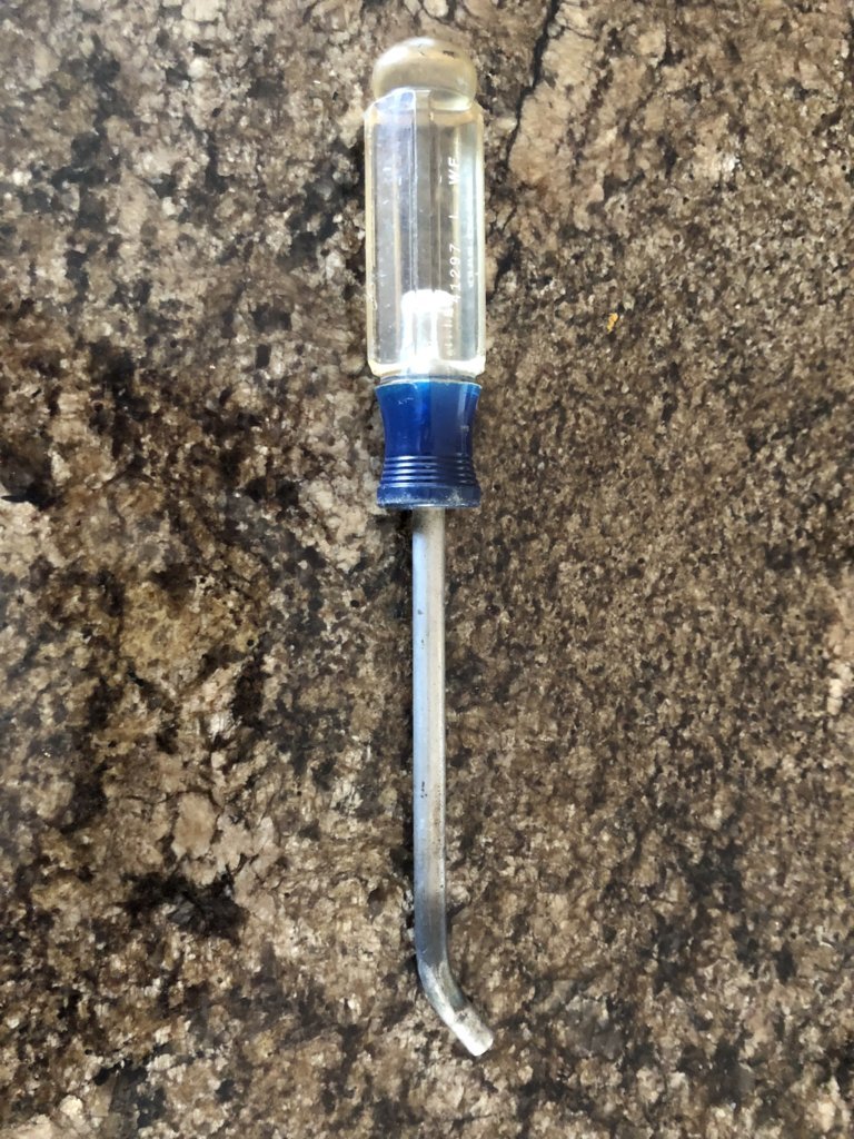

    I haven’t used a spanner wrench in years… :anonymous:
    9/16” punch FTW. I think it’s 9/16” anyway.

    I’ve heard 5/16 but 13/32 was the sweet spot

    This works better than any of the spanners I have
