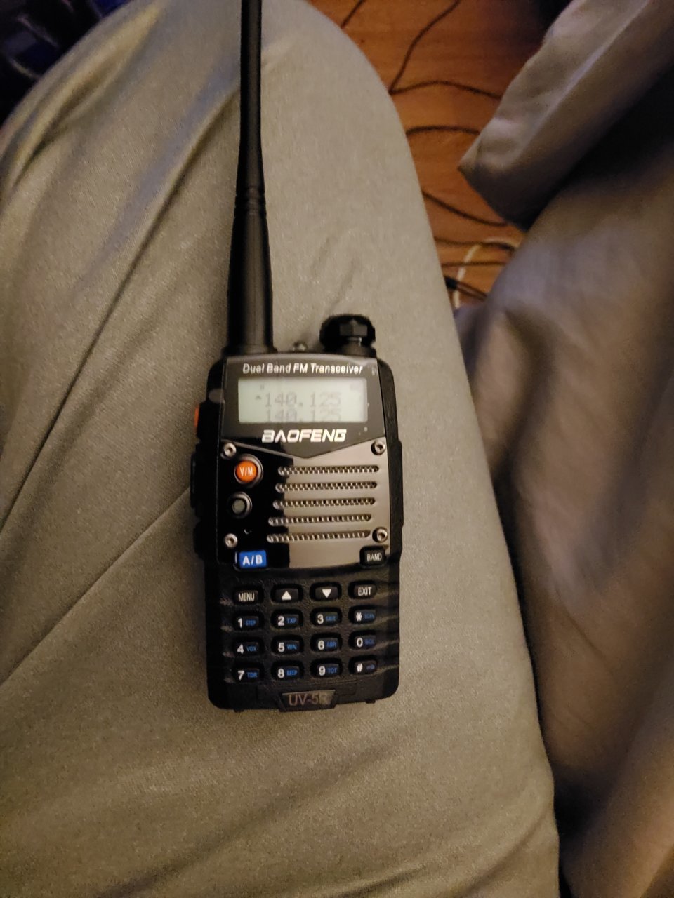

    make sure the baofeng isn’t programmed with a privacy tone…

    jist throwing this out there, but if it’s a dual frequency radio, make sure your pressing the correct transmit button.

    How do we do that? We're literal radio noobs. If it's not walkie talkie simple we're fucked.

    what model is your baofeng?

    Hit menu key…
    use arrows until you see R-DCS make sure that says off and R-DCE says off…

    Done. Still the same.

    What is model of radiodiddty?

    well found your problem….gm-30 is a gmrs radio and can only transmit on GMRS bands but can “listen” on whatever you key in….
    462.500 on the Baofeng and then ch 19 on gmrs

    Thank you sir. That will work.
