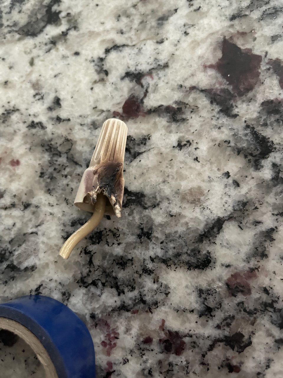

    Yep, there’s the problem. You have a cut wire…:p

    Nice find, was that on your transformer?

    Change the thread name from burnt orange to burnt wire
  8. Jan 1, 2023 at 2:53 PM
    164,163
    Guess a wire must have came out of the wirenut at some point last night / early morning. Glad it was just a process of cutting them off, new wire nut and electrical tape so it doesn’t happen again

    Guessing when the house was built (end of 2017) contractor got lazy

    Sorry I missed this bud. It was in the furnace, inside the junction box

    Lesson learned…check builders work when you can. I phoned my neighbor / friend who owns his own HVAC company. He came over and showed me things I didn’t know, and did maintenance (preventive) on it and refused to charge me. Of course, I tipped him out as it would be the fraction of a cost for a service call + labor.

    Good to add the electrical tape on the wire nuts. That has been on my handyman construction techniques list for a number of years now. For a while years ago, I would actually get my 100/150 watt soldering iron and do it, and then add electrical tape.
  18. Jan 1, 2023 at 4:59 PM
    164,163
    I’ve done several electrical jobs at home, but now I’ll always add it after securing the wires
