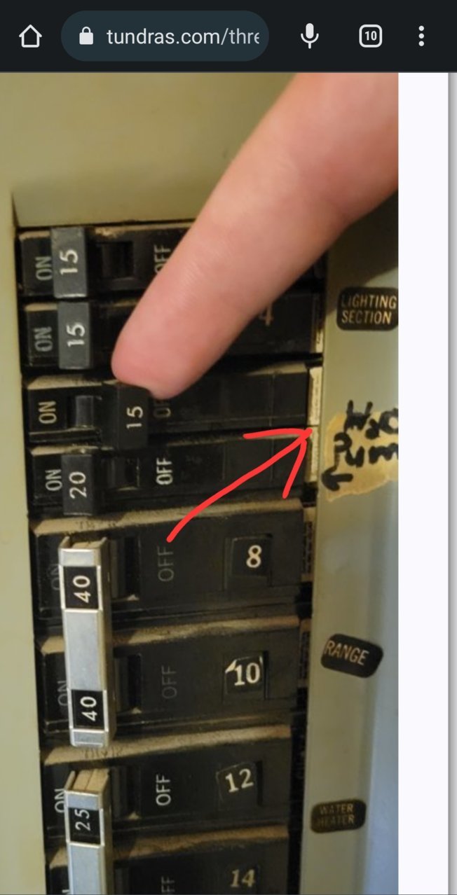

    @GODZILLA If kicking, or punching as @RichterScale suggested doesn't work, try spraying the panel with a garden hose. The water lubricates the electricity and makes it flow more bertterer.

    We had to change out a sub panel breaker at raiders reef on a live panel, but we made sure to double check the dressing rooms for other breakers/issues.

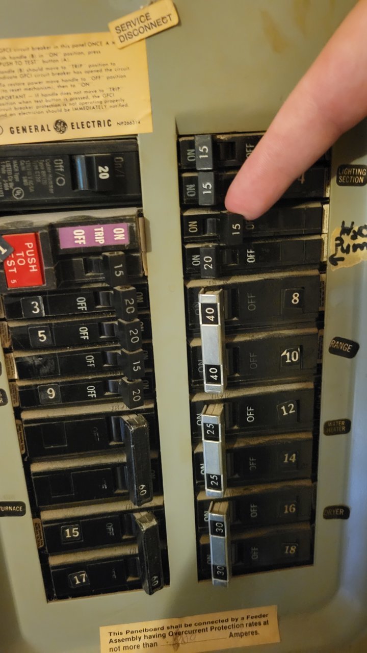

    You can just flip the outside main off then everything in the panel will be dead. No need to shut inside breakers off

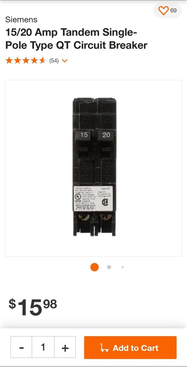

    When you have the power killed, pull the cover off and you should see a breaker type, it actually looks like a "twin" breaker to me. Might be this one.

    Could also swap with a double from the other side to confirm it’s the breaker at fault…….

    When you try to flip the breaker back on, are you flipping it all the way over to the off position and then flipping it back on? When you do, is it staying on for half a second and then tripping back to the center position? Is it just springy and won't click to the on position? Or is it stuck in the middle and won't budge?
    And did you try unplugging everything and turning off all the light switches that are on that circuit and then resetting the breaker?
    The breaker likely took a shit, but always start with the simple shit process of elimination.
