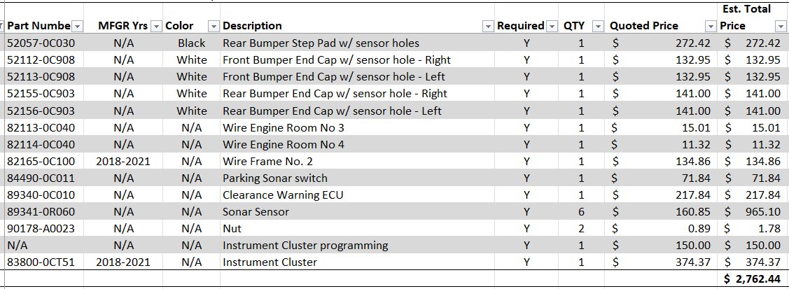

    Nope.
    Pretty much not a possibility to pull from the '08 and install on the '21. All of the connectors and wiring are different between them for that system.
    To do the Sonar with all factory parts (I've not had good luck not using factory for the sonar sensors) AND using new factory bumper parts (with the holes in them), this is your cost, plus the cost to get the bumper corners painted. Also have to add in some $$$ for wiring terminals, wire loom, wire, and some connectors...so probably closer to $2850.

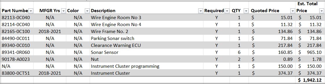

    To skip the bumper parts and just drill out your current bumper, you can bring that down to this (again, plus about $50-70 for some connectors, terminals, wire, and loom)
