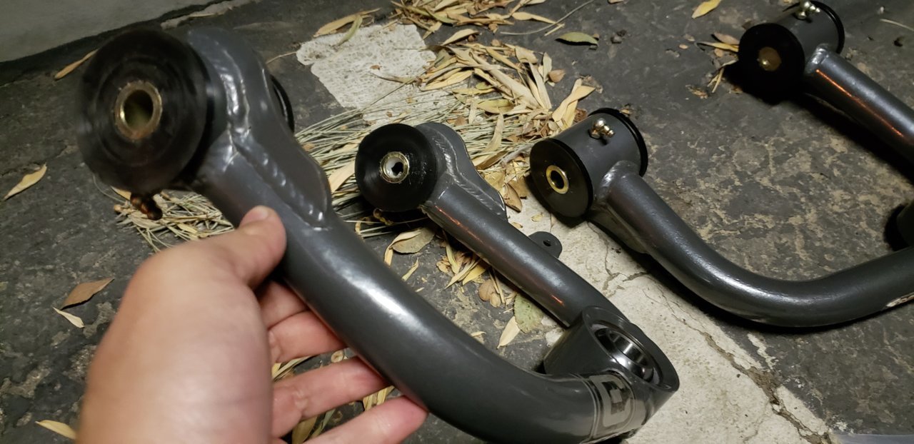

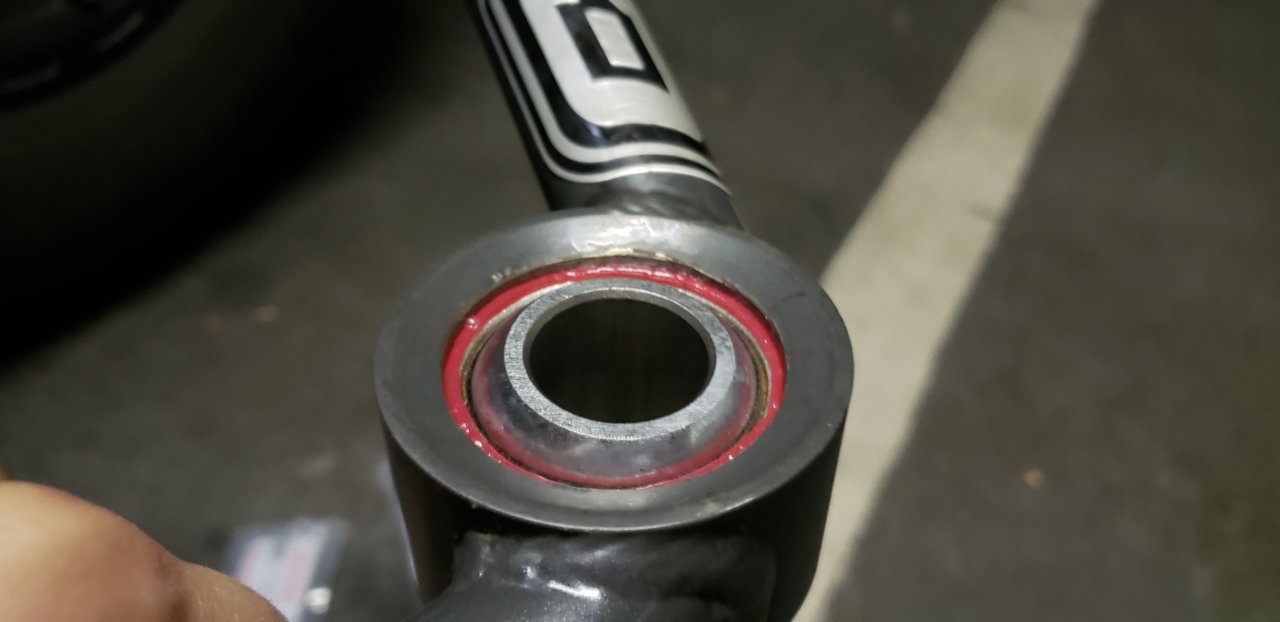

    ah. I see you got the bigger fk balls. Did you need a special socket to pop em out?

    Good eye. Yeah these are FK. They might be better than the original balls I had but I can see the liner in the race. I think I used a 1 7/16ths socket to pop out the old and pop in the new, it fit perfectly.

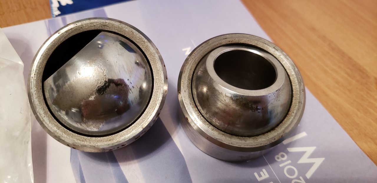

    I'm not 100% sure but I think my arms came with Aurora balls originally. They had developed some play, after pulling them and examining I noticed some visible scars on the surface. Probably not enough to prevent movement but might have contributed to wear inside the race. Interesting thing is they're only worn in the direction of the pivot action, if I turn them 90 degrees the rotation is more firm.
