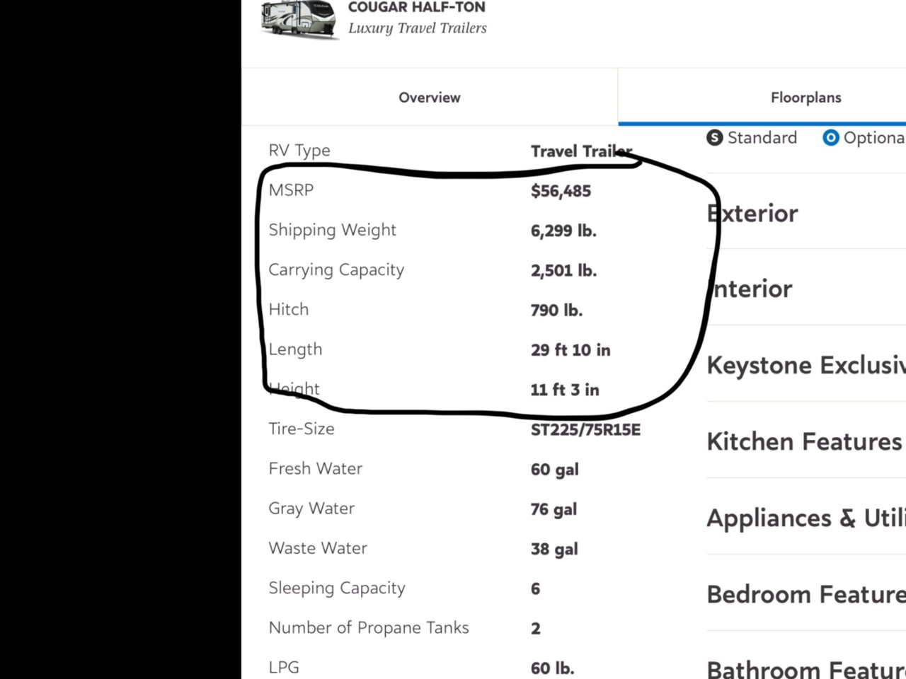

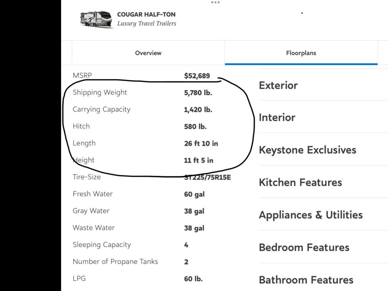

    It’s exactly because of the hitch weight that I have narrowed my choices way down due to payload considerations. My wife and I and dogs are all we’d load into the truck (so maybe 500lbs at the most there) which leaves me approx 700lbs to play with between the hitch weight and wdh weight. PAYLOAD: That’s the big major limiting factor on our trucks as I think honestly they could handle a lot more but to be standing on good moral (and legal) ground I’m trying to keep it at or under the payload for sure. Thanks for your reply,

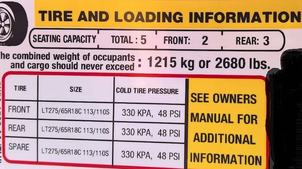

    Here ya' go since you asked...

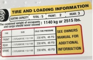

    Or how about a 2019 XLT 4X4 SuperCrew 6.5 box HDPP max tow?

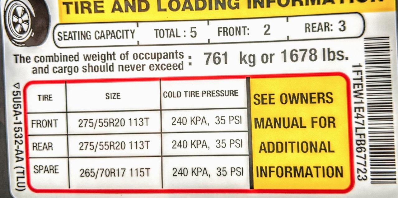

    Or how about just an every-day 2020 F-150 SuperCrew Lariat with moonroof and the max tow package?

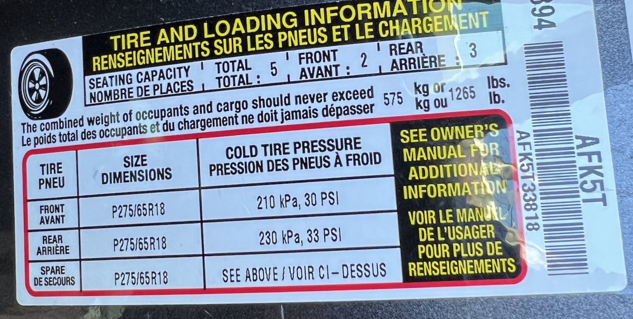

    Now, let's see how that compares to my 2019 Tundra 4x4 CC SR-5 with it's "vaunted" tow package that doesn't even include a transmission cooler (and have to take 102 pounds from that due to port installed "extras").
    See, other manufacturers DO have options, and those options exceed the capability of the Tundra. Now, I can also go grab you stickers for other manufacturers that are lower... but usually those are also a more loaded truck than my SR5 is.

    Yes, only the mythical HDPP equipped Ford will boast your 2300# plus claims. Most half ton crew cabs will run between 1200# and 1800# depending on equipment.

    You asked for door stickers with those numbers... and they were provided to you. Remind us... isn't the HDPP a 1/2 ton truck? Since they ARE on the road, and ARE available for purchase AND purchased by drivers, they are not mythical. The fact that you may have to "order" one is not really anything out of the ordinary... people walk onto a dealership lot and not like what they have they either have to special order it OR have the dealer search for existing inventory. We had to do that with our Camry. We wanted a specific color that they dealer didn't have... and they couldn't "work a trade" with another dealer for it so they had to wait until they could get one in on ALLOCATION..and since most Toyota dealers apparently don't do "custom orders" (they have to wait on allocation according to the dealers we talked to when looking for the Camry) it took a while to get in.
    Mythical is the claim that Tundra is exceptional.... I even showed you a simple "tow package" equipped Ford SuperCrew WITH a moonroof that the payload was several HUNDRED pounds more than the SR5 CC (with the "tow package") of mine with the standard SR5 load-out. The fact is that Toyota has been sucking hind teat in many aspects of real payload capability for a while. Toyota simply stood on their laurels and failed to make any major improvements to the Tundra until the 2022 model... and some of the things they did I don't consider "improvements".... the engine being one. Was it a surprise to anyone when they started having turbo issues when it was released?
