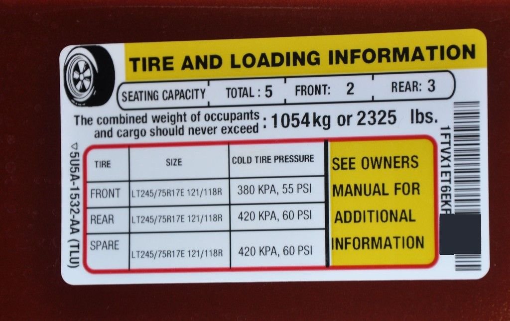

    From the F150 forum for a 2018 XLT HDPP crew cab 2x4:

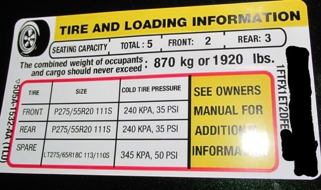

    Another guys 2013 XLT Supercab 8' bed 4x4 HDPP:

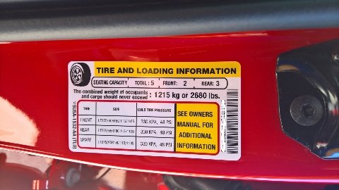

    A 2013 XLT Supercab 6.5' 4x4 non-HDPP:
    And I have personally looked at a 2015 or 2016 F150 3.5 ecoboost supercrew 4x4 XL STX package that had 2100 lbs on a dealer lot.

    HDPP should almost be it’s own line of trucks as the frame isn’t even the same as the regular F150.

    actually, my 2014 is on the HDPP frame. Just not the HDPP axle or springs. And they are not as rare as you think. I've already seen a bunch of 2021+ HDPP F150's running around locally. People do order them.
    My F150 is probably one of the heaviest around and still has a respectable 1560 lbs of payload verified by the cat scale. 2014, supercrew, 6.5' bed, 4x4, Lariat with virtually every option available and the max tow package. It scales at 6140 lbs empty.

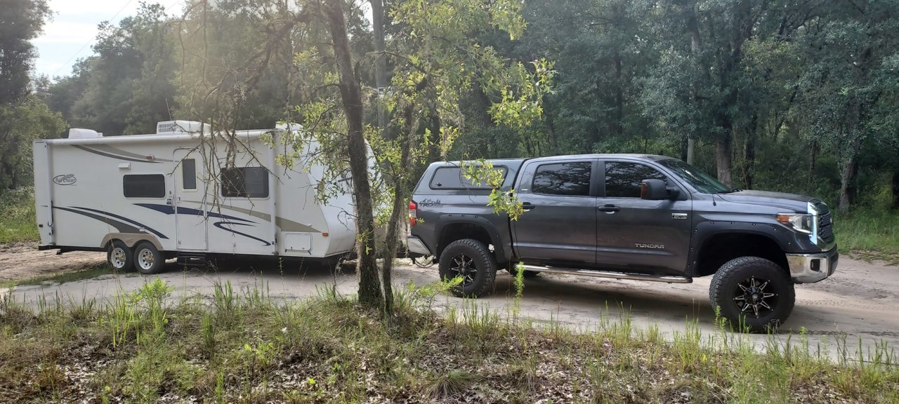

    7inch bds on 35s
    7 in lift 35 inch tires 26 foot camper and tow with out issues.
