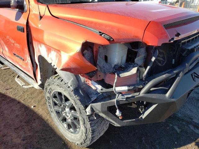

    1. The bumper really took most of the hit on impact. It doesn't look like the crush points are bent at all. Here is the crush point right behind where the bumper attaches on the impacted side.
    Here is a front view of the impacted side

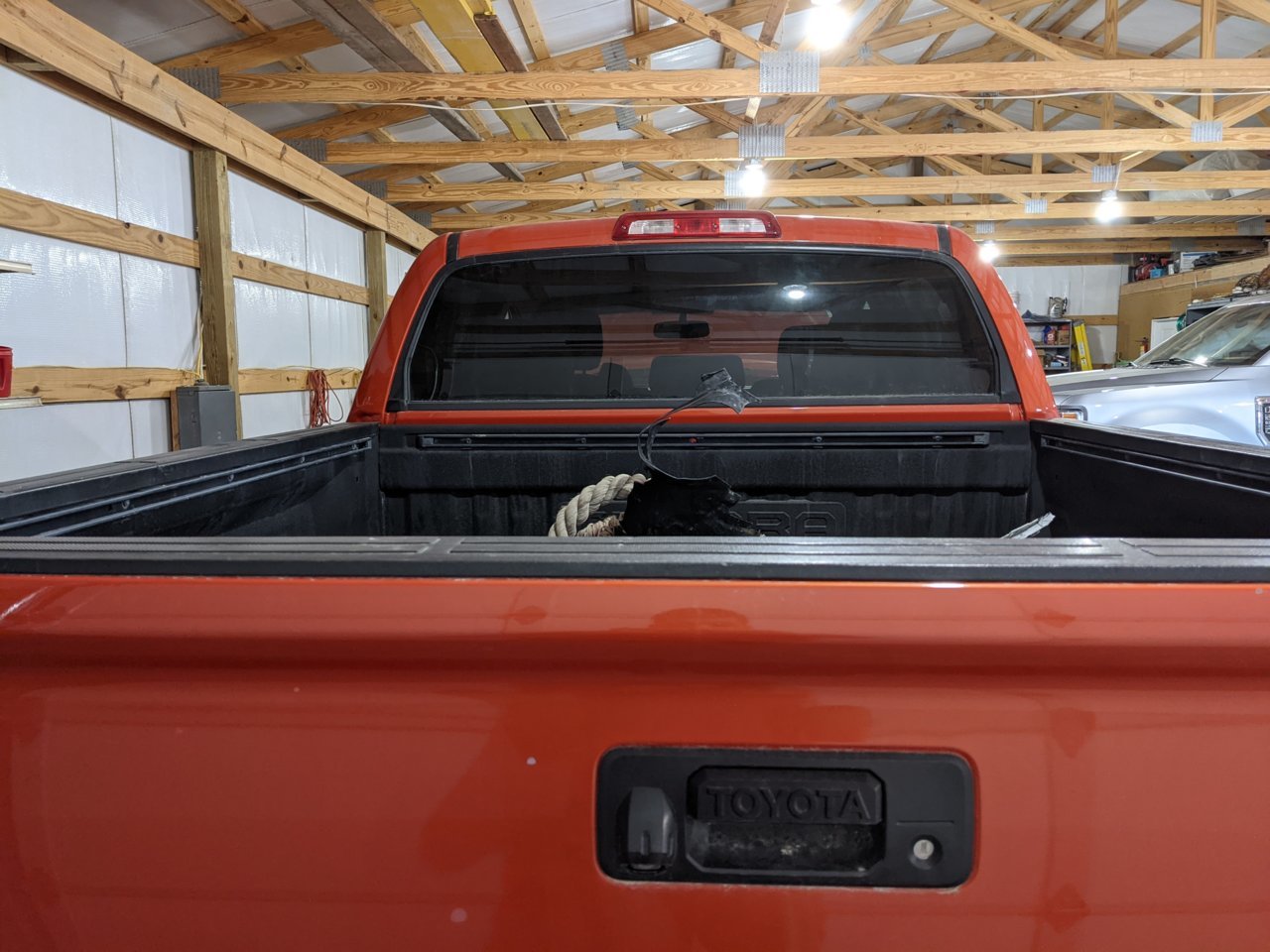

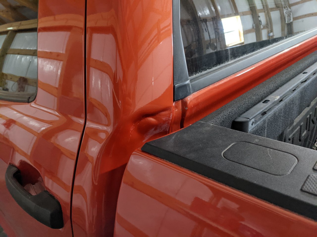

    2. The impact on the front passenger side was hard enough that the driver's side of the truck bed punched the cab. The frame guy that looked at it didn't think it would be an issue.
    You can tell that the bed it slightly slanted as it sits now.

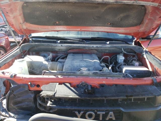

    3. The transfer case looks like it leaks
    4. The oil was almost not on the dipstick and it was super dirty, almost sludgy

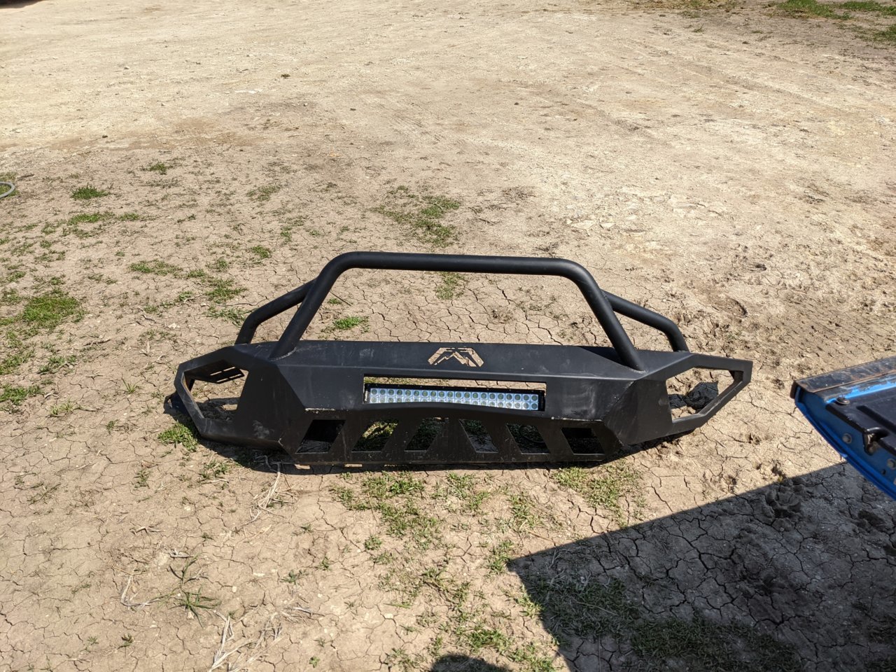

    7. My dad is good with metal and welding, he thinks he can fix the bumper and get the twist out of it. We'll see how that goes

    Also let me see that guarage, its looks like a very big guarage.

    With what that pic shows I would definitely be checking out the rear diff. Hopefully he put a diff breather kit on it before he took it swimming.

    Yeah, I thought about that.. I would be shocked if this guy took the time to do a breather kit tbh. I'll be flushing it out

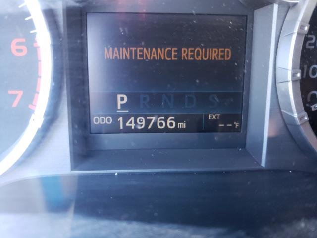

    I have to say the “Maintenance Required” message picture made me laugh.

    It's actually my buddy's garage. He buys fixes and sells salvage Fords so he's got a big garage haha

    Heyyy nice fine! I decided to either fix the heavy-duty bumper That it has, or buy a new one. There's a lot of deer around here so I'd rather play it safe
