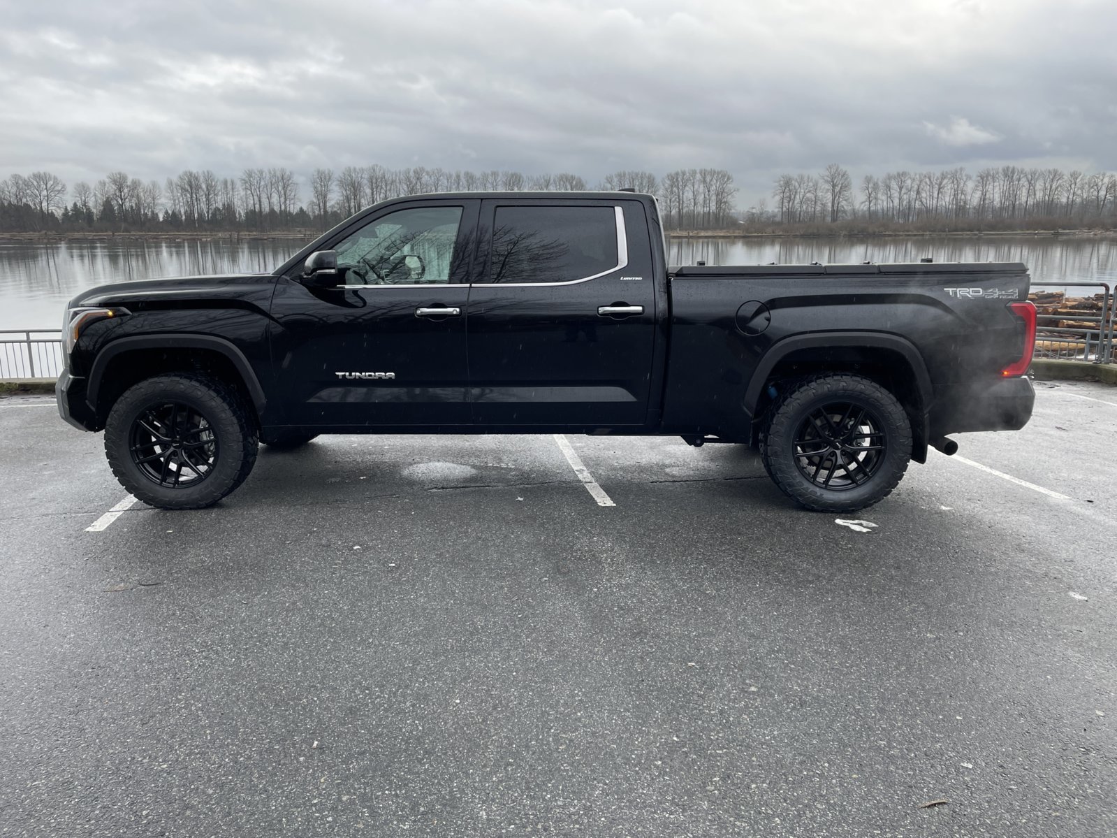

    That looks nice! What tires are those?
  2. Dec 7, 2023 at 11:22 AM
    #62
    Feartomorrow
    Feartomorrow New Member
    Nov 7, 2023
    #106536
    15
    2024 Limited OR
    Thanks! Kenda Klever 35’s

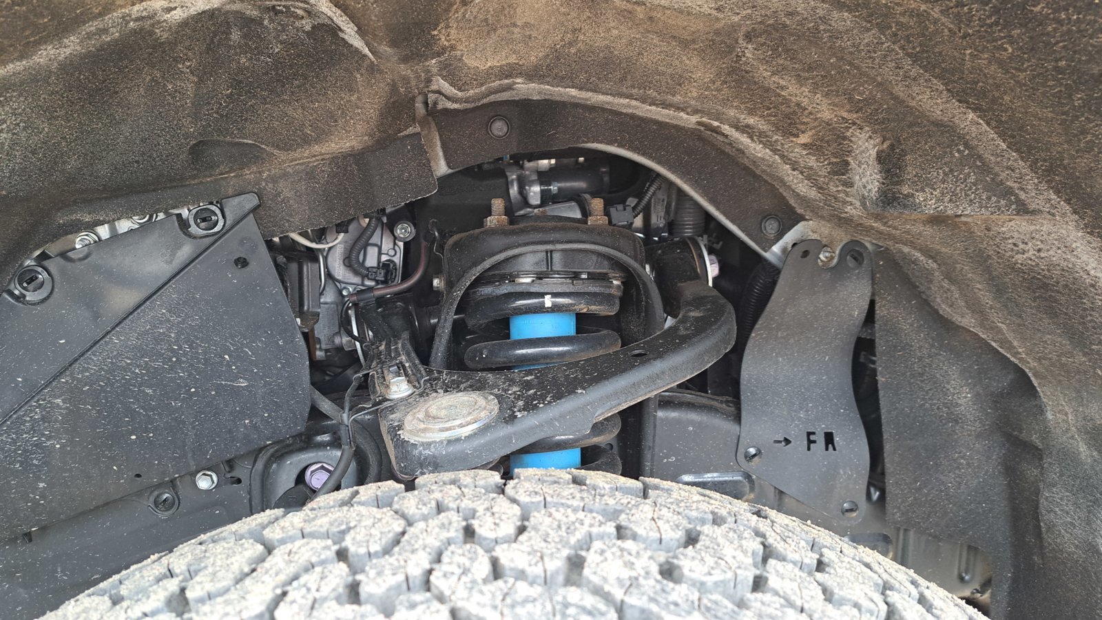

    I just did a 2" Dobinson IMS coilover in front and 1" ims with springs in the back. Also put 18x9 rims and 295/70/18 Toyo at3's. Ride is stiffer but better. Stock ride was too "soft and squishy for me. I love the Dobinson ride.

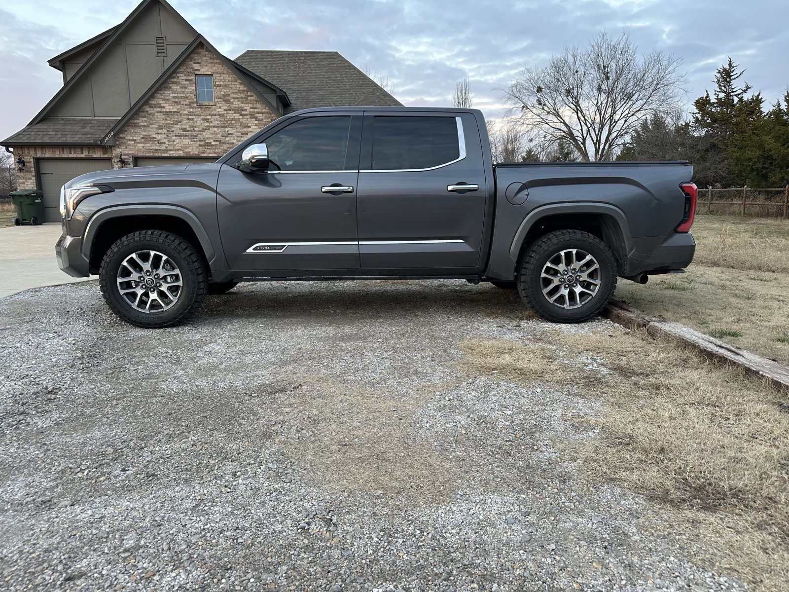

    ReadyLift 2” Mickey Thompson 275/65/r20
    Hmm. I’m not seeing the higher front with my ReadyLift 2” kit. Maybe I should measure. And as far a ride quality, I think it’s awesome and equal to or better than stock. My perception though. I just spent 6 years in a rough as hell Chevy so anything is better than that.

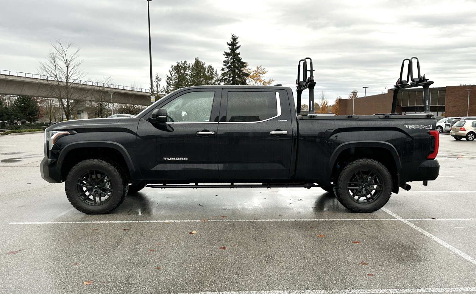

    Nice looking truck. What size tire is that?

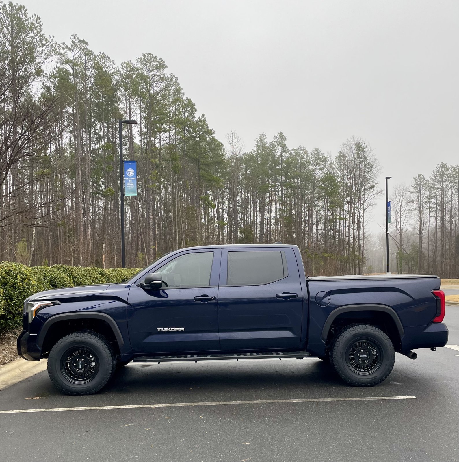

    I went with a 1.5in front level as I wanted to keep a little bit of rake. Back sits around 3/8in higher when empty (had 3-400lbs in it the other day, measured & front/back were dead level). I found this video very helpful when deciding on which kit I wanted: https://www.youtube.com/watch?v=0L3bMDRVSx4

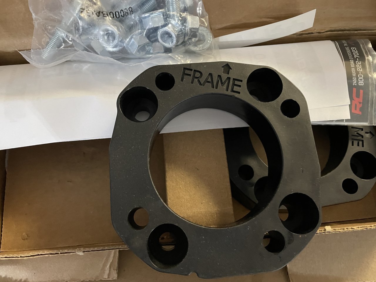

    Can anyone tell just by looking at this picture what type/size spacer was used for this front end lift. Took a picture of the same truck as mine in a parking lot today and I waited a bit for the owner to show up but it was taking too long.
  23. Feb 27, 2024 at 10:12 AM
    #83
    memario1214
    memario1214 Hotshot Offroad Staff Member Vendor
    Dec 13, 2015
    #2252
    12,757
    Colton
    Missoula, MT
    '21 Limited MGM CrewMax
    If I had to guess I would say 1" spacer providing approx 2" of lift.

    That looks like the RC 1.75" The holes are offset from each other and it is made of black plastic/poly material. Some other ones are made of machined aluminum but this looks to be the plastic version.
    These are the same as the ones I have.

    You can see the bag of plated hardware that rusts in no time :) The 1.75 is plastic of some sort.
