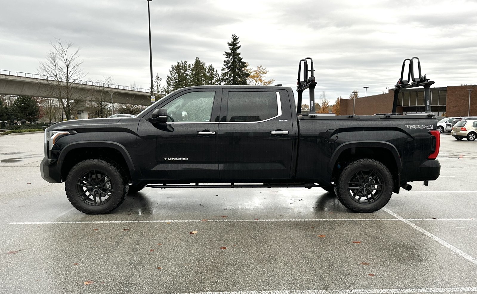

    TakiEvo
    TakiEvo New Member
    Dec 28, 2021
    #72363
    660
    Allentown, PA
    2022 SR5 TRD Sport Crewmax White
    Westcott front only preload collar with Toyo 35’s.

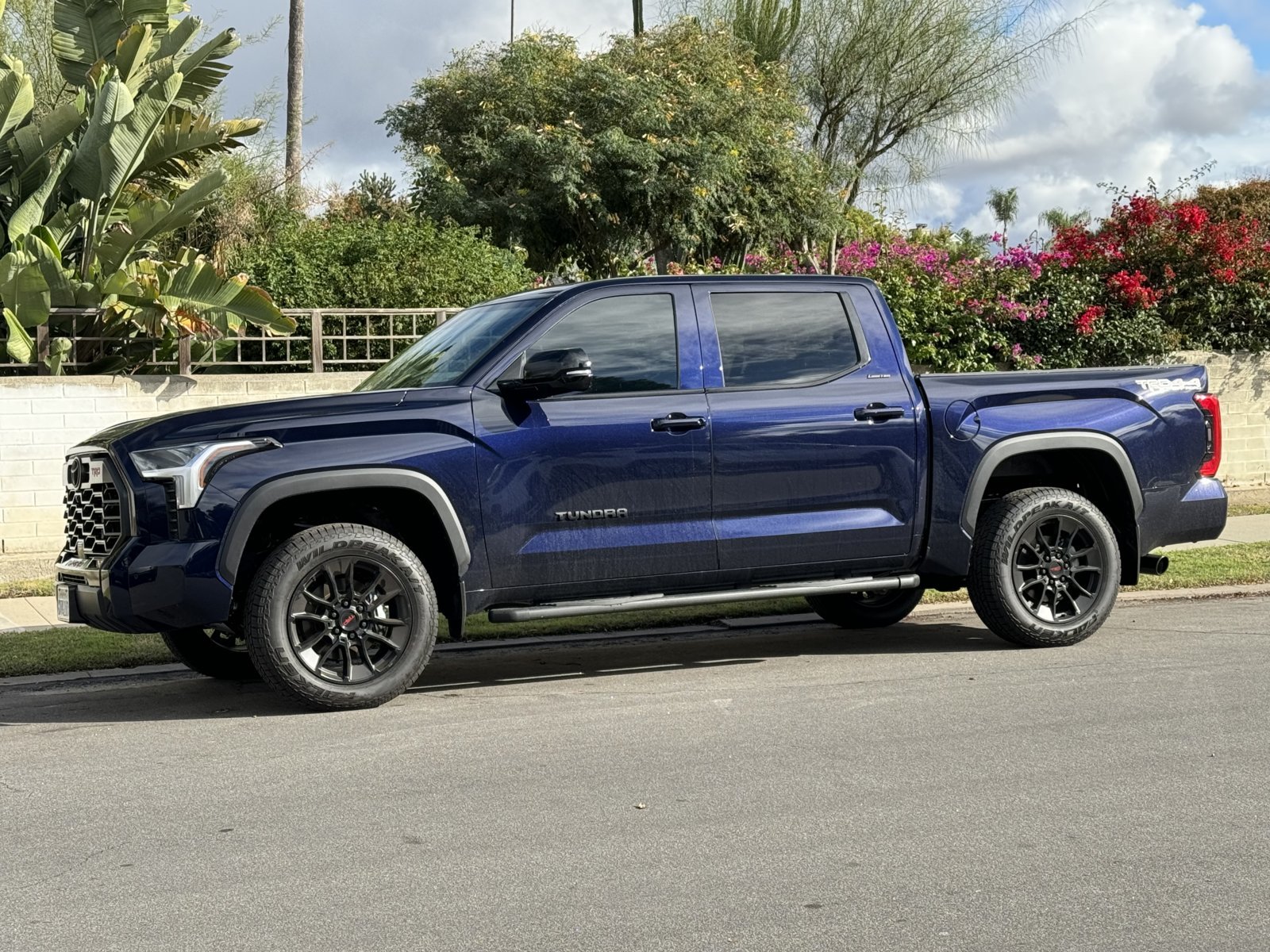

    socaldad
    socaldad New Member
    Oct 11, 2022
    #84773
    54
    23 SR5 crewmax TRD-sport
    Just installed rough country M1 adj strut at 1.75” with 275/65/20. Slightly front high by .5”, hoping it settles in the few weeks.

  4. Nov 15, 2023 at 3:08 PM
    #34

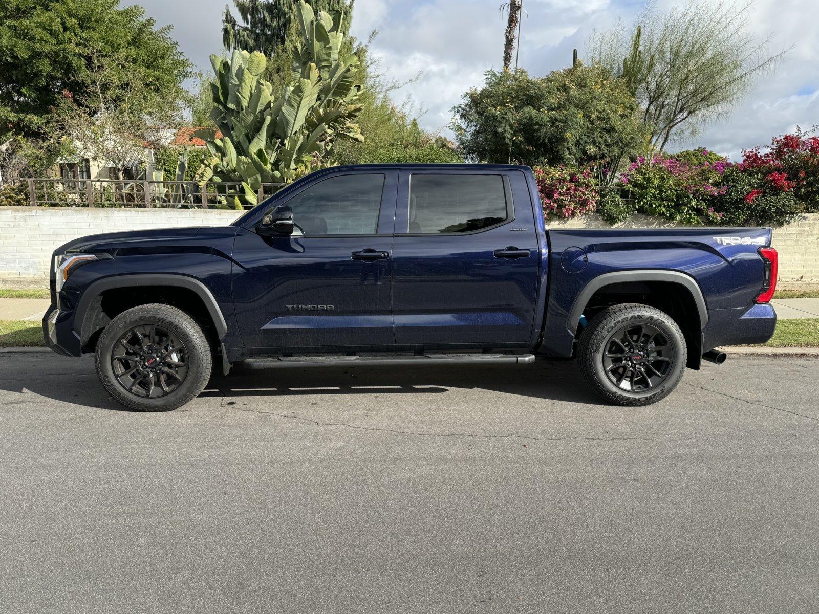

    socaldad
    socaldad New Member
    Oct 11, 2022
    #84773
    54
    Yeah I measure before and front were 36” and now it is 40”. The lift is supposed to be 1.75” and tires is about 1.6” higher, so the difference should be 3.35”. I’m hoping it settles down by .65” which would make it more leveled.
    i ended up having shop install it because it was so cheap, they charged $250 for installation and alignment
    The ride home felt good.

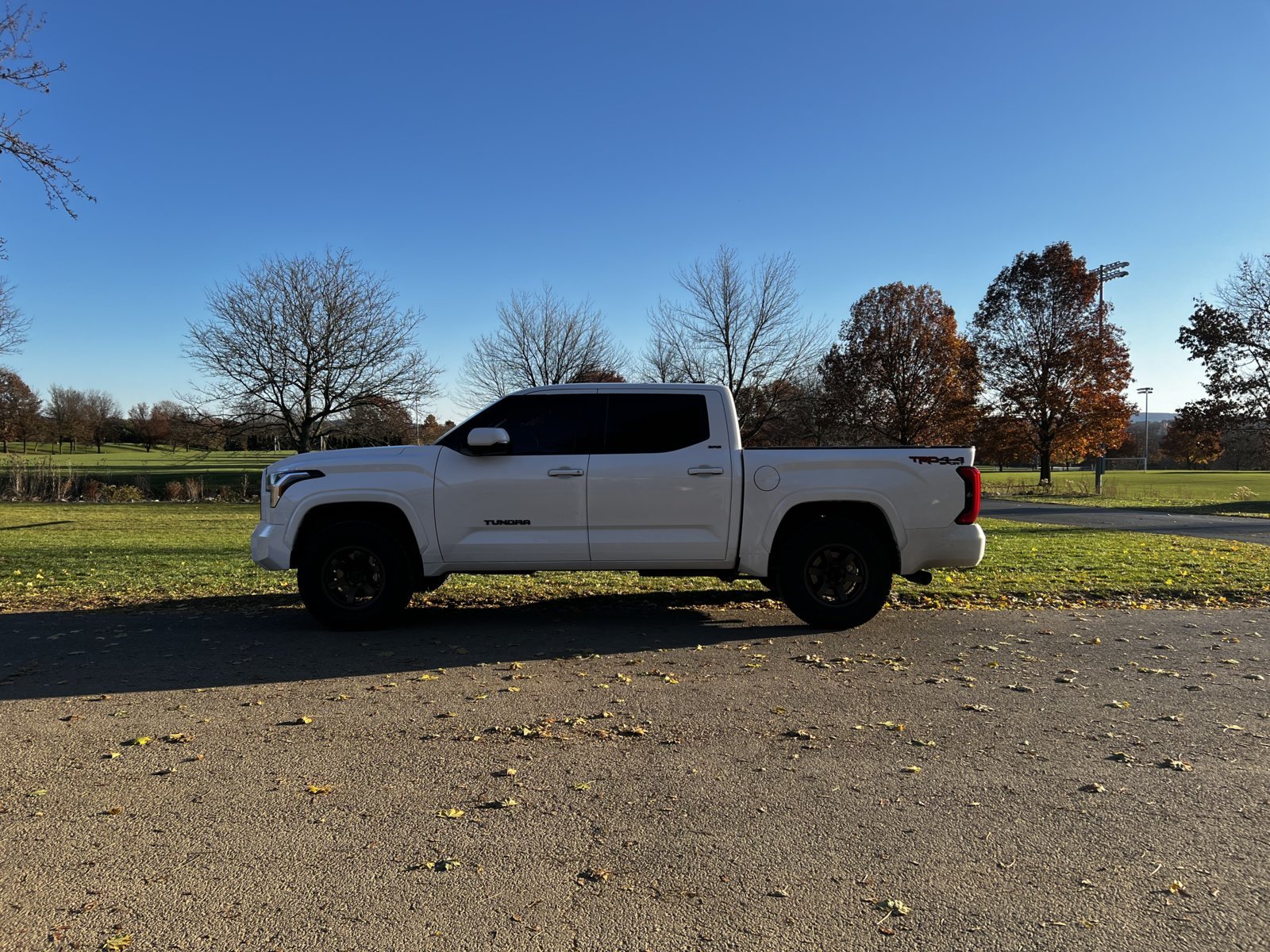

    my mall crawler on the RC 1.75. the front is slightly higher. from the rear angle it looks right. from side profile you can tell the front is slightly higher. will throw in a 1inch spacer in the rear eventually to even it out.
    Side Profile
    couple different angles (after chrome deletes)
    Minarets and Black widow TRD like this.

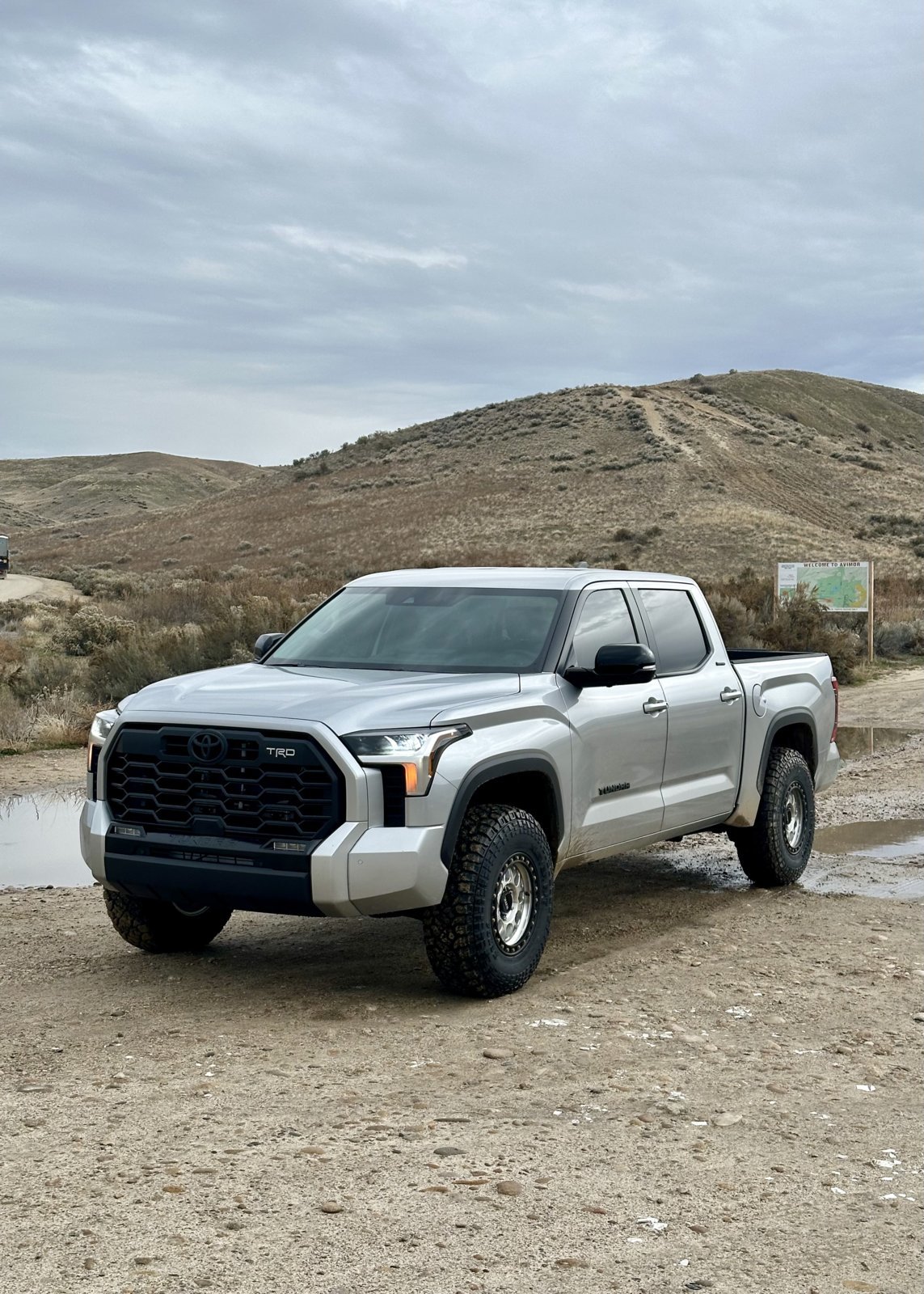

    I was going to do the 1.75 rc spacer but it seems it still sits nose high? Can anyone recommend a 1.5 inch kit?

    Awesome yea I think I’m gonna go with one of their set ups. Just trying to decide between just doing the 1 inch up front, or doing the 1.5 in front and 1 in rear. What are you running?

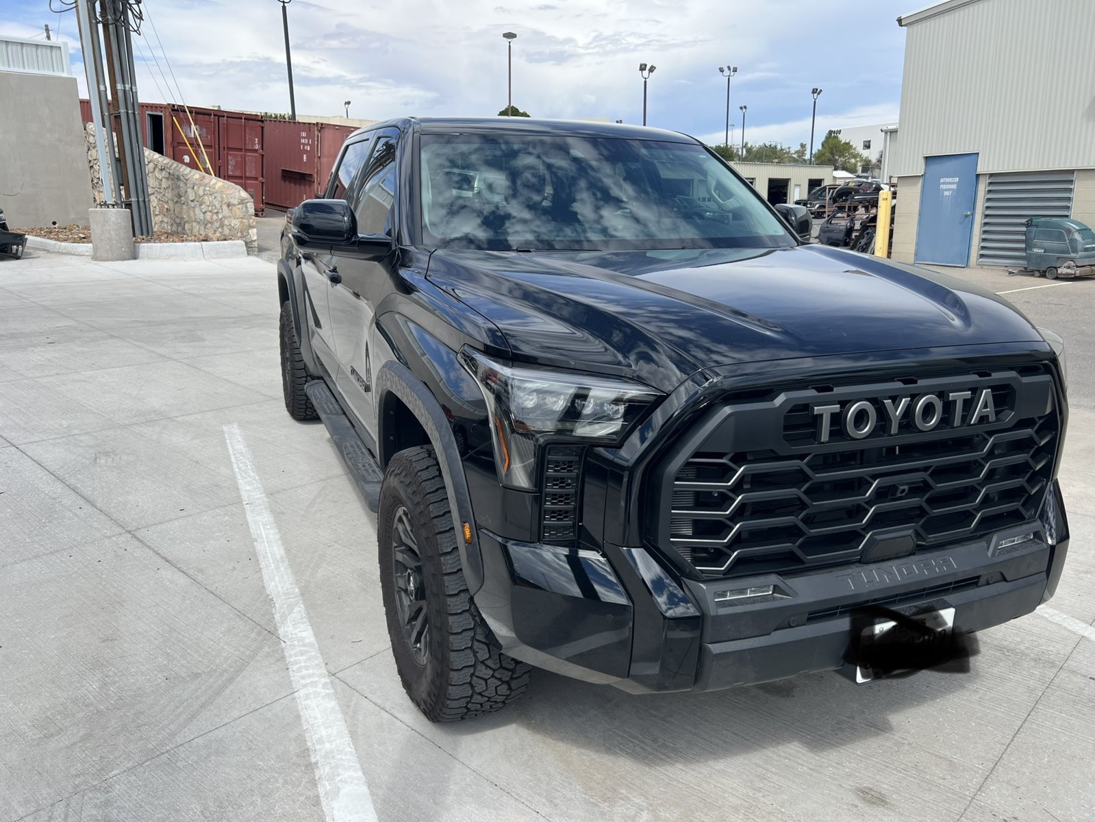

    usfdrohead
    usfdrohead New Member
    Nov 20, 2017
    #11071
    216
    I did the 1 inch cornfed upfront. Looks great. Still keeps a little rake for towing etc. next up tires .

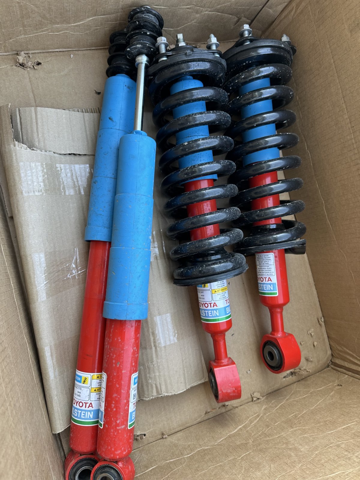

    #53
    Feartomorrow
    Feartomorrow New Member
    Nov 7, 2023
    #106536
    15
    2024 Limited OR
    Unsure if this will be of any help or not, but I just removed the stock TRD OR rear struts and have them sitting in my garage, I can provide their measurements if you’re curious.

    Feartomorrow
    Nov 7, 2023
    #106536
    15
    2024 Limited OR
    I put some Dobinsons on. 2” in front and then new struts with stock coils and a 15mm poly spacer in back.
