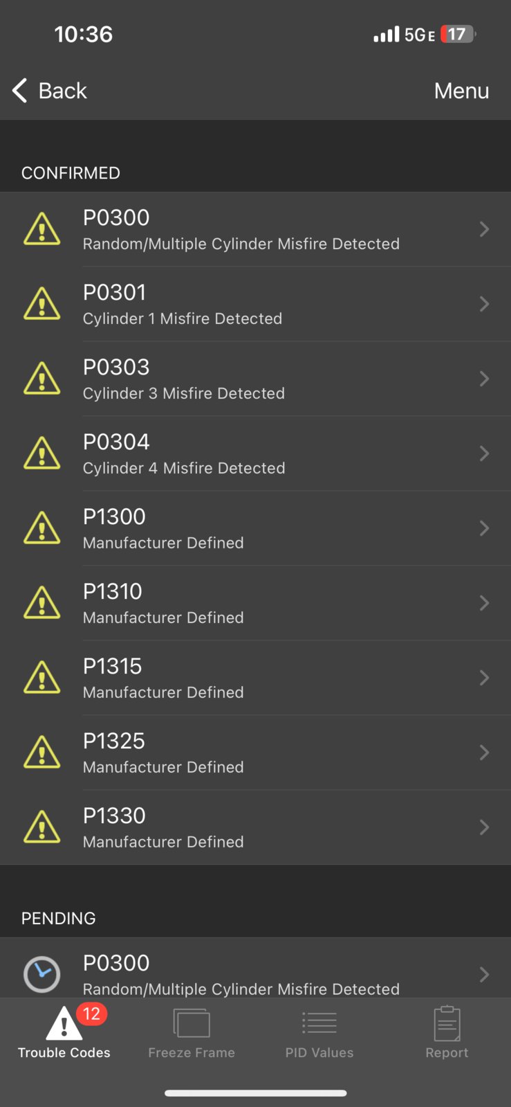

    Update #2:
    This morning I am getting
  16. Mar 8, 2024 at 1:24 PM
    #46
    87warrior
    87warrior Whiskey Tango Foxtrot
    Nov 10, 2023
    #106686
    222
    Kansas
    2004 DC 2uz 4x4
    Based on what you have posted, I would agree with this. Have you dove into the EWD and traced all of the ignition wiring back to the ECU? Based on the description of the random wire attached to the coil wiring, I bet you will find some hacked part of the harness somewhere. You can find a copy of the EWD's here: https://www.tundras.com/threads/ultimate-tundra-wiring-diagrams-collection.81448/
    Although I am convinced this is an ignition problem, what happens if you open the throttle all the way? The way these throttle bodies work with a throttle cable is kind of strange. The throttle cable at the throttle body operates the APPS (accelerator position sensor). This in turn tells the electronic throttle motor to open the throttle plate which is what the throttle position sensor reports. However, in the last 80-100% of travel, there is a mechanical linkage inside the APPS that will physically open the throttle plate a about 20%.
    It sounds like you have an OBD scanner capable of displaying real-time data. What is the MAF/Air temp, coolant temperature and throttle position reporting?
