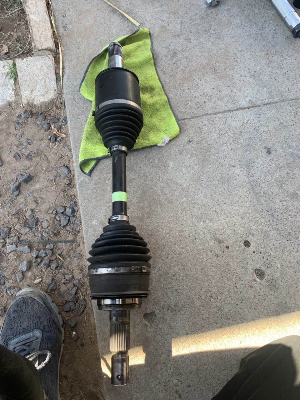

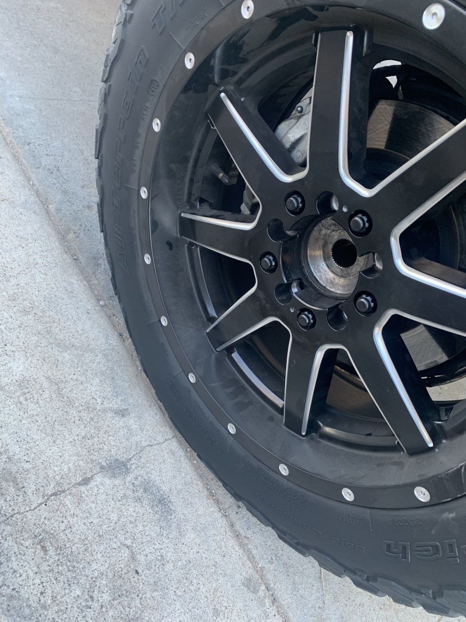

    I am taking off the CV axles at the moment. I already took the drivers side off and am in the process of the passenger side. This is driver side photos. I guess CV housings look bent and have grease on them as well as the inner wheel seal

    No CV’s. No skids. No sway bar. What’s left? Ball joints? Steering rack?
