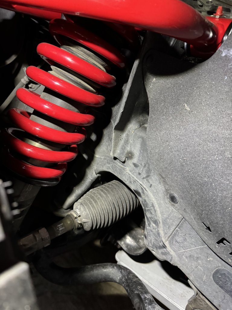

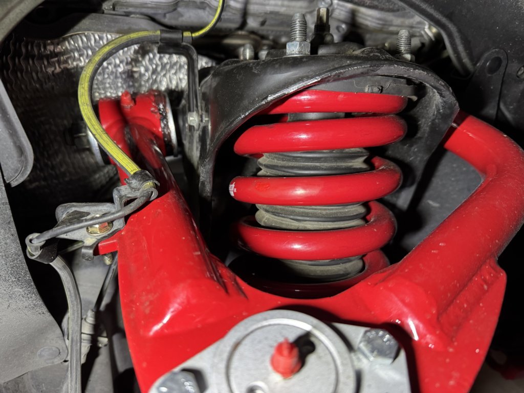

    I just installed the Eibach springs on my 21 Pro. I have the old springs sitting on my garage floor. I’m in Austin, TX. Not sure how much shipping would be, but they are in the eibach box. Send me a PM.

    I’m leaning towards the eibach pro lift (PN: E30-82-079-04-22). Is that what you installed? Can you share some photos? Did you need UCAs?

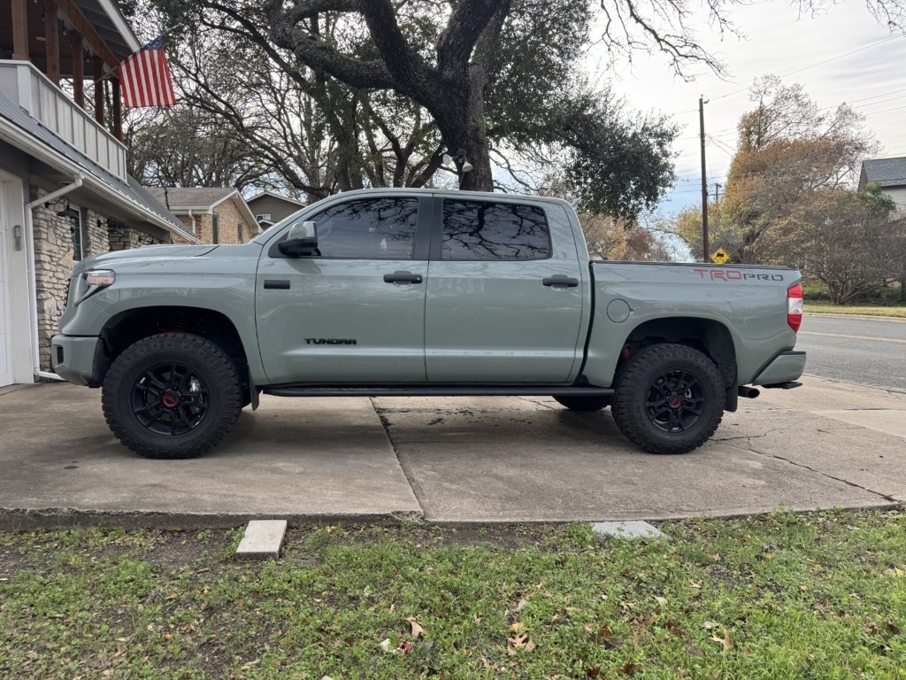

    Yes. That’s what I put on, but the part number is just for the front springs, not the one you mentioned which includes a block for the rear. I did coach builder 3” in the back with RAS and I would say the truck sits level with the HD RAS at the medium level. I probably didn’t have to do UCA’s, but I did anyway. I was getting a slight rub on full lock both before and after. Tires are 285/75/18 Good year Duratraks from a Ford Tremor.

    Looks hella good. how much lift did the front springs alone net you? Do you have before and after measurements?

    I forgot to measure before, but I had the CB and RAS on without the front and unloaded it had “normal” truck rake. It was obvious. Now, it looks level or only slightly higher in the rear.

    That looks sharp!
