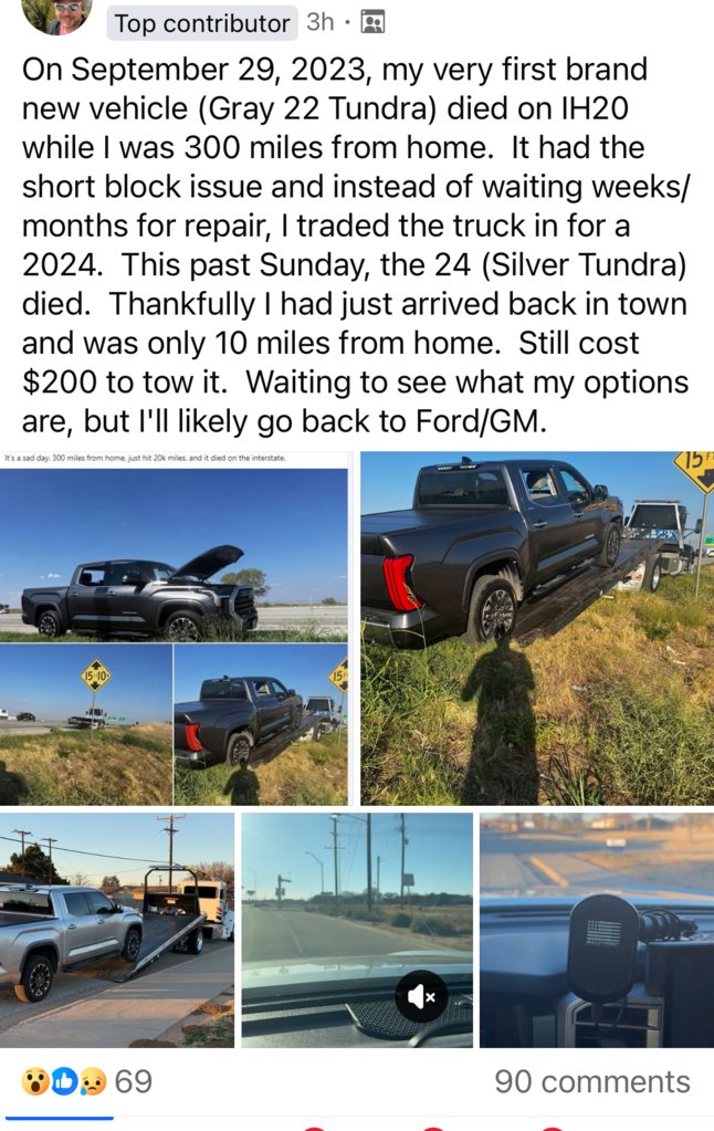

    The biggest problem with the machining debris explanation is the fact that MY24 and at least one MY 25 truck(s) have failed. If machining debris is still the cause 4 years in, then Toyota has become entirely incompetent. I struggle to buy that

    And just when you start to think not that many trucks are actually failing, something like this pops up. This poor guy won the lottery twice.

    I have been involved in many root cause analysis of industrial quality and safety incidents, and in most cases you have two types of causes: direct and contributory. A direct cause is the one that ultimately caused the failure or incident. Contributory causes are the circumstance and other factors that induced the direct cause. For example, a pilots error resulting in a plane crash would be direct cause, but fatigue, lack of sleep, bad weather would be contributory causes.
    It may very well be that the DIRECT cause of the failure is / was debris from machining that wasn't properly removed.
    But I'm pretty sure there are many contributory causes. These could be defective cleaning procedures, inexperienced workers, bad design of the cleaning equipment, bad design of the engine block that makes thorough cleaning impossible, or a weakness of the bearing design itself.
    I think the fact that the engines keep failing (albeit at a slower rate) is a clear indication of a design / engineering defect. Procedures and training have surely been addressed - I can't believe that Toyota wouldn't resolve these issues pretty fast. But the evidence so far points to a more fundamental design issue, which may or may not be resolved in future iterations of the engine. Many Toyota engines suffered from chronic problems that were never fully corrected in spite of dragging on for years: a good example is sludge problems with 1997-2002 engines.

    Seems fairly compelling evidence that something is amiss.

    At this point… whether it is a design flaw or a manufacturing “process” issue… Toyota hasn’t been able to fix it…. since 2017… in two separate factories…. after a billion dollar recall. I think we can all agree that the sooner an “unnamed individual” tears in to another motor to hunt down changes the better!

    Oof.

    There might not be a practical solution, outside of totally redesigning it, and therefore letting the cat out of the bag, that the design was inherently flawed. So the smart move may very well be might them using "machining debris" as a red herring and nursing this whole situation along until Gen 4 releases with a total redesign for the motor (or an entirely new motor comes out).
