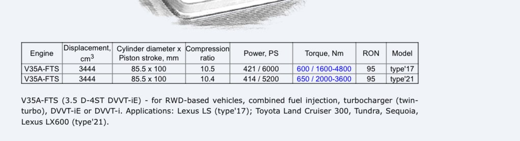

    the block that Toyota was using 11400-F4010 began production in Nov 2021, wasn't used (as that part#) in any Lexus, or Toyota's until then

    That’s right. Known as the Type ‘21.
    type ‘17 engines had similar bearing failures in the Lexus although seemingly very few in comparison to the Tundras.
    Toyota_Ed[QUOTED] likes this.

    And, it's original part# 11400-70220 C/S to 11400-70221, makes you wonder...

    It's still the same family of engine, just an evolution of the V35. And both iterations have had bottom end failure problems.
