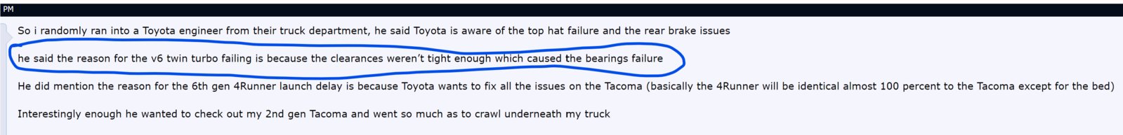

    From our TacomaWorld friends:
    I've seen a video with a lot of slop in the main bearing play, but that was after the main had already spun. Kind of surprised an engineer wouldnt have stuck to saying just debris causing it. Then again it could have been someone claiming to be a Toyota engineer. Either way thought it was interesting.

    The bearing clearances have been the same since the V35A-FTS (Type '17) was introduced in the Lexus LS500.

    The clearance on the bearings also dictates what sort of oil to use.
    If the bearings are too loose then wouldnt the problem be lessened with a higher viscocity oil instead of a 0w20?

    Design Issue ... probably should've used plasti gauge on each and every engine assembled. But, maybe they did?
    Mystery is still why #1 set?

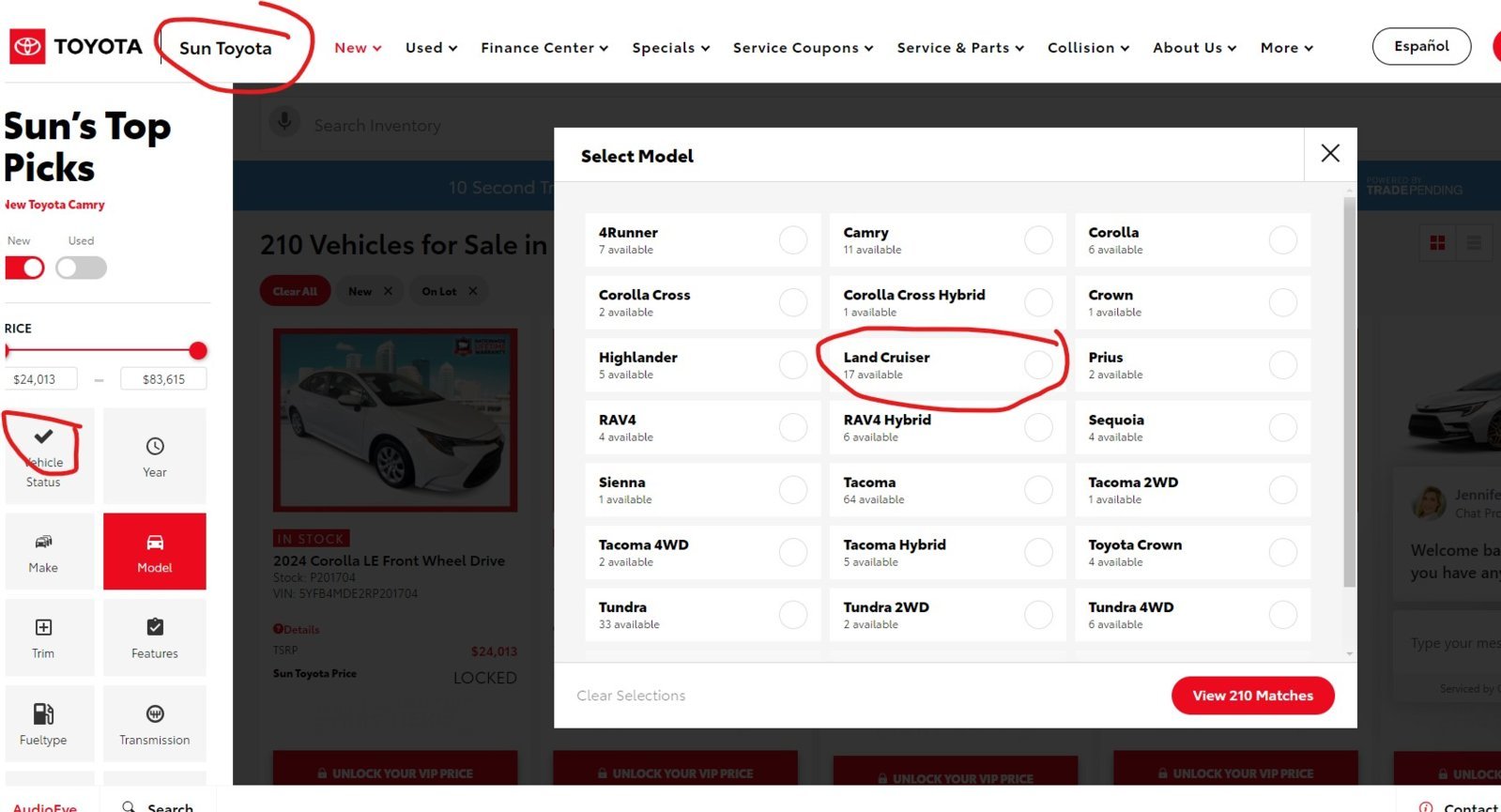

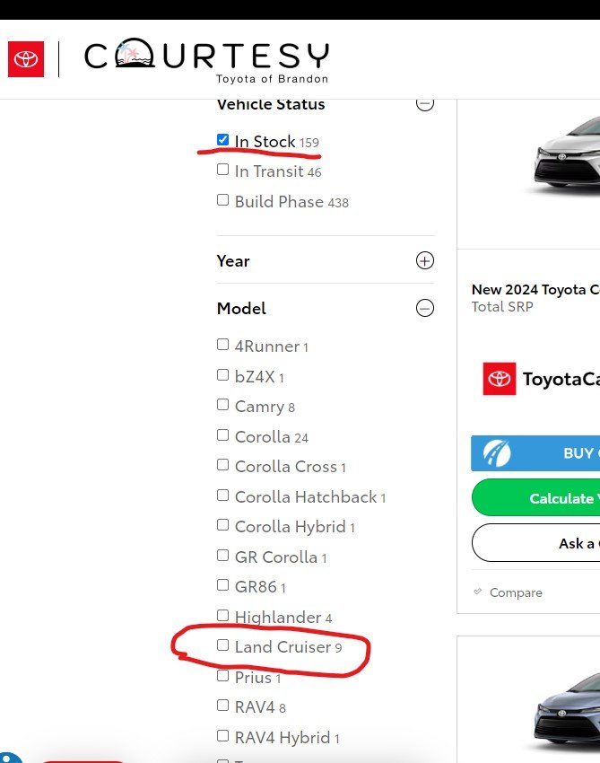

    This will bug the Canadian Land Cruiser guys.
    Just a quick look at 2 local dealers and they have this many on the lot. I think folks are not interested in the price, games local dealers are playing with add ons or wary of Toyota 1st year truck based vehicles with Turbos and poor quality builds. Especially if based on the Tacoma which has been having some issues.
    Quite a few Tundras and Tacomas at both as well.
