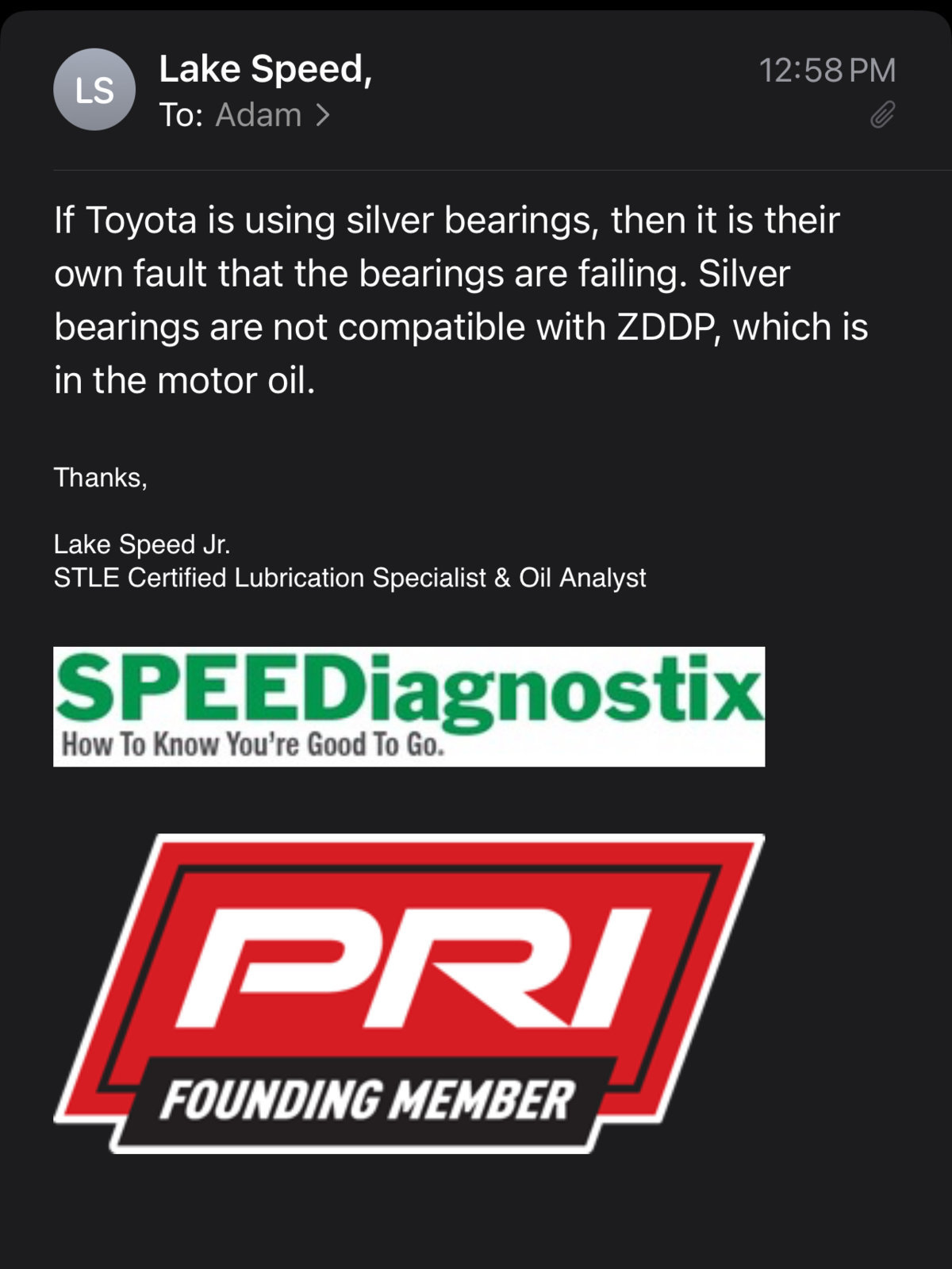

    2024 SR5 4X4

    I'm not trying to argue with you but it could be from silver solder used in the oil cooler.

    Silver might live in the solder used to make things like an oil cooler. I am not too sure if we have one in of these in the V35 but that sort of thing can contain silver.

    So the Speed Diagnostics says that everybody knows not to use silver in the bearings, but apparently Toyota engineers weren't aware.
    The guy who wrote this email got ahead of himself to suggest that Toyota engineers did this simple stupid mistake.
    Both Toyota and Blackstone guys are stupid, and Speed Diagnostics is smarter than them all. You should reply to him asking to double check that silver isn't used and they're not testing for it.
    More likely the Speed Diagnostics messed up and should in fact be testing for silver as well.
    Just making a logical argument here

    So you’re saying either Speed is wrong or Toyota is wrong and you’re betting on the one that just recalled $2B worth of engines being right. I’ll wait for more info.

    Yes, Speed is wrong.
    Just what you said. I'd bet my money on Toyota and Blackstone engineers, not speed... Never heard of them

    What does he have wrong? That ZDDP isn’t in oil? Or that it’s not compatible with silver bearings?

    Pretty sure he’s saying that Speed doesn’t test for silver because silver shouldn’t be in the engine.

    Speed would agree - but there is silver.

    If it’s silver leeching from the solder, why isn’t silver elevated on every analysis? Mass produced engines allow “industry averages” to be calculated. This isn’t some one off motor after all, and those averages make the oil analysis reports meaningful.

    I think speed is wrong on both points.
    We know that silver is in the oil as confirmed by the Blackstone, so something is shedding silver inside of the engine.
    And Toyota engineers weren't concerned about any incompatibilites between silver and oil. I trust them

    It is normal to use silver as an electroplated overlay, but not common to see it on a UOA. It serves to add antifriction and is also stronger than some other materials (such as copper). Silver should actually help with spun bearings, as it can help with a bit more friction than some metals. I would not trust an oil analysis that does not test silver. I also think high silver is a precursor to debris caused engine failure in these engines, as it indicates bearing wear. I have had UOAs on my 5.7 and 4.0 Toyotas and no silver was ever indicated.
    Most consumer oils contain amounts of ZDDP compatible with electroplated silver bearings, but some diesel and racing oils do have very high levels. If a backwoods hobby engine builder like me is aware of this, so is Toyota.
    Outside of debris, I think fuel dilution could also be a killer.
    Silver also is very tolerant to heat. I wonder if the turbos have silver in their bearings.
