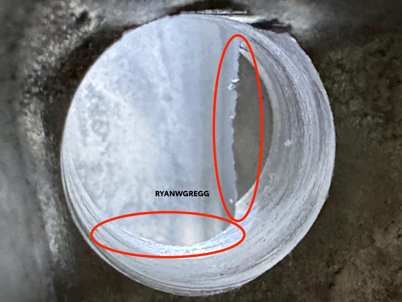

    It was so much more. He gave a pretense of being "in the know" about what the cause of the failure was. He suggested more than once that he personally need not be concerned about engine failure due to his maintenance schedule. He claimed his truck had surpassed the mileage "danger zone" for failure. He pretended to have inside information about a single "incompetent shift/worker theory". He assured people that Toyota would take care of the problem even out of warranty. Swore he knew for a fact it was under 0.5% failure rate, quoted by more sheep on this forum than I could count before falling asleep. Dude is pathologic and added so much disinformation, a former twitter employee would say, "that's a bit too much".
    I would never wish this on anybody. But after misleading numerous on this forum, his engine failed and Toyota corporate is giving him the runaround that he said they wouldn't, and Karma is telling him drop your pants and bend over cause now your my bitch!

    Last sentence? I see where they state they saw increase from September 23 to January 24. Those would have been produced prior to September, so all 22-23’s and the majority produced prior to 2/23.

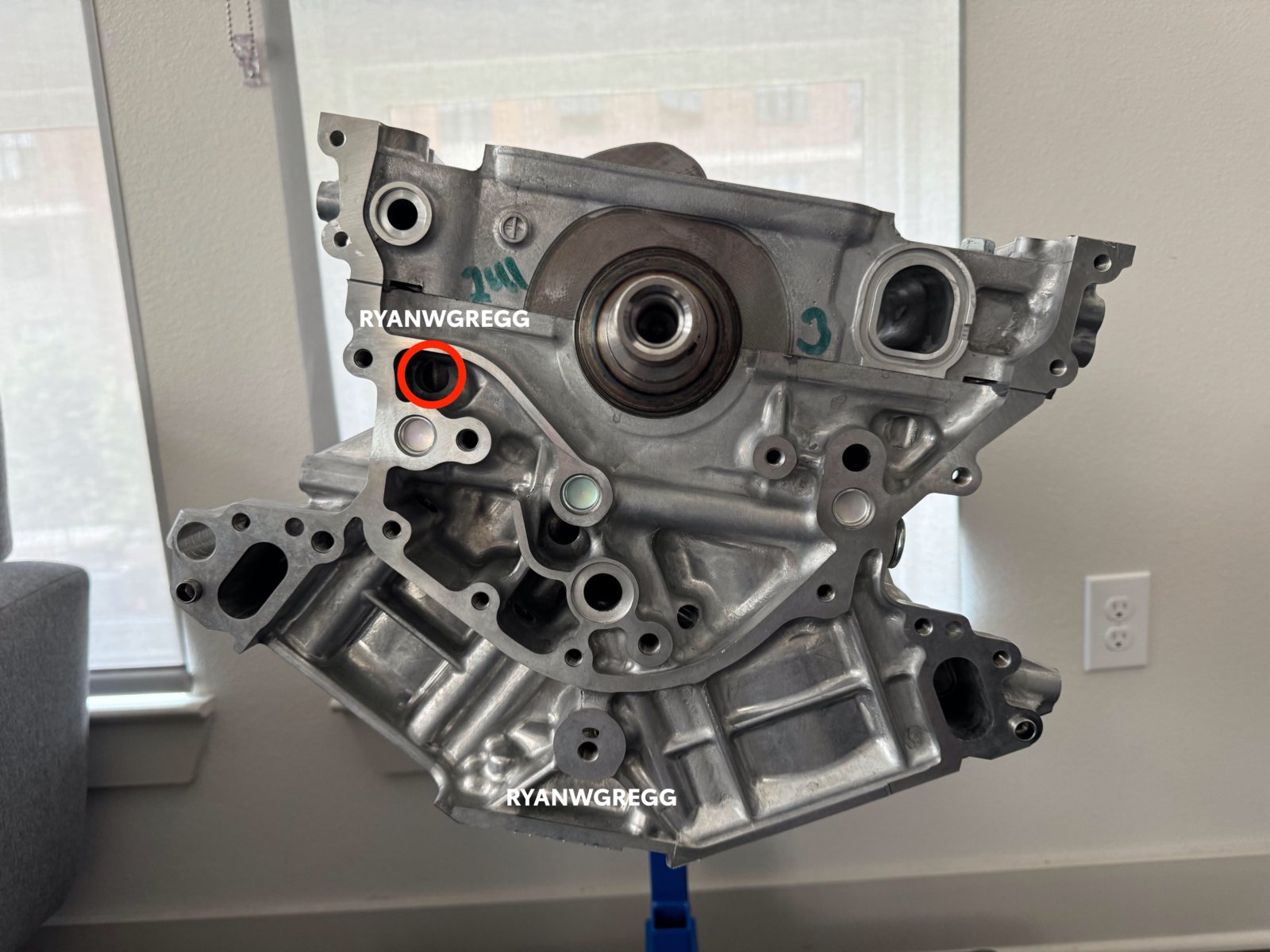

  12. Aug 2, 2024 at 4:51 AM
    #492
    Retired...finally
    Retired...finally Utilizing that doctorate of procrastinatory arts
    Aug 6, 2021
    #66426
    3,409
    Dan
    2021 Barcelona Red SR5 Crewmax
    Custom bug spat pattern hood, grill & bumper. Dead Live Oak leaf collection under hood, cowl and lower fenders. Beach sand custom floor covering.

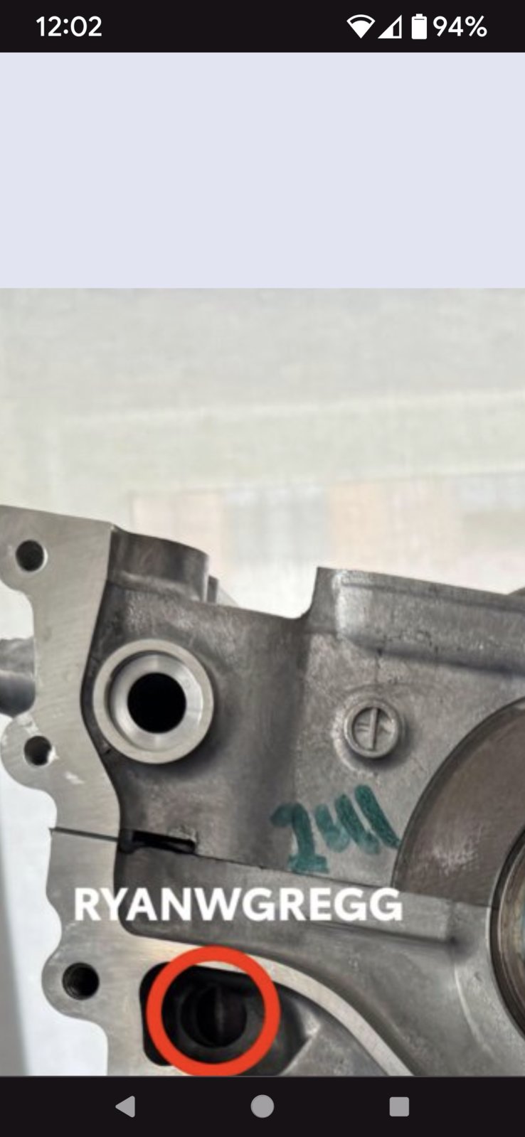

    I don't believe these hanging chads are on the high pressure side of the lubrication system. There was a lubrication diagram somewhere on the forum that although very basic might verify which side of the oiling system this port is on. For right now I'm going with the oil return side and not the high pressure side. I wouldn't want to see one of these chads plopping out through the oil drain when changing my oil but in all reality if it's laying in the bottom of the pan, it's pretty benign.
    Tunrod likes this.

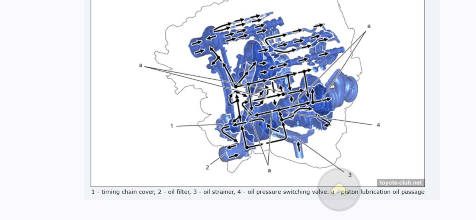

  13. Aug 2, 2024 at 8:28 AM
    #493
    MaineTundy
    MaineTundy 285/65/20 KO2- 34.6”. 35’s fit stock!
    Dec 17, 2023
    #108587
    302
    2012 Rock Warrior / 2024 Limited CM 6.5, TRDOR
    Tow Hooks! 285/65/20 KO2 Yakima Rack Carlinkit Carista tweaks
    This picture was posted in a locked thread. I still can’t tell the flow but not much of a motor guy. Is Ryan’s red circle ‘a’ in the diagram?

    Retired...finally
    Aug 6, 2021
    #66426
    3,409
    Dan
    Thank you Sir. Looking at the diagram I still believe the pictures Ryan posted are on the return or drain side.

  17. Aug 2, 2024 at 9:08 AM
    #497
    Retired...finally
    Aug 6, 2021
    #66426
    3,409
    Dan

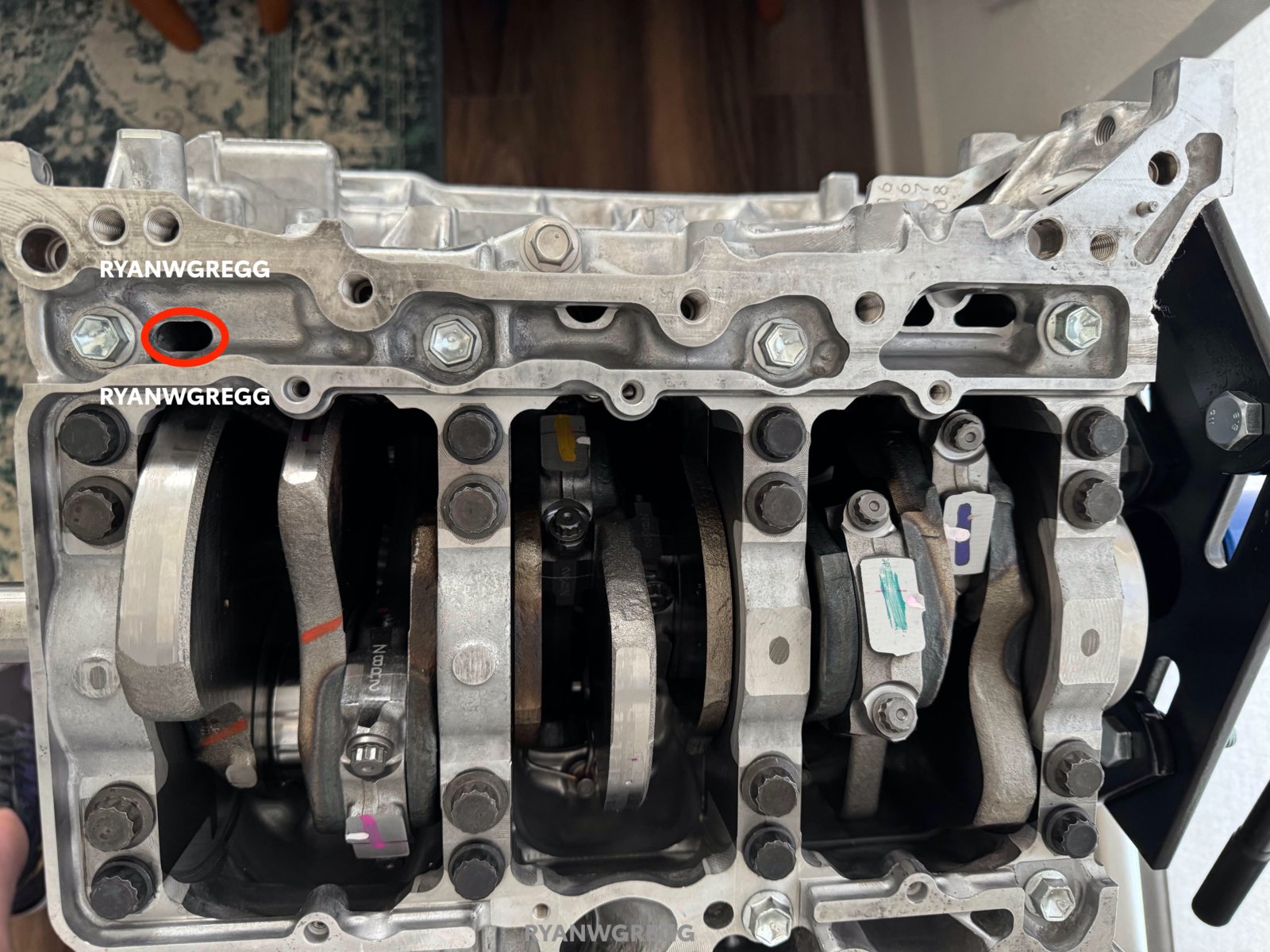

    Here's why I think it's the drain side.
    Look near the center of these two screen shots. See the area between the two machined surfaces? That opening would allow high pressure to be on the timing cover side of the crank and therefore the entire space behind the timing cover would be under pressure.
    Thoughts?

  19. Aug 2, 2024 at 9:23 AM
    #499
    PBNB
    PBNB Needy
    Oct 21, 2022
    #85226
    1,996
    Peter
    Vancouver, BC
    2023 Z71 3500 HD
    Lots of stuff!
    This sounds very likely correct. The lack of seal or machined mating surface would indicate a lower pressure situation. Either way, it doesn't belong there just hanging around waiting to come off! I can't see something that large getting sucked into the oil pump so it shouldn't make it from the oilpan back into the oil system.
    If this flapper was thin enough, it could break down and the edges could end up in the oil system. Still not too sure how this would make it past the oil filter and end up at the main bearings??
    Could this be the "debris" they are referring to??
  20. Aug 2, 2024 at 9:28 AM
    #500
    MaineTundy
    Dec 17, 2023
    #108587
    302
    Here is a link to that diagram and a lot more. I have no idea what this site is but I hope I don’t get Ryan’d. :anonymous:

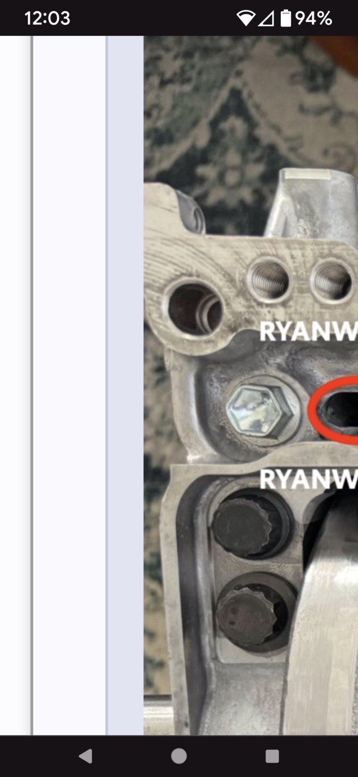

    2021 SR5 CM 4x4
    My take was he said both ports circled were connected and the port on bottom of engine along with the others appear to be oil drain to pan from top end.

    Yep. That my opinion.

  24. Aug 2, 2024 at 9:48 AM
    #504
    jctmundra
    jctmundra New Member
    Jan 27, 2023
    #90987
    584
    Northern VT
    '23 1794 Hybrid Stunning Mesquite/Cream
    If return, has to make it past the sump screen, make it through a gerotor pump and then past the filter. Unlikely. This does question the machining quality/practices which would impact the pressure side.
    Regardless, no sense in worrying, gonna drive it. If is seizes, deal with it then. Nothing I can do to to keep some hanging flake from causing mechanical havoc.

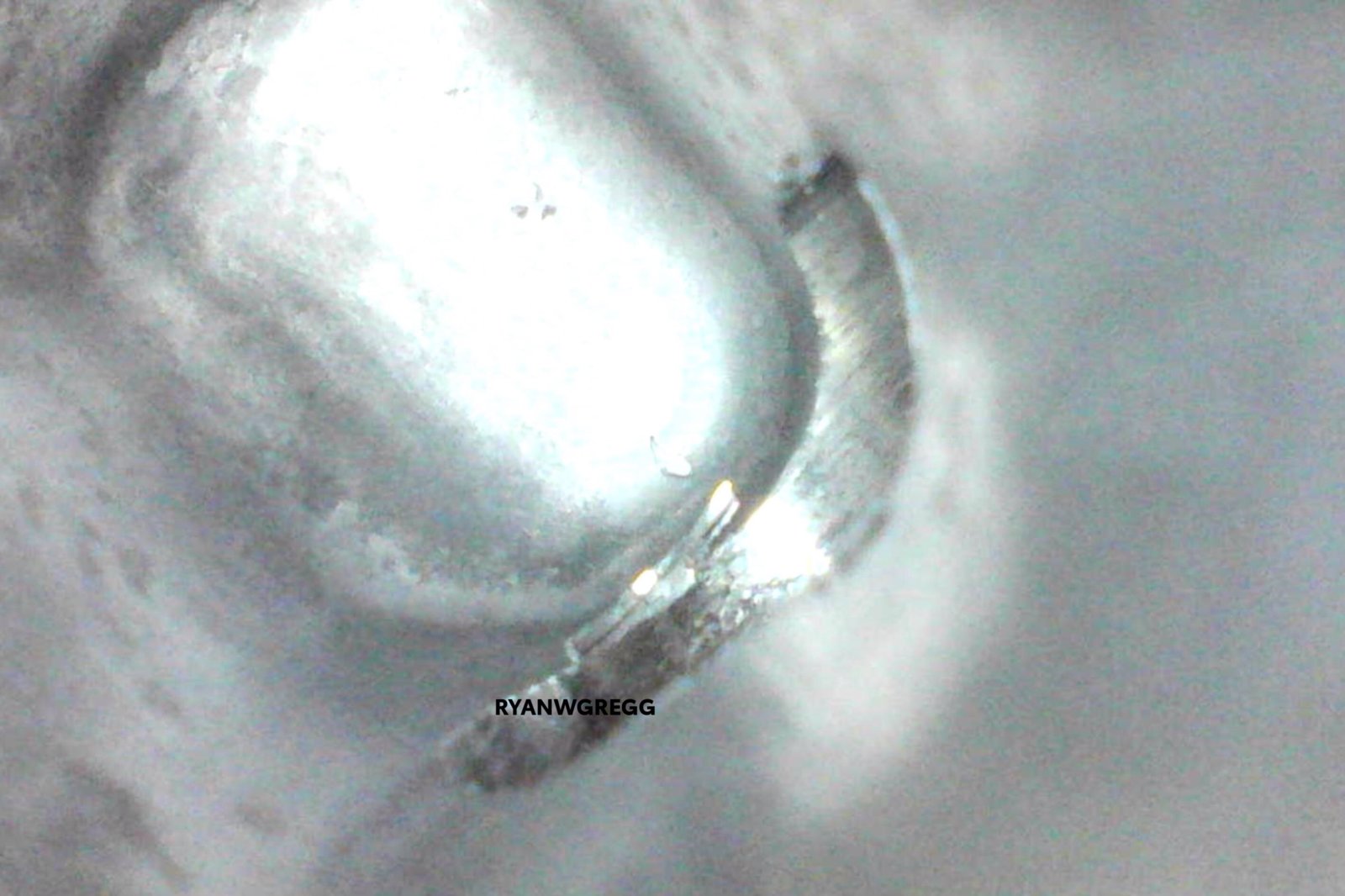

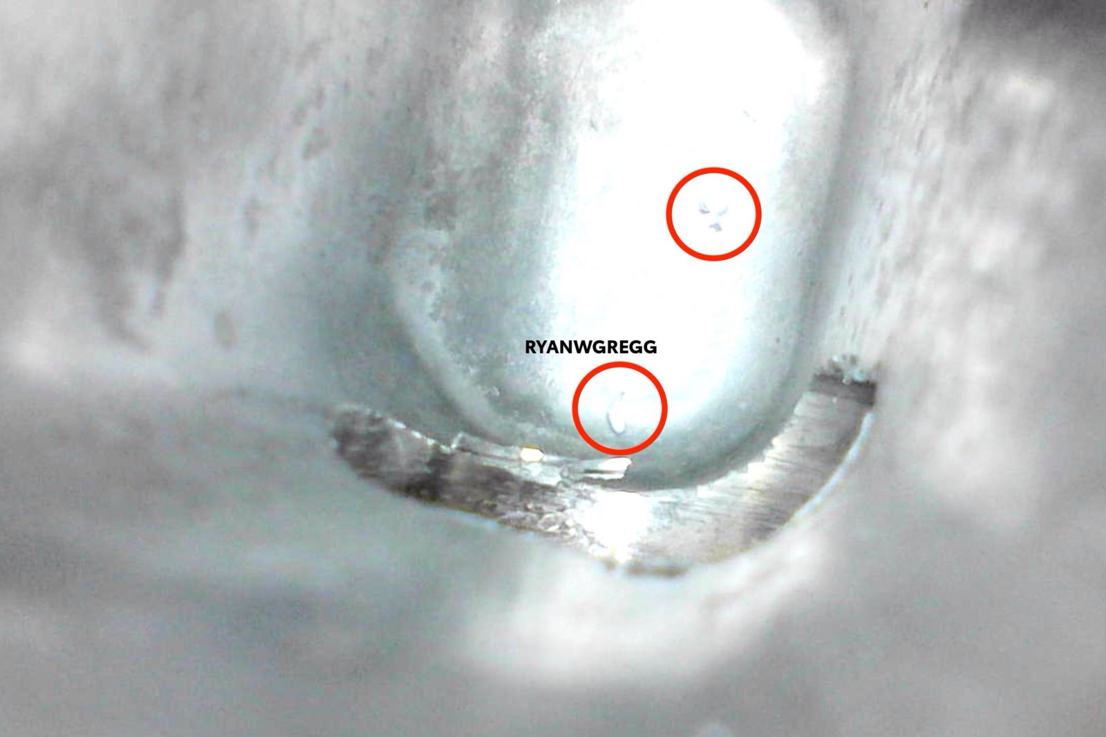

  30. Aug 2, 2024 at 1:48 PM
    #510
    22whatwedo
    22whatwedo New Member
    Aug 6, 2022
    #81594
    961
    The Open Road
    22 SR5 TRD OR Army Green
    I apologize for the quality of these images. Lower resolution 720p pictures. Working on finding a higher quality scope.
    This is straight through the Main Oil Galley, Journal Oil Supply.
    For those watching on Tundras, this is the 'a' referenced by "MaineTundy" in the thread titled "Tundra engine recall - interesting news"
    And to "Retired...finally", while the previous may not have been on the high pressure side, there is debris on the high pressure side. You can see it in the last picture.
    Ryan just put this on Facebook. Looks like he is lurking here
