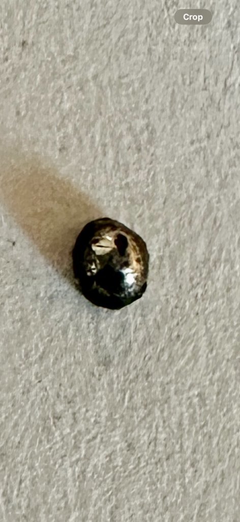

    Took a picture of one of the largest metal piece I collected during my 1st oil change. Looks like a melted piece of metal, about 1.5mm. Looks like a product of break-in, rather than prior machine debris, given the melted appearance.

    I think the place cleaning the blocks needs to be blown up and start over
    I tend to think not Ryan is correct and that cleaning process was never really fixed.
