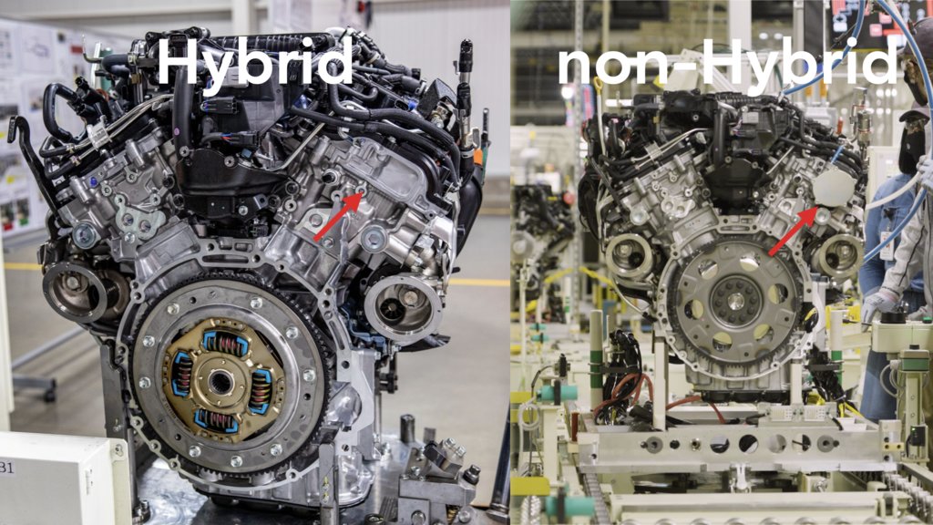

    The "Partial Engine Assembly" is going to be different from non-Hybrid to Hybrid. No one has said anything about the "Partial Engine Assembly" aka long block being the same across non-Hybrid and Hybrid. It was always contested that the short block was different and that is completely false.
    The difference between non-Hybrid and Hybrid can be seen in this photo. The Hybrid is also a single accessory drive belt v. two for the non-Hybrid.

    This would be why the long block assemblies coming out cannot be used in the Hybrids. Went the long way around to answer that one. It's the passenger side head that appears different. Short block would reuse the head, or hopefully include new hybrid compatible heads during motor replacement.

    So... a vacuum pump and two different flex plates.

    Explain to us what is happening in that picture then.

    @hagrid already answered it correctly.
    Vacuum pump on the non-Hybrid.

    What drives the vacuum pump? It just hangs off the head there?

    In most other examples it's driven from the end of a camschaft.

    Soooooo, same head, but different valve cover to accommodate the vacuum pump drive?

    I'm thinking yaesh.

    Yet there is only one part number for the heads, and only one part number for the valve covers.....

    There is a singular part number for each valve cover, so no, not a different valve cover. It is more than likely different parts on the top of the valve cover, but the valve cover itself is the same.
    Looking now.
