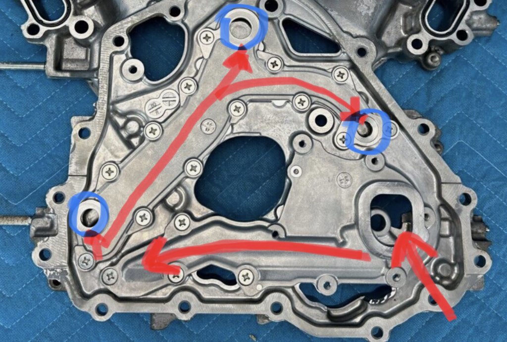

    I wrote this last spring, just a guess as to being part of the problem. It was posted on this forum, but I can’t seem to locate it.
    This is a hypothesis based on high performance engine oil feed systems and the oil related main and rod bearing failures seen on another Toyota engine, the FA series (GR86/BRZ). A high performance engine with a properly designed oil system should always feed the main and rod bearings first. This is called priority main oiling. The mains and rods see the most load and produce the most heat, thus, they need more pressure and flow volume than any other part of the engine, they take priority. Interruptions in flow here, even briefly, and the results can be devastating, wiping out a bearing(s) gradually, or quickly if the drop off is long enough.
    The FA engine in the GR86 is seeing similar failures to the V35A. As far as I have read, these failures have been determined to be partially caused by a non-priority oiling system. The FA engine feeds the left cylinder head first, then the main oil gallery. So, when the car sees high performance/high g-forces, the sloshing oil in the pan can interrupt oil pickup, and oil feed to the pump is briefly reduced. The left head, being first in line, takes its share of oil, and with flow dropping off, the main gallery, second in line, does’t receive what is required. Boom.
    The V35A-FTS is quite similar to the FA in that it has a non priority oil feed. Looking at this V35A timing cover from behind, the oil path and feed order is easily seen. Starting at the lower right, oil feeds into the oil pump. It then travels across the lower cover where it feeds out to, and then back in from the oil filter. The blue circles show the galleries being fed. First in line is the gallery for the left bank oil cooling jets, and possibly the turbocharger and cylinder head(I need to study the system more). Then, second, up top, is the main gallery, which feeds the crank/rods and the up to the heads(?). Last, a third gallery for right side jets and turbo and possibly cylinder head.
    BE2008C8-26B0-4052-99B2-7B94F5E5E7B9.jpg A63E7480-CD0F-4C24-B877-3AC4FAEEE762.jpg
    Does the V35A have an issue here? Maybe those oil jets crack open at just the wrong wrong time? The above is just a guess.
