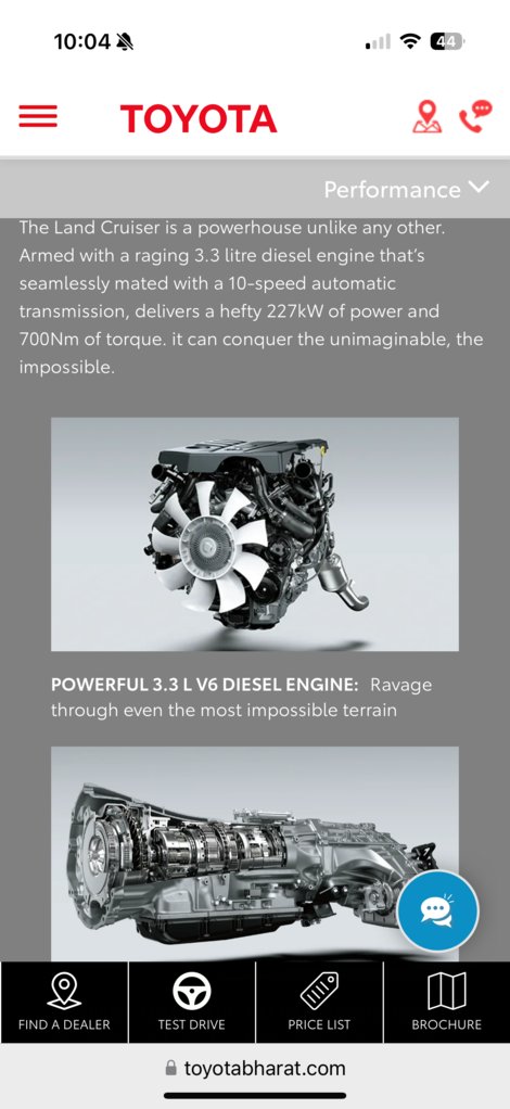

    6,124
    Music City
    6UR-FE
    The most dependable 300 is the non-turbo triple-locked cloth seats version that they get in Qatar for $55-60k.
    UN spec.
    I’d buy one in a heartbeat even though it has a NA V6 in it.
    Not sure if they make a triple locked poverty pack version with the diesel

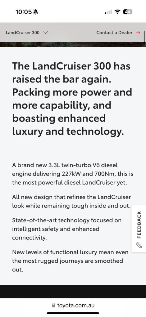

    I will stand corrected, could you explain why Toyota won’t sell Diesels here then? Or the 70 series? I was under the impression those types of vehicles wouldn’t allow them to pass their fleet CAFE or crash test stands. If that’s not the case then do you know why?
    Edit- I quoted the wrong post, this was supposed to be I reference to the emissions controls and so on
