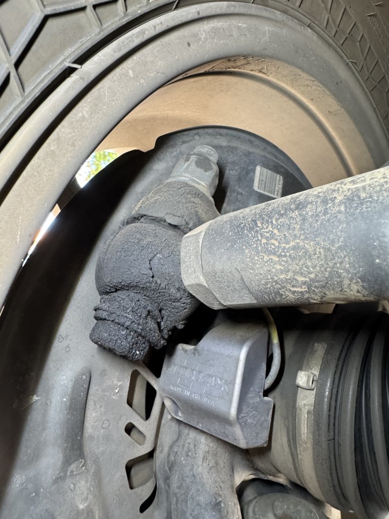

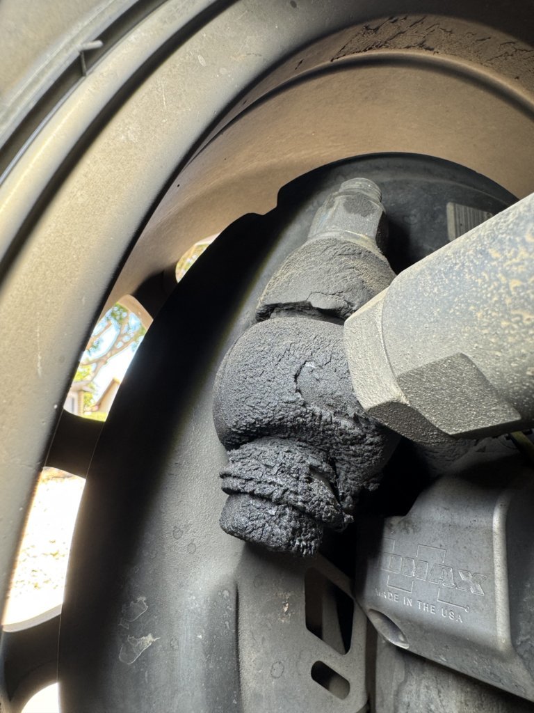

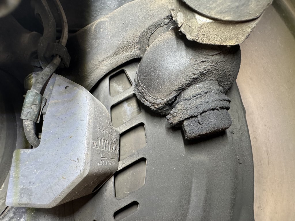

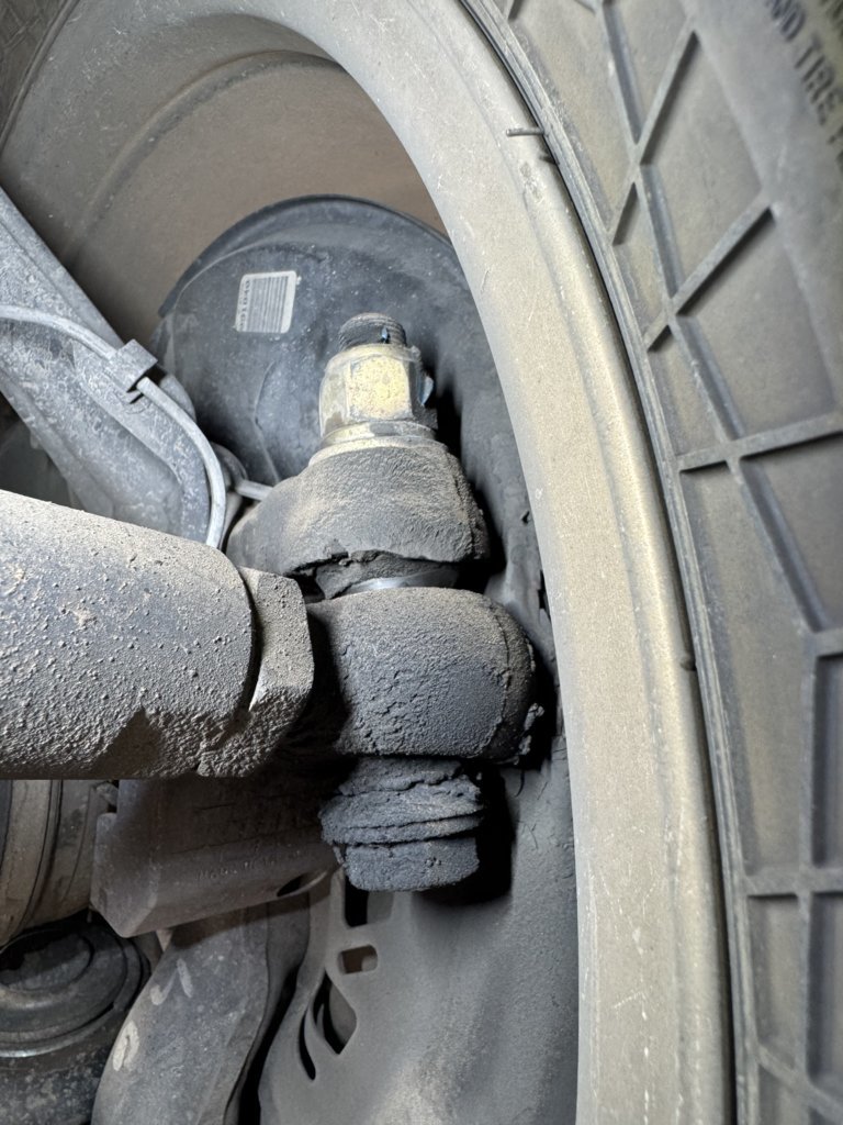

    Just had my oil changed at the dealership and they noted the outer tie rods were covered in grease. I had my Coachbuilder Steering Kit installed just over 3 years ago. Attached are some pictures - Am I in need of a rebuild kit? @Coachbuilder1. I would assume if so to do both sides?

    They’re greaseable so IMO them being covered isn’t necessarily bad esp after 3 years. Replacement depends on how much play they have not how much grease is on the outside. I’d say disconnect them and see how easily you can wiggle them around.
