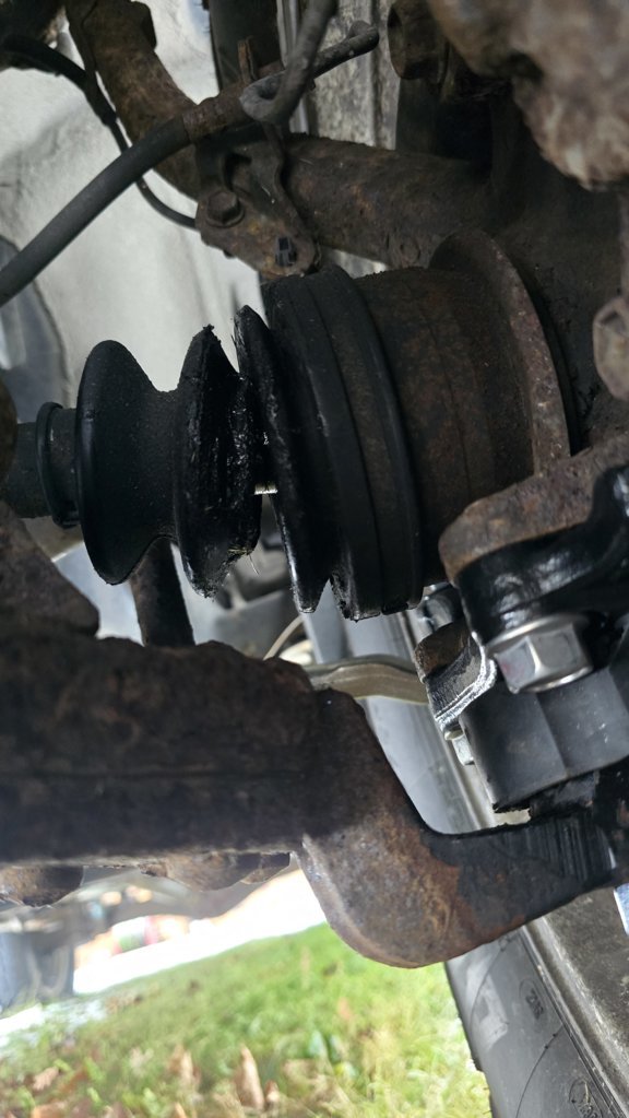

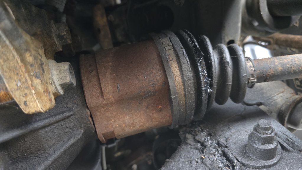

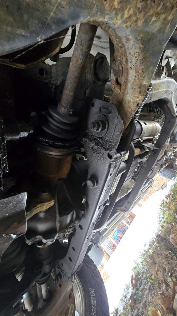

    Driver's Side cv axle boot20241122_101310.jpg :20241122_101249.jpg
    Close up driver's side cv axle boot:

    Your CV Axles may be OK. Show us pics dude. You may just need a re-clamp. Toyota CV axles are bulletproof.

    Yeah, Toyota wants over $1,000 to do CV boots. The parts are only $100. Job sucks but isn’t too bad. I would do other maintenance while you’re in there, upper lower ball joints, wheel bearing etc.
    Always stay away from aftermarket CV’s.
