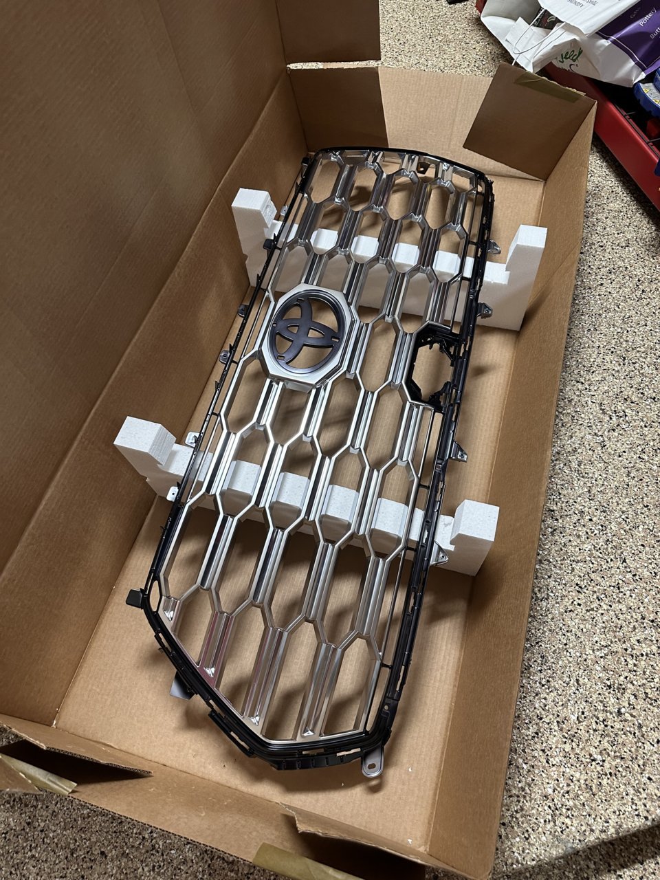

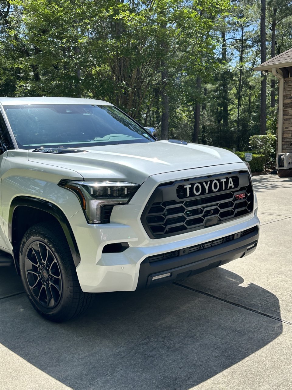

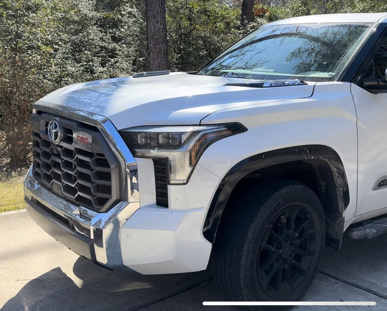

    Late to this party, but I didn’t have a stellar experience with AM either. Box arrived in bad shape, I didn’t think their website was clear and was surprised I had to purchase the main bumper cover (arguably the largest most visible part of the entire conversion)…but came to be OK with that because I saw how I became confused and the part was incredibly only $219 and the shipping would have been ridiculous (it’s huge)!
    They did not include two pieces in my kit, one known and one that was left out or fell out. TBH, they made right by it and sent it, but a lot of back and forth and delay with getting my truck “done” because I took it to my body shop to have everything done.
    The biggest issue I had, they’ve ghosted me! I tried literally for months to have them send me the last piece they said was on back order! OK, but then after I continued to contact them they said they had them and would send it right out…sorry for the delay. And it has never come, even after multiple reach outs. FWIW, that was the left side duct tube. And the part they forgot or fell out, was the same as previously mention by someone else 52117-0C050 (Front bumper support…which is critical! I had to figure it out myself and tell them!). Also, FWIW, total of 12 or 13 parts IIRC. The intake tubes X2 (left/right) and the small grill pieces that go under the lights X2 (left/right) everything else 1 of each.
    I have since ordered the left side intake tube myself to finish it completely and right. But here is before / after.
    before

  12. Aug 26, 2023 at 8:27 AM
    #102
    SDFRYRS
    SDFRYRS New Member
    Jun 28, 2023
    #99383
    12
    Ladera Ranch, Ca
    2023 Tundra Limited TRD Off Road
    That looks so clean. Well done!

  14. Aug 26, 2023 at 11:26 AM
    #104
    737fixer
    737fixer New Member
    Jul 20, 2018
    #17209
    502
    Absolutely incredible. Literally takes the complete embarrassment of a front grill and makes it look fantastic. 1000% the 2026 refresh will have a completely different grill. If a dealer offered this as a package price with install with your first oil change they would make a killing. The "Butterface Mod Package" and people would be lining up a mile down the road.
    static likes this.

    I don’t want to totally tank the AM guys. I knew I could source the parts myself cheaper, they aren’t in business to lose money so at a minimum handling, shipping, etc… but they didn’t make much for their efforts, I promise you that. Toyota, intentionally or not, does not make finding the parts (with any level of confidence) easy. Now that I know the parts I can find them easily enough, but without schematics, dealer know how (they’ve got an insider no doubt) and knowing to purchase something anyway when it clearly says “Tundra” and you know it’s for a Sequoia (and you need it) is worth something. I did also have some good conversations with them where they were quite cordial toward getting this done. But there were more hiccups than necessary and then to just stop communicating costing me another $130 just doesn’t sit well. /rant off
    Glad you like it, I think it was worth every penny. 1) looks way better and 2) doesn’t look like “everyone else’s”!
    cheers!
    P.S. - the red TRD grille badge came from Etsy, as I wanted it to mimic the red insert on my factory TRD O/R grille. A little finagling/tweaking and it sits like it was made to go there.

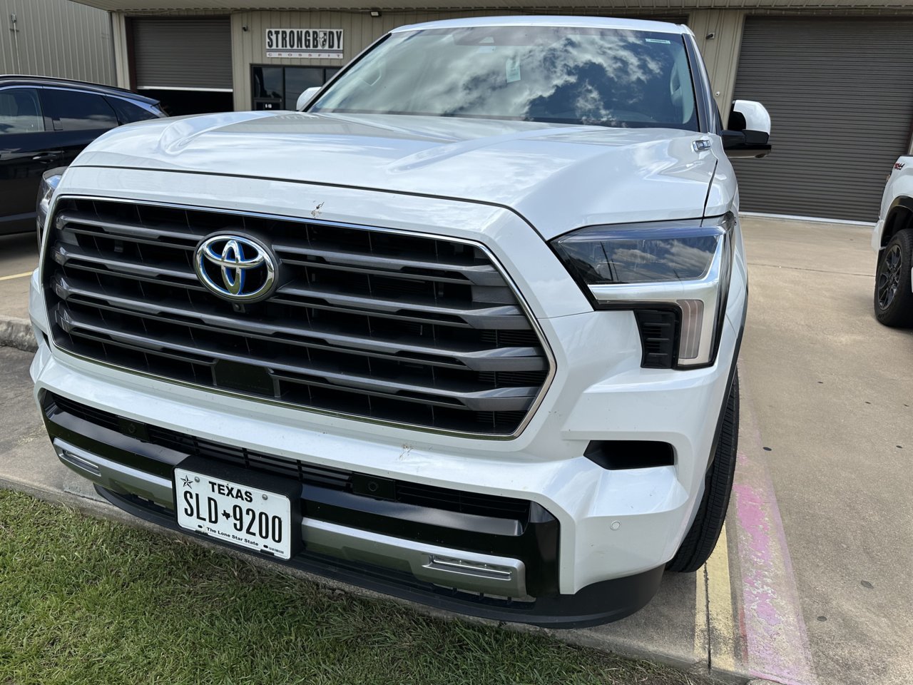

    The Sequoia has at least three grille options. 1) TRD Pro - 53114-0C530 (what is in my pic obviously), 2) Platinum grille - believe this to be
    53114-0C500, and 3) Capstone grille - 53114-0C520 I know because I bought/have one.
    I did this by literally just plugging numbers into the Toyota parts system. The only difference in description between the “Platinum” (-0C500) and “Capstone” (-0C520) in the system was the addition of the word “Premium” ( IIRC or something similar) making me think it was the “higher end” one. Otherwise same, even price was exactly the same. Remember, Platinum is more black, Capstone more chrome. I’ll post a pic of a what I believe is a platinum grille, what isn’t included (and I don’t yet have [or even P/N? ], I think is needed for both) is the thin chrome trim ring you see around the perimeter.
    This is just a random pic I took of a Seqouia, to get proper orientation of sensors (another story!!)
    IMG_5919.jpg And here is a pic of the -0C520 still in the box in my garage.
    IMG_5550.jpgEnjoy!

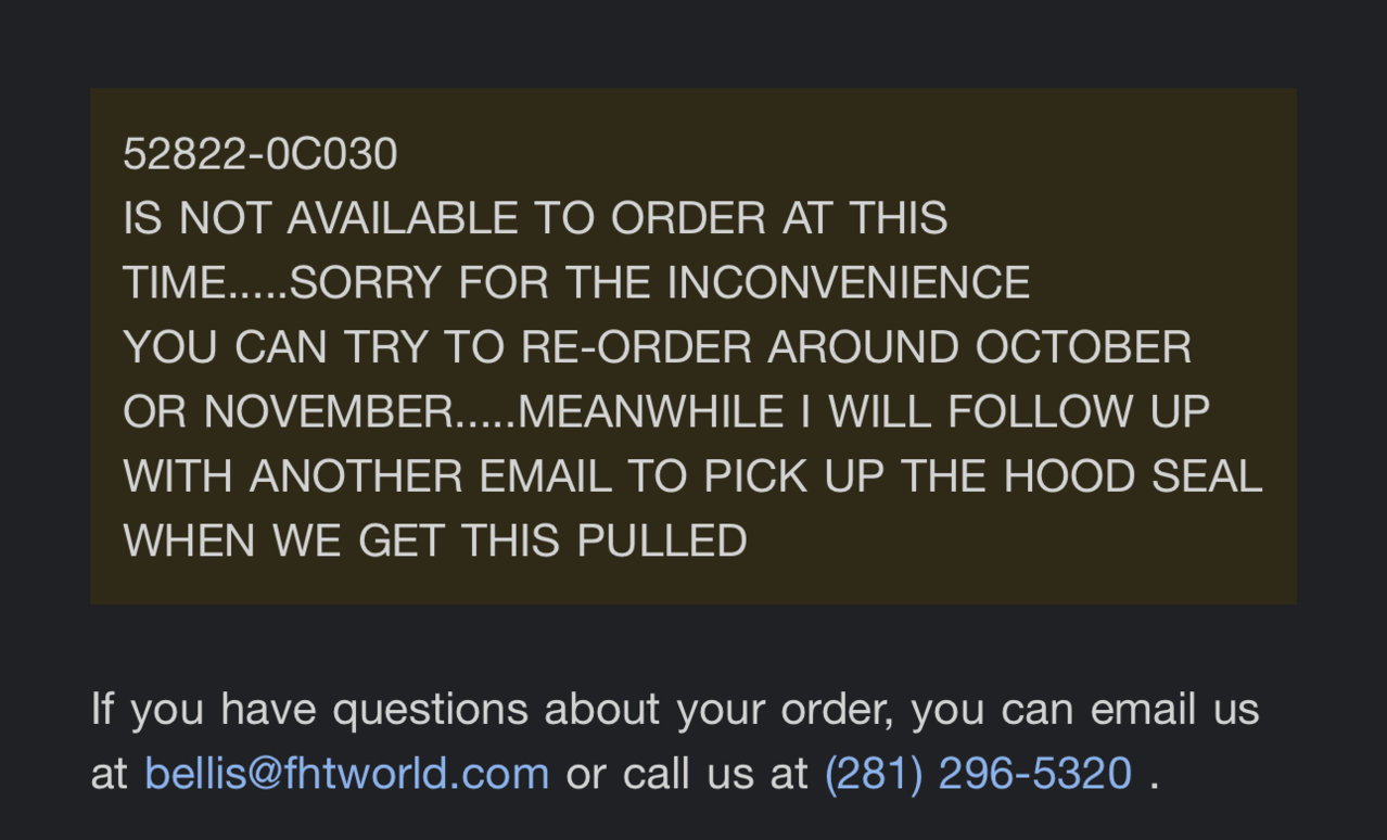

    Ugh, just got this today, the saga continues. Second time in as many months I’ve tried to order this left (driver ) side intake tube myself!
    FYI, my body shop misplaced the hood seal since it was there for over a month!IMG_7828.jpg
    This isn’t a dealership thing, they source nationally.
    Has anyone received one of these that has done the conversion?

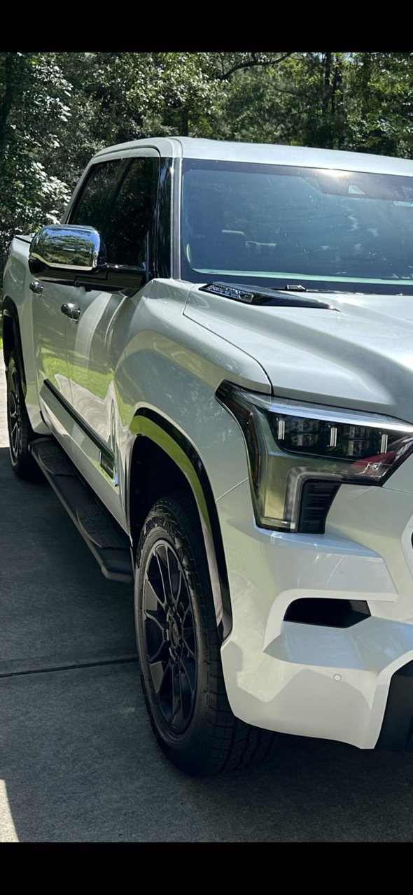

    Or source all of your parts as you can and when you have them all acquired, get the parts painted / wrapped and then assemble / have assembled. The only part I am missing is the left intake tube and it can be assembled without it, but you know it isn’t finished if you’re looking specifically at it.
    Unfinished (left intake tube not installed). Notice the tabs in the opening instead of smooth black plastic edge and tube present. Also the fender/bumper cover gap tightens up when the tube is installed as it provides support to snap/screw the two together there.
    Finished (right intake tube installed)
    Thought I’d include a pic where you can see the cab/bed so you didn’t think I was just sharing pics of a Sequoia all along and just BS’ing y’all! :D

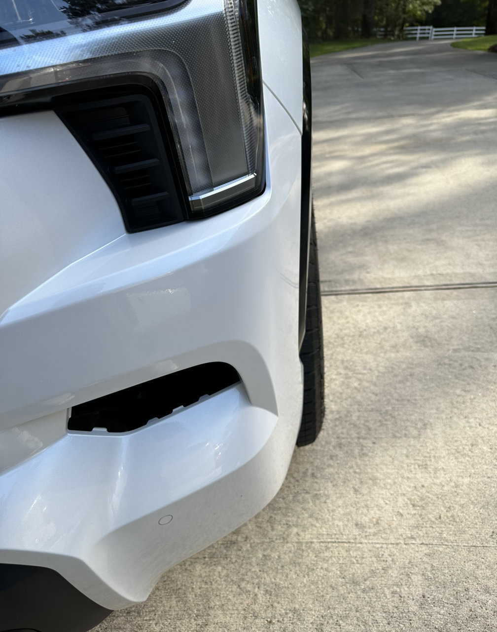

    Did you have to recalibrate your parking sensors after changing everything over?

    Not to drag this out, the simple answer is NO. There is no recalibration of the sensors required.
    The longer answer… I mentioned something in an earlier post about sensors (taking a pic of a Sequoia to check), because my body shop installed the sensors facing the wrong direction. They have a “wedge” in them or a spacer that is a wedge which allows them to remain a bit more perpendicular to the ground with the rake of the truck (I would assume). Mine were oriented wrong and pointed more toward the pavement, so less perpendicular. It made my sensors go off way too easily…I had to swap them back to the proper orientation. I would think this is why lifted/leveled trucks *may* require recalibration because it changes the angle and/or the height of these and what they expect to “detect” is not providing a strong enough return signal.
    Lesson - there are a lot of details to pay attention to when doing this swap. A bunch of items, screws, clips, wiring have to be reused with the new parts…some moved around just a bit. It isn’t rocket science, but having everything there at once to compare and paying attention to detail is important. Again, I have a good body shop but this took too long and people forget things over a month period (and things get misplaced - like my hood seal)!
