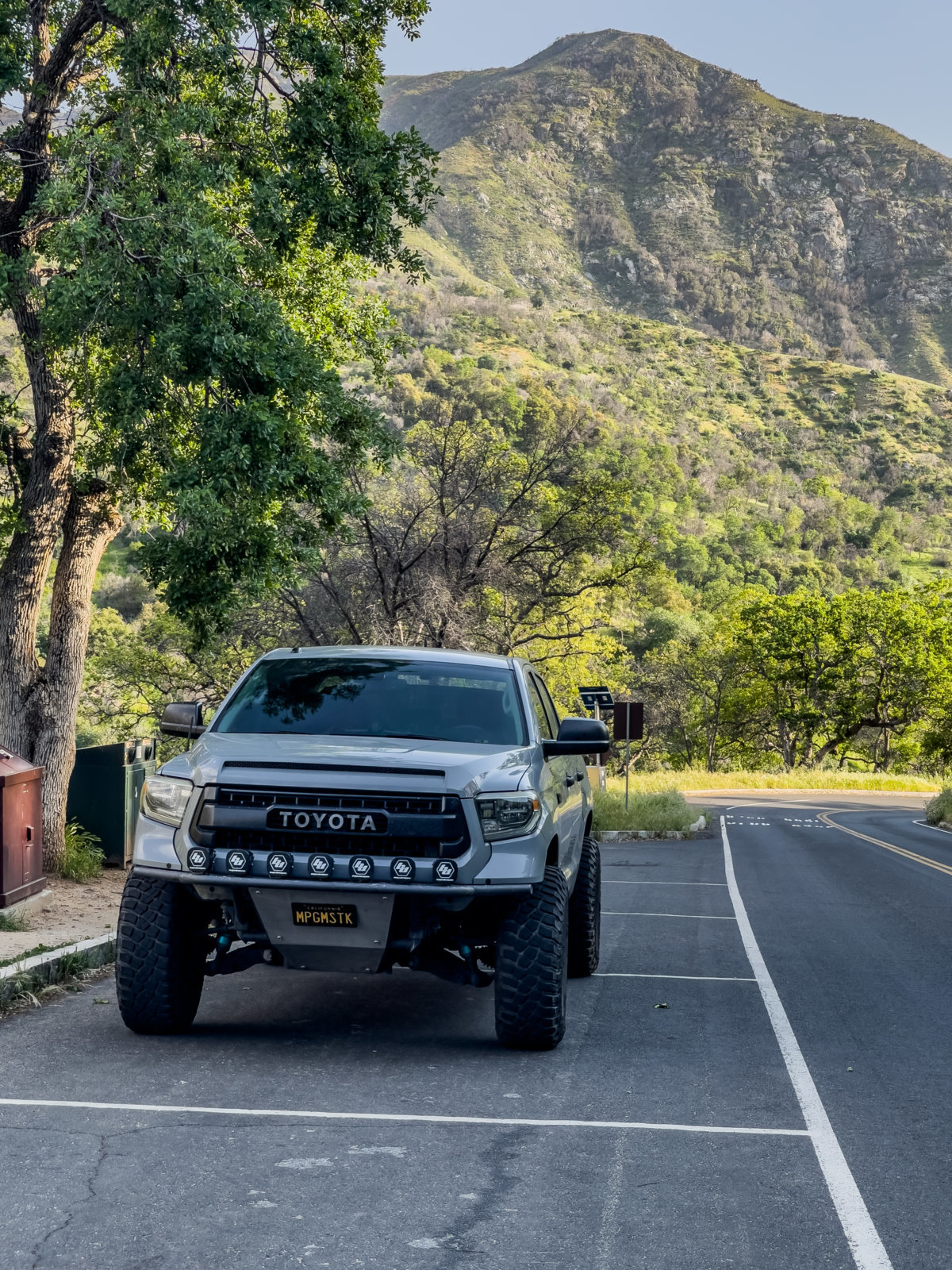

    still here lurkn.

    Still one of the sweetest mid travel builds out there, love the truck man!
