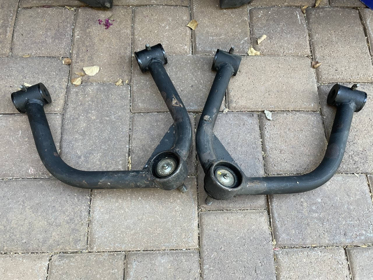

    So I just picked up a set of Tuff Country UCAs for $40 before I really knew what brand they were or really anything else about them. The seller didn’t seem to know much, other than he got them secondhand as well… they’re in somewhat rough shape, with one ball joint pretty much shot and a bushing sleeve missing from one arm, plus some rust and chipped paint/powdercoat. My question, are these worth shit if I decide to refurb them, at least with new ball joints and bushings, and a coat of paint? Or are they worse than OEM and I should just unload them on Craigslist?
