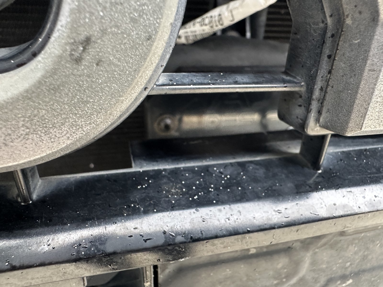

    Perhaps that could be the problem, the radar has a limited window to focus through. The newer grill has the TSS just behind the plastic (very expensive plastic) piece and has a full window of view to look through. Those older grills have a large gap between the front surface of the TSS to the grill itself then the geometry of plastic grill presents a challenge for the radar to pass through unobstructed.

    I understand they stopped making them in 2020 and no to AJT, I am talking about Jomax sensor kit.
    What is the gap between the front face of the TSS sensor when mounted to the Jomax plate to the first plastic close to it directly in front? I do not have one in front of me but the pic you posted appears to be set in closer to the radiator?

    The Jomax is very rare. The issue with the AJT is that the cover is too thick, and also the wrong material. I have made some thinner covers from ABS and have a couple of people trying them out.

    From the front of the cover plate to the back of the grill is about 3.5 inches. I still have an AJT but if I recall, they both sit just about in the same spot.

    The OEM TSS mount is directly behind the cover shield and I am sure there is a small gap between them. The OEM opening in the mounting location is huge, almost reveals the entire sensor but mounted behind the grill for 3.5" of space trying to get a radar beam made to obviously have a wide beam to cover the entire front of the vehicle from side walk to next lane to focus through a small opening before it can spread. Again just my opinion but that just does not seem like a Apples to Apples comparison to the 2 scenarios. Just again in my opinion is not feasible

    Either I'm tired or confused lol. The AJT and the Jomax both mount the sensor in pretty much the same spot on the radiator support if I recall. With the AJT, I started getting errors after about 15 miles following installation. With the Jomax, no errors at all. The Jomax used a specialized material for the cover, and AJT used thick ABS. Even shaving down the AJT doesn't work. What's funny is I believe the OEM emblem/TSS cover has "ABS" stamped on it but the front is a type of glass.

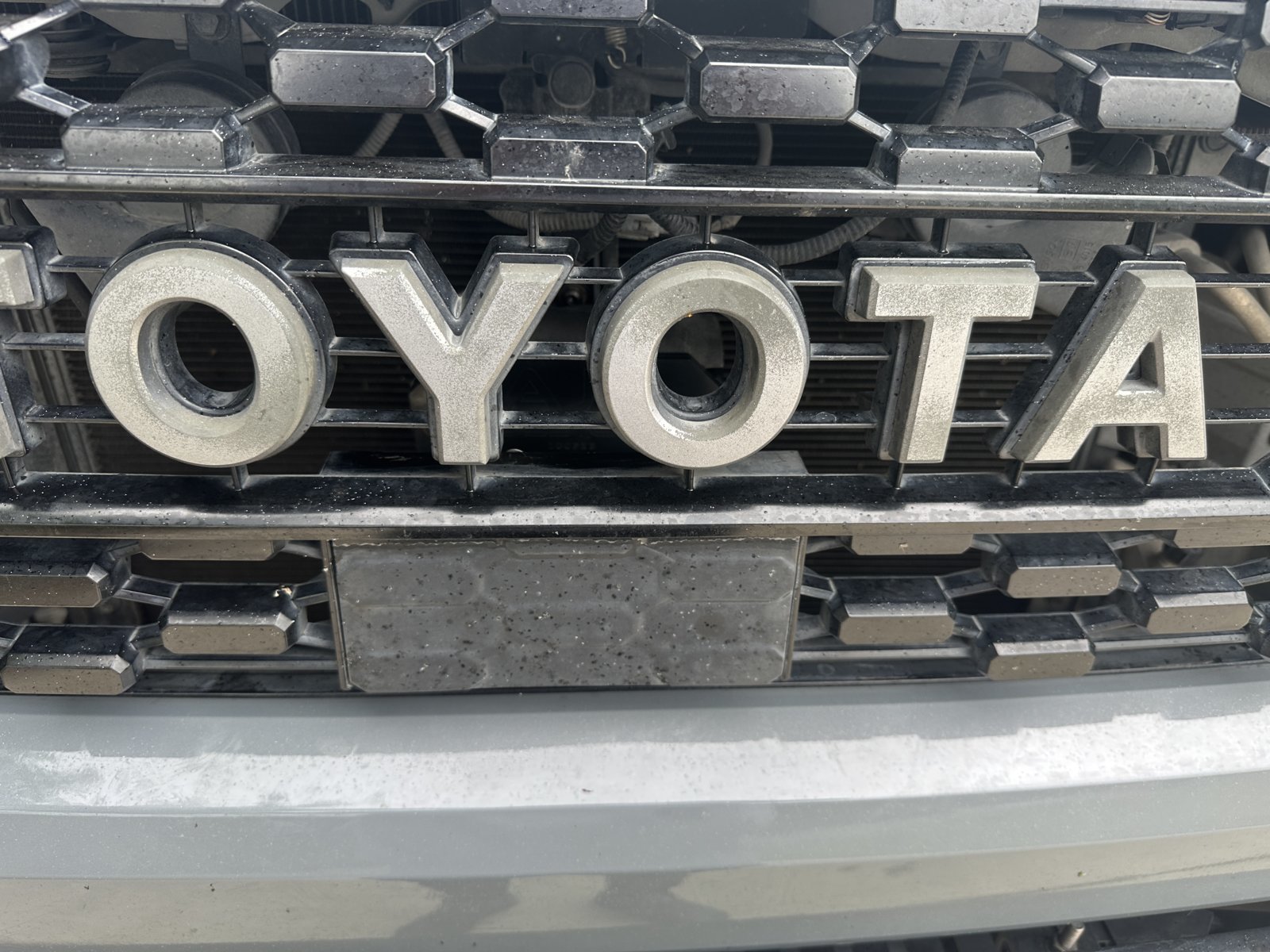

    I have tried 3 different brackets, all had problems but the Jomax worked the best for me. Eventually I switched to the 2019+ TRD Pro grill in Sept 2019 and haven't had any more problems.

    Installed the the ajt bracket today this afternoon drove it around seems to be working fine even with the 19 pro grille doing what it’s all suppose to do originally I have been wanting to install the original 17 pro grille looking to try out a Jomax bracket if anyone has one and remove this 2019 pro version grille I have because it’s cracked and buddy of mine let me have his 2017 pro grille but since I have techstream I can clear all history and pcs history per faults anytime if you don’t then the faults will go away but reappear fyi…

    The AJT is for the 14-17 and it does not work anyway. The 19 has a mounting location at the bottom of the grille.
