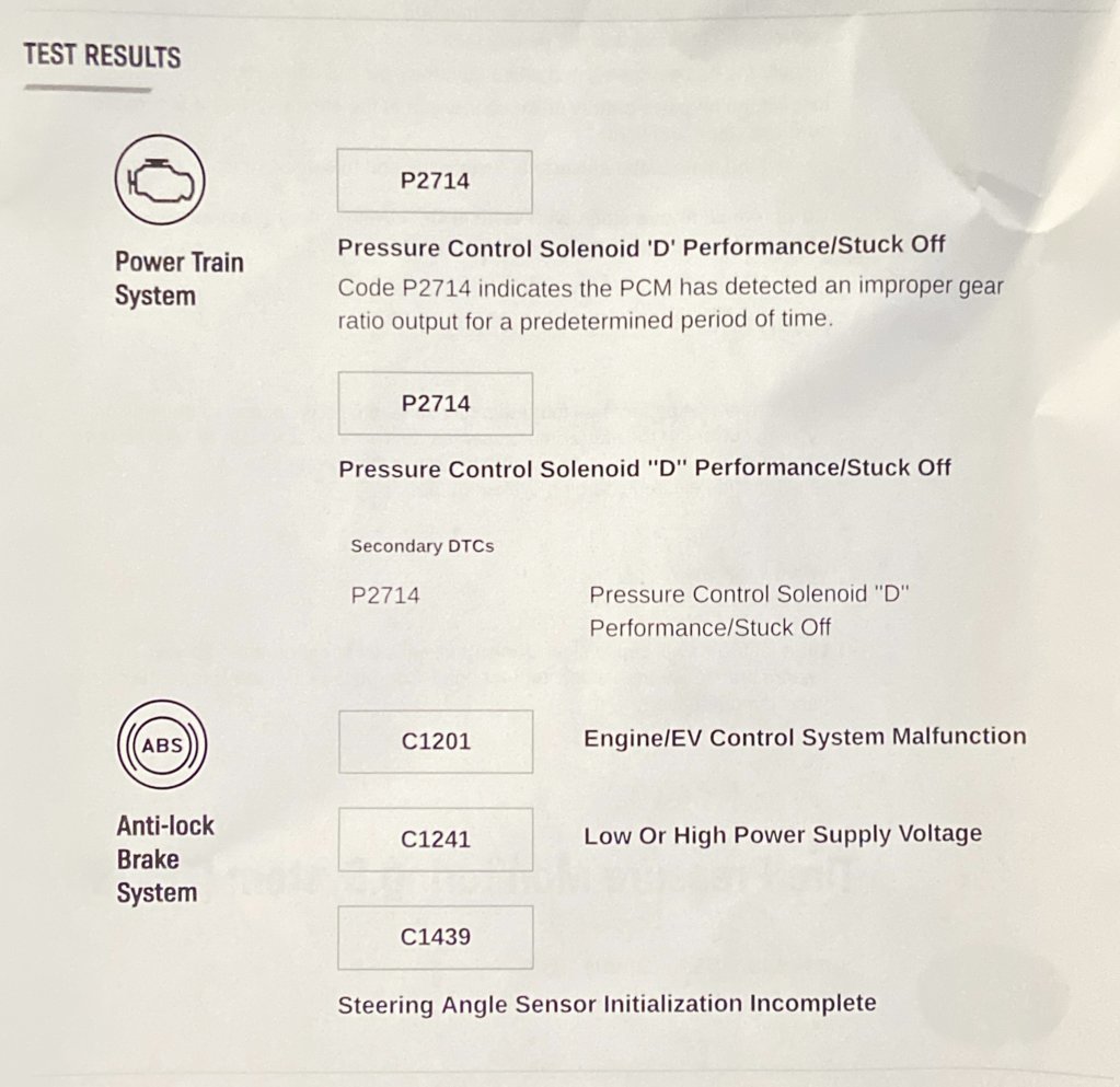

    Have a 2019 tundra literally 1 payment away and I get the collision malfunction issue. Took it to the dealer and they looked at me like I was talking in Chinese. They saw the message and said it will be 199 for a diagnostic check. Has anyone been able to fix this issue without the dealership? No alterations or tint. Truck is stock SR5 with 117k miles. Would appreciate the help.

    Unhook your battery and clean all of battery connections well. Reinstall.
    Salvo413 likes this.

    This was the result from AutoZone

    Did they load test your battery; I will say that a failing / dirty battery will cause all kinds of problems……that’s where I would start
