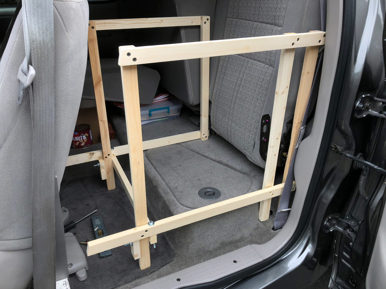

    8. Removed all of the Access Cab seats and built a storage system back there. I started it with the idea of keeping some of the seats in, but have since decided to remove them entirely.

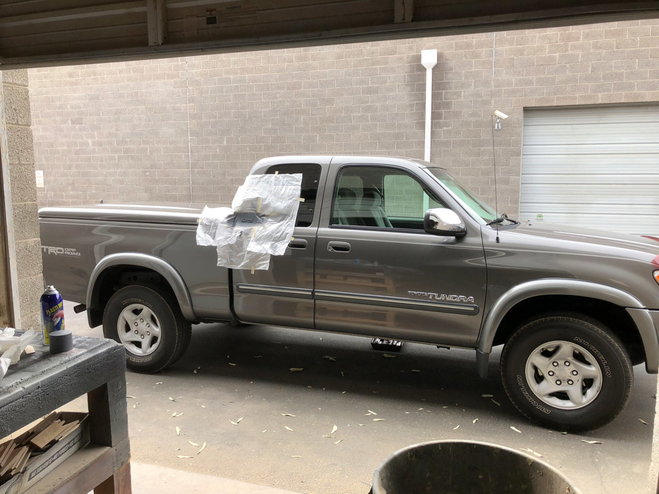

    10. Plastidipped some chrome badges, removed most of the dealer's sticker.

    As I've probably mentioned, building a living space in a vehicle has been a daydream since before I got my driver's license. Back then I assumed it would be a van, with more space, but when I learned that four-wheel-drive vans are crazy expensive for some reason, and that pickups with camper shells made more sense, I shifted gears, ended up with my Tundra, yadda yadda.
    Here's the first step. [edit: "third step", since I suppose buying the truck and then the camper shells were steps 1 & 2.] I did a bunch of research and collected many examples of what others had done. I didn't want a full-width bed/platform, since ideally I want to be able to sit on the bed and type / work / eat at a table across from it. (I do realize I need a mid-rise or high-rise shell to do that comfortably.) I did, however, want to be able to sleep two for when I l̶o̶s̶e̶ ̶m̶y̶ ̶m̶i̶n̶d̶ , er, talk my fiancee into going along.
    I found this example and used it as my inspiration. Low single bed on the left, higher surface on the right, and, critically, a center section that can slide into place for, as somebody on here put it, "romance mode".
    I think it might be a tad over-engineered. I wasn't sure how plywood and all would hold up, and I did not want to put money, time, and effort into it and be frustrated for the next 10 years because it's flimsy. So, it's 3/4 in maple plywood for the top and bottom, 1x10s (milled down) for the outer wall and drawer walls, and a 2x10 for the main center wall. I made that thicker to, eventually, help support the center bed plank when I get to that. Pretty sure I could use it as a bridge over a small ravine if I had to...
    Which is nice, except of course that the added thickness adds cost to the materials, adds weight and reduces gas mileage, and cuts into cargo volume. If I ever do it again, I might try slightly thinner material in some places.
    I used skateboard bearings (100pcs for $25 on Amazon) for the drawer slides, and 3/4 square steel tube. A lot of people use 1in, but to my thinking that wastes 1/2in of width on the drawer, i.e., cuts down on storage volume. Half an inch over the full ~6ft length is not nothing! :) The 3/4 seems perfectly adequate. Better, in fact, since there's less opportunity for...angular force (?) on it. I was able to get a washer, the bearing, another washer, and a nylon lock nut on the bolt with a hair of gap between the wall and the drawer, with the 3/4 tube, so why not?
    The weird strips along the right-hand side are because I need 2 1/4in bolts and apparently they only come in 1/2in increments and I was too lazy, so far, to hack saw all 20 of them to the proper length, so I put in a couple of pieces of scrap wood for spacers. Some day I'll fix that. Ha.
    Also, as somebody will probably notice, access to the space in front of, above, and behind the wheel well is...not ideal. In back at least I can slide stuff in - in front it is, for now, totally inaccessible. Need to decide if I want a hinged door or a removable panel. That's also in Phase II.
    Aside from basic wood and nuts and bolts, here's the stuff I used:
    3/4 square steel tube from a metal supply company. Note: some people have pointed out that some tube as rounded corners, which probably wouldn't be as ideal as more sharply square corners.
    Skateboard / fidget spinner bearings: https://www.amazon.com/dp/B073ST742Z I used about 20 per side.
    Pull handle: https://www.amazon.com/dp/B00584ZL3Y
    I could write up more of the thought / design process, but I'd just be regurgitating what others have written. You can google them like I did, but if you have specific questions, and you think I might be useful, lemme know!
