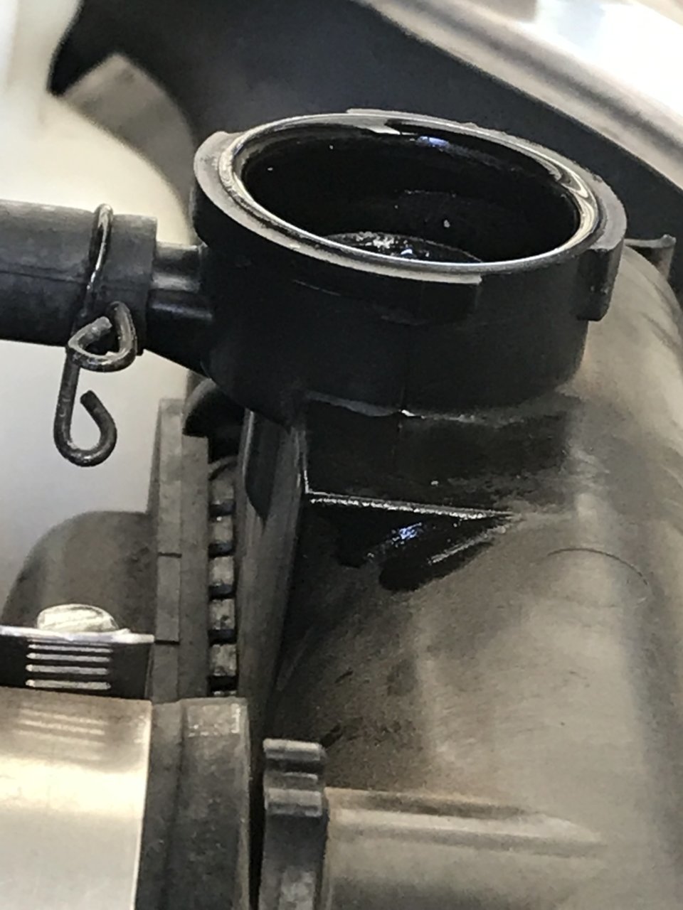

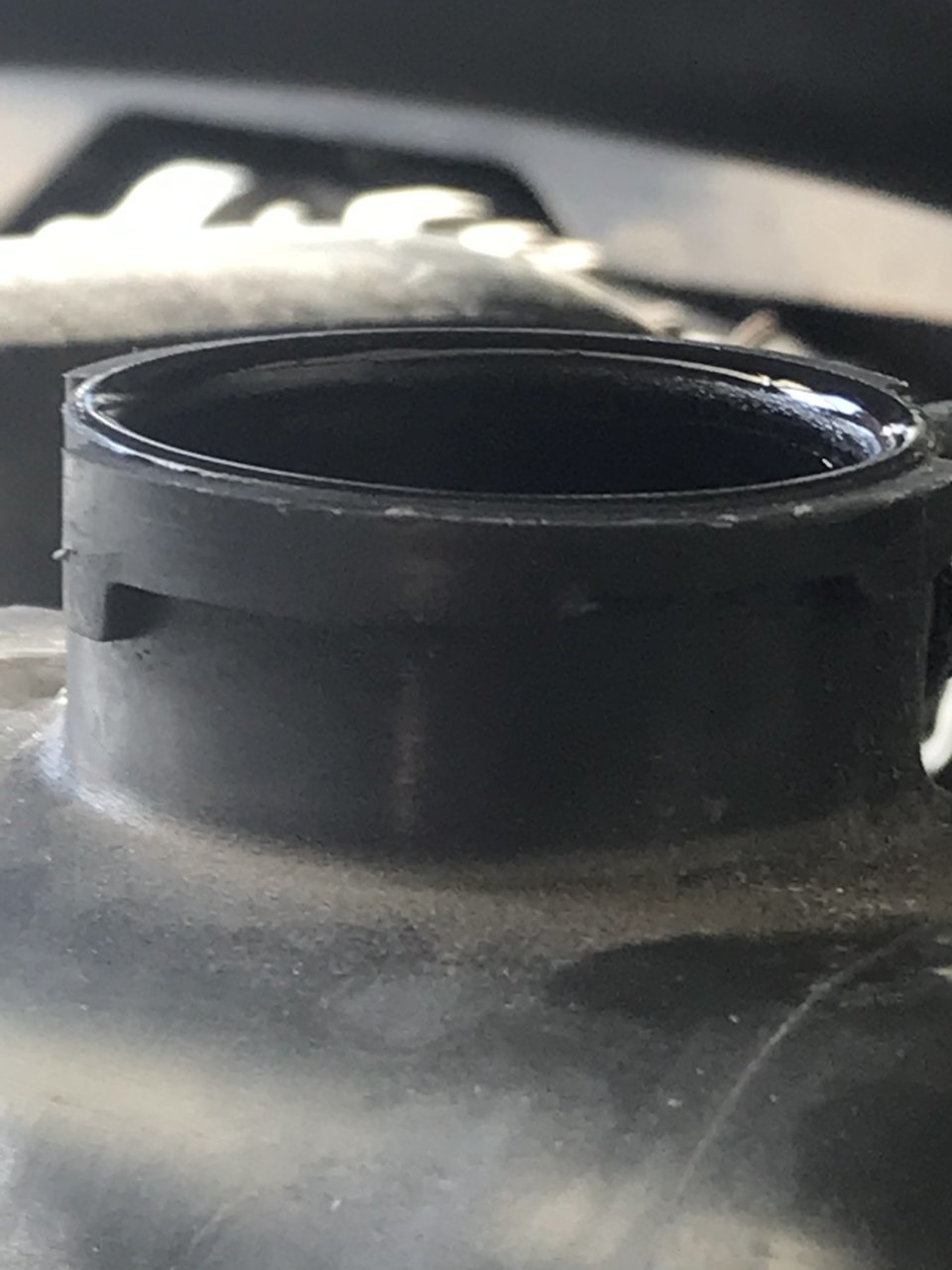

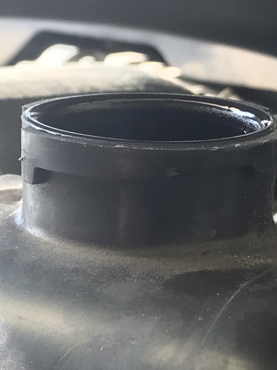

    So initially this guy, might be useful to mention this guy is a bit crazy and maybe a shady mechanic. Had put a generic radiator cap on the newer radiator, when the overheating began to re-occur I got an OEM cap. After reading this comment I looked at the threads of the radiator attachment. It looks like it has been somewhat stripped out.
    If it's possible could you take a couple detailed pictures of your radiator opening with the cap off? I want to compare a rad that isn't overheating with the opening on mine. Potentially this could be the wrong radiator/ or the radiator threads are stripped out not holding pressure. It would be super helpful!
    bmf4069[QUOTED] and Mogo Gogo like this.

    If nobody gets to it soon I will around 530 or so.

    Hard to see tbh

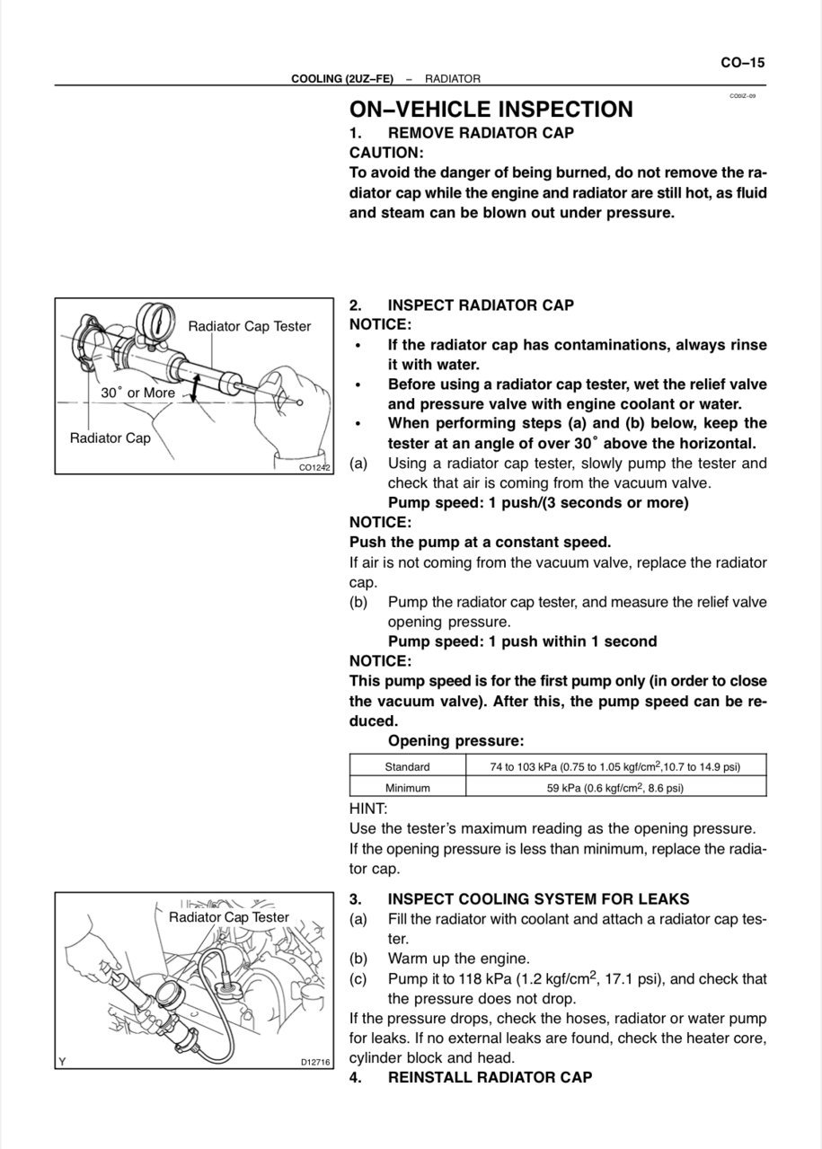

    94A13F7B-9EA3-4685-8F1E-839F085375E6.jpg D7E98E4A-3EA3-4B5F-8057-626F822B2FE8.jpg Are you sure you’re only loosing coolant from the reservoir?
