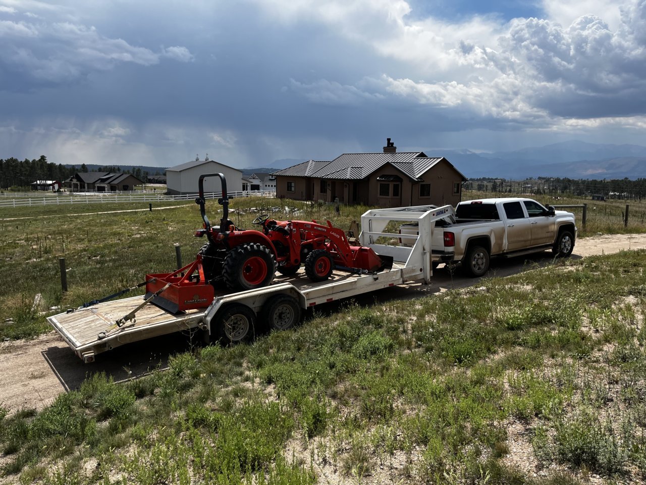

    Well the good thing is you have a 3rd gen with some boost under the hood.
    So in this picture we are at similar weights. Trailer is 24' and 4600 lbs empty (probably 4700 after all my straps and chains) and the tractor in the current configuration is 4679 lbs plus whatever my 7' blade is (probably 350 lbs or more). I know this load is behind me, and that is a 3500HD diesel.

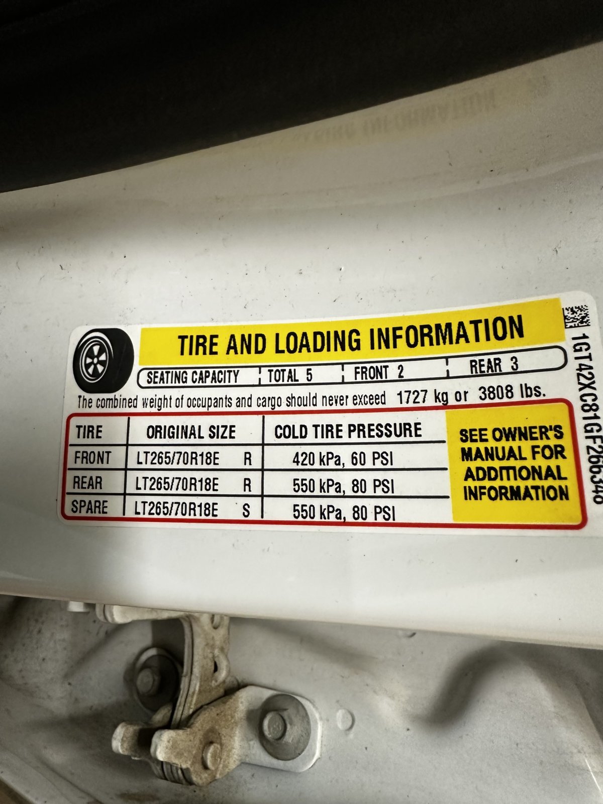

    Have them send you a picture of the door jam.
    This is mine:
    3808 lbs is my payload.

    Thanks Colorado he told me it GVWR's at 9200 with the C6W code rear axle code GT4 3.73
    ColoradoTJ likes this.

    Yeah, GM has been with the 3.73 gear ratio in diesels up until 2020 with the addition of the 10 speed transmission.
    So the truck probably has 22-2400 lbs of payload.
    Just an FYI, I max out my payload (or close to it), so just be sure an older 3/4 ton will suit your needs.

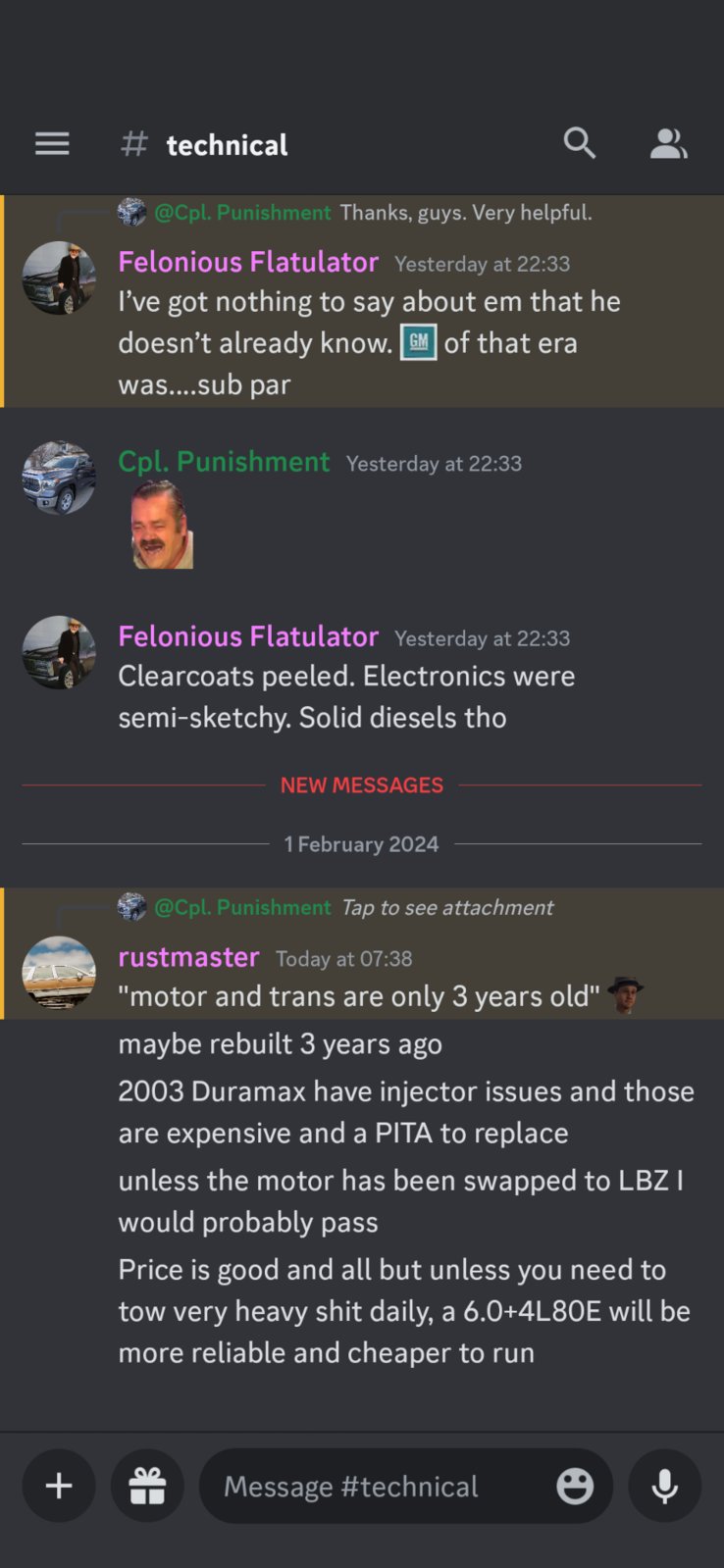

    Got some info from a couple buddies of mine who know about these trucks (ignore their goofy Discord user names).

    Thanks everyone says watch out for injectors...Jasper did the engine 5 years ago at 168k still looks new in the truck no oil leaks...guy that has the trailer has an older Ford Diesel not sure the year that he pulled it with thinking 2003-2008 ish reg cab 8 foot bed
