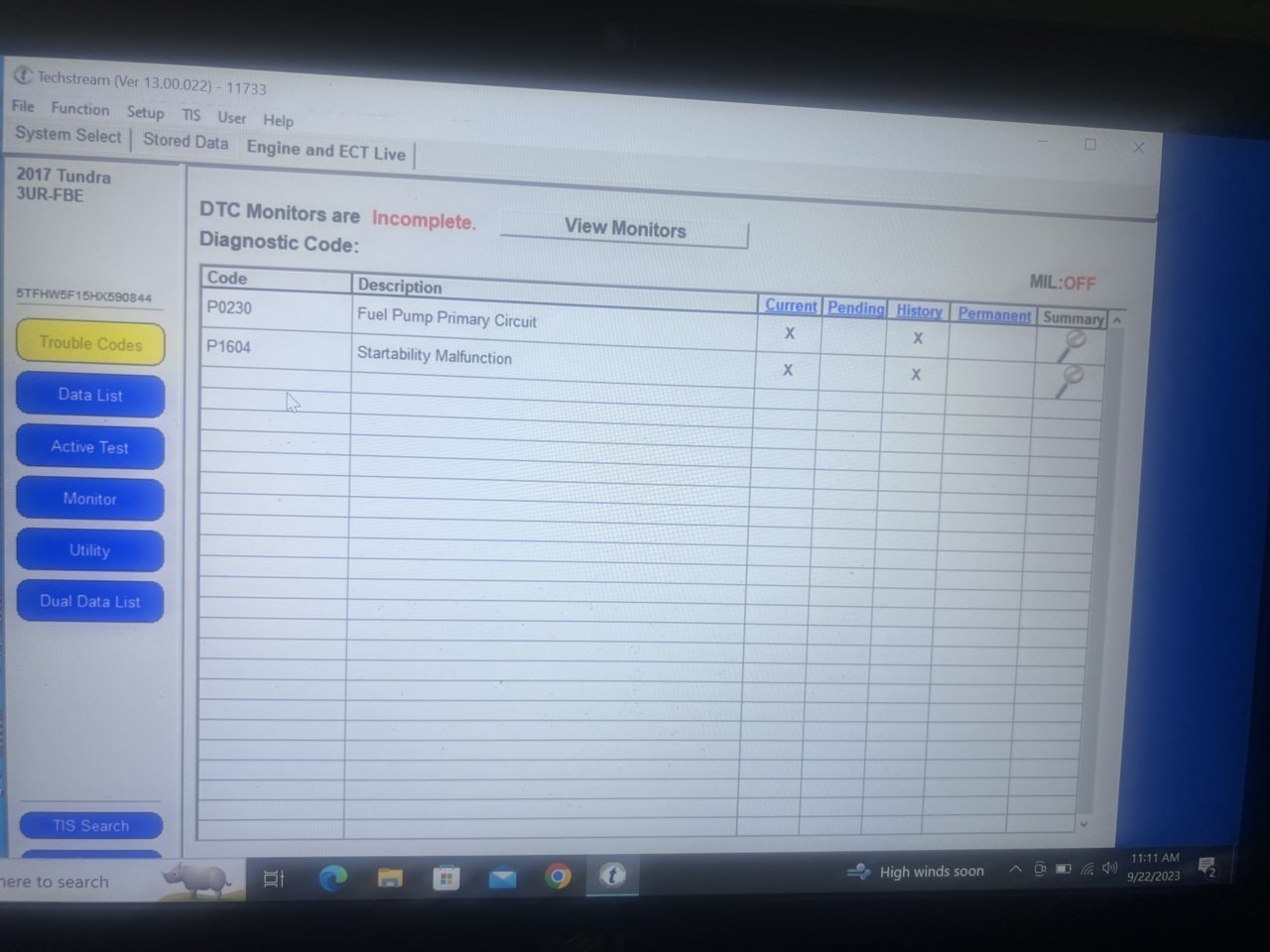

    @Ruggybuggy
    horrible pic but I’ve got P0230 and P1604

    Now we're getting somewhere. Don't condemn the fuel pump module yet. Disconnect the connector to the fuel pump and test for power and ground. You can activate the pump fuel circuit with Techstream. Tundra had a problem with the two wire harness that runs from the module to the fuel pump.

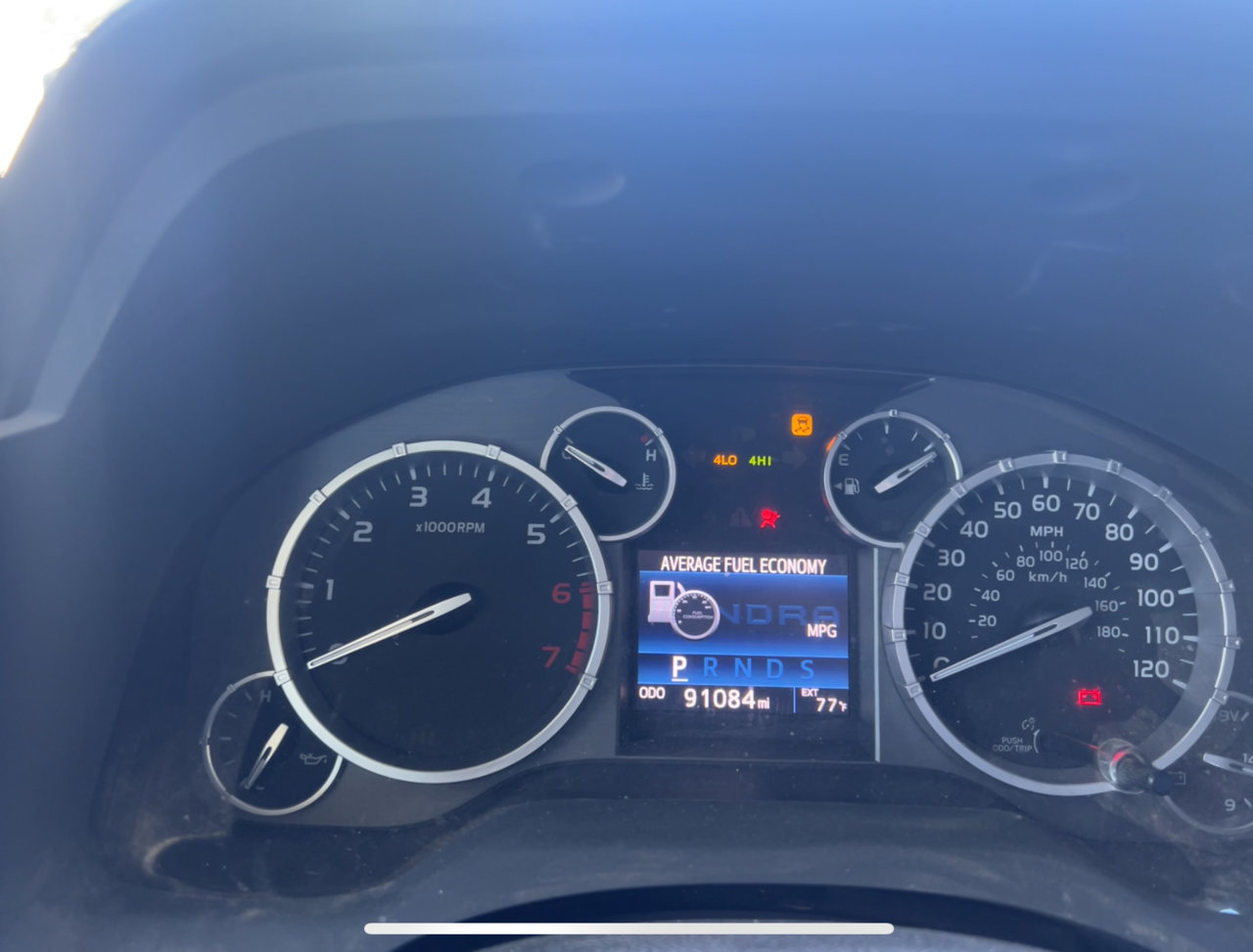

    Got to experience more of this today. Truck worked flawlessly Thurs-this afternoon. After driving all over town this morning and making multiple stops, hit the gas station on the way home. When I went to start it after getting fuel, it didn’t want to start. This time - the starter didn’t want to keep spinning where as before I could turn it off and pull the key and the starter would continue spinning.
    Exact same sequence as before except I didn’t try to start it via remote start. Multiple failed attempts with key, unhooked battery still no start. Unhooked battery second time and hit fuel pump ecu and fuel tank. Reconnected battery and it started.
    Notable difference this time - after the failed starts 4hi, 4lo flashed with trac control, airbag, and battery light on.
    I’ll check for new codes. This is getting old fast.
