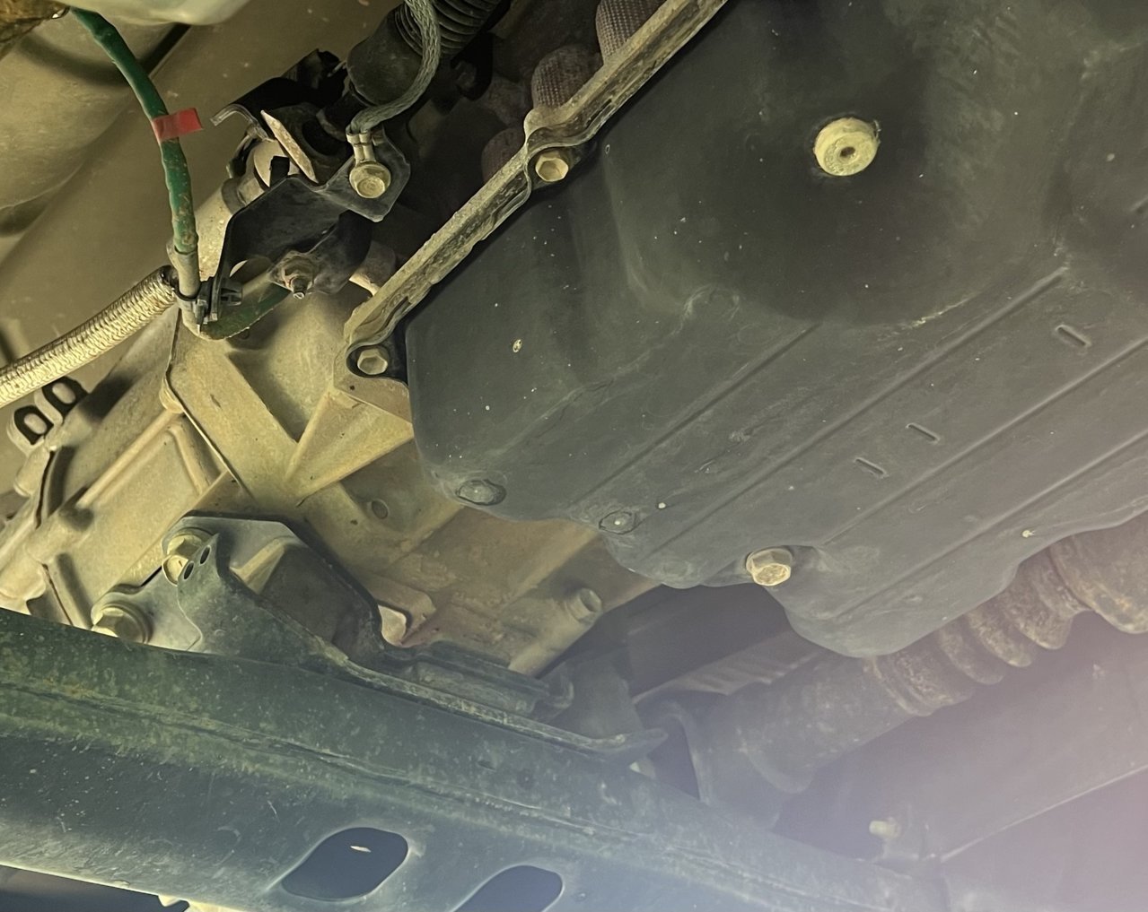

    If someone wouldn’t mind taking a photo of their transmission where it bolts to the transfer case I would appreciate it. I wouldn’t think they would be that stupid to install the bolts incorrectly but then again they didn’t even tighten one. :mad:

    Good news, there’s legit supposed to be a bolt there.

    Awesome thanks! I appreciate it.

    Is it just loose or cross threaded so it cant be tightened anymore? I would call the dealer and have them send a tow truck.

    It was just loose. I backed it all the way out called them got the torque spec torqued it and drove it in and had them put it on the hoist and check everything over in front of me. Not really sure what else I could do. They owned up to it and the truck has their dealerships powertrain warranty to 150k miles.
