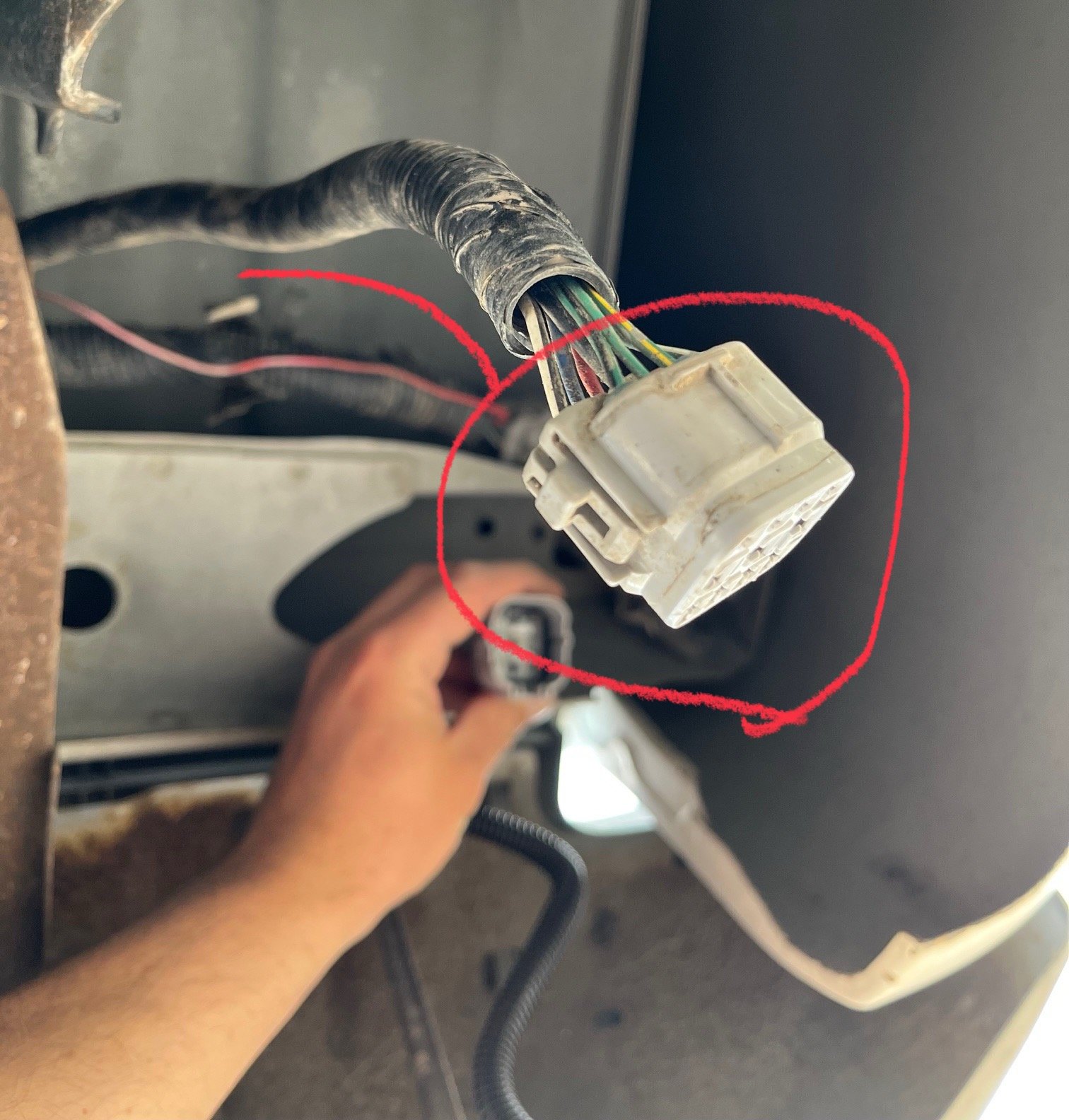

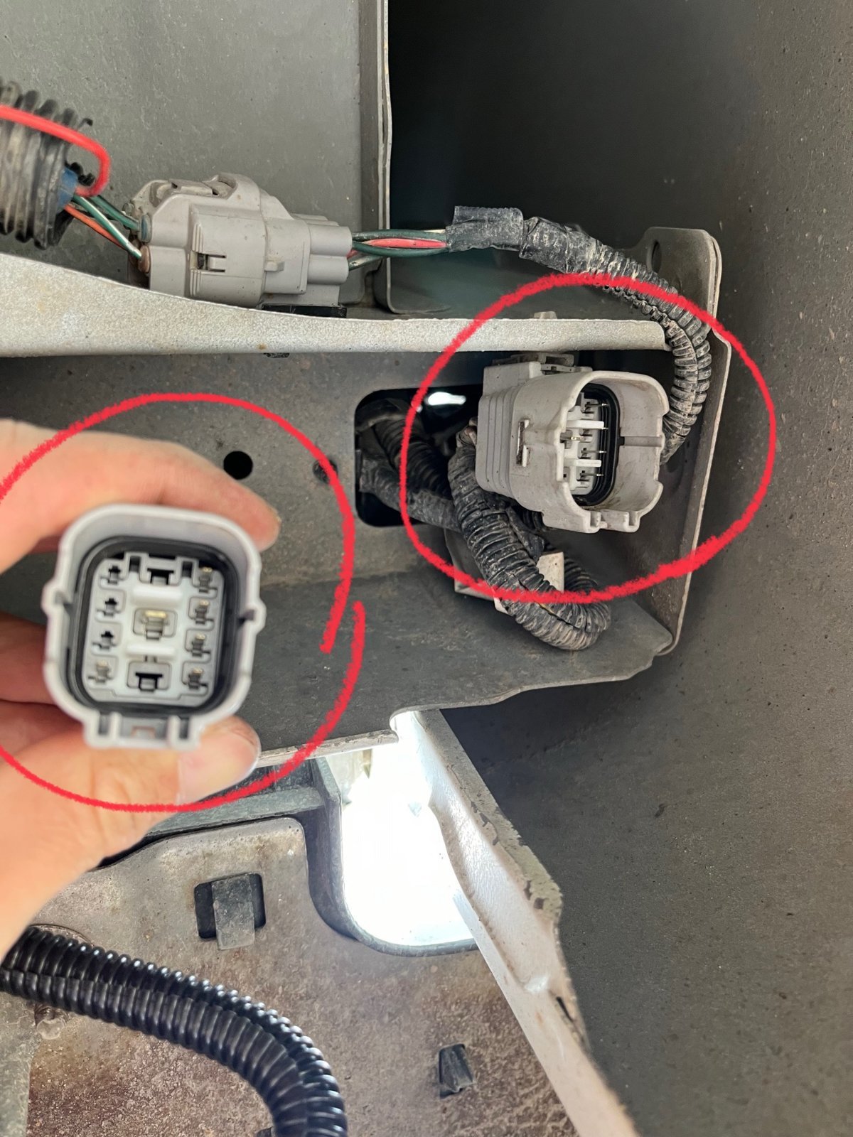

    Alright help me out with some advice here. My truck came with the tow package from the dealership. But I'm replacing the wiring harness with a Tekonsha harness. Things aren't quite the plug-n-play I expected.
    The Tekonsha harness has this plug, which is the same end as the end that's clearly part of my trucks wiring harness. I figured I'd be plugging into this large plug behind the driver side tail light, but instead this harness seems to bypass that plug.
    The tail light plug on my truck connects to another harness, which then connects to my trailer 7-pin socket. So I'm bypassing a lot of wiring harness and plugs by installing this kit. I just want to make sure that's correct. It's the opposite of what I was expecting.
    The new wiring harness has this socket on the left, which is the same end (female) as the end attached to my truck as part of it's stock wiring harness.
    The male end of what plugs into that female end (the one attached to my truck) is what runs to the 4-pin connector. So by installing the Tekonsha, I'm bypassing the female plug that's part of my factory wiring, and instead plugging into the male end in this photo below.

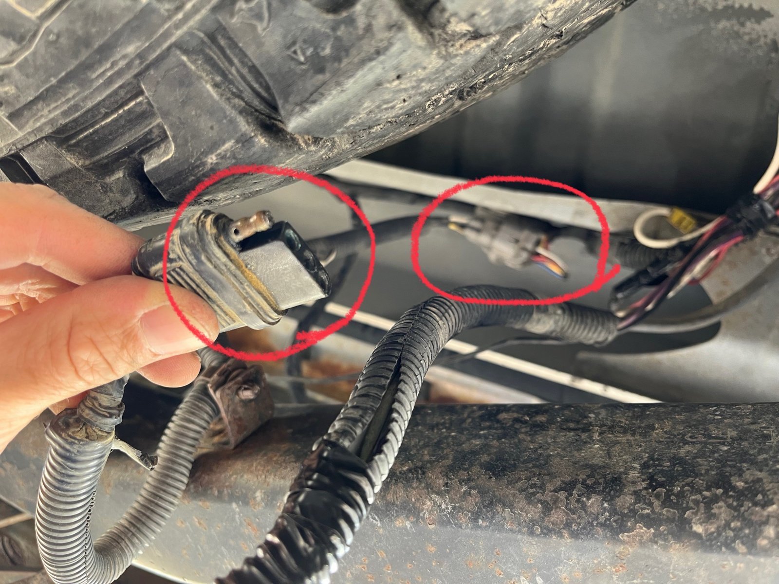

    I thought what I'd be doing is plugging my new harness into the socket on the right in the first photo. Instead I bypass both it, and the circled connections on the right of the last photo. I connect to the plug circled in the second photo.
    Does that seem right to people, assuming I did a decent job of explaining things?
    Since I'm replacing a dealer-installed harness setup with an aftermarket setup, rather than aftermarket with aftermarket, I'm a little confused on what's happening back here.

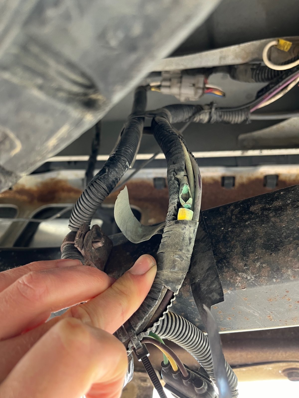

    I will still be working on figuring out everything from the above post. BUT, I did install the new 7-pin socket, and everything on the trailer now works when I connect! It was almost definitely this corroded, broken connection that was hidden inside the conduit that was causing my problems.
