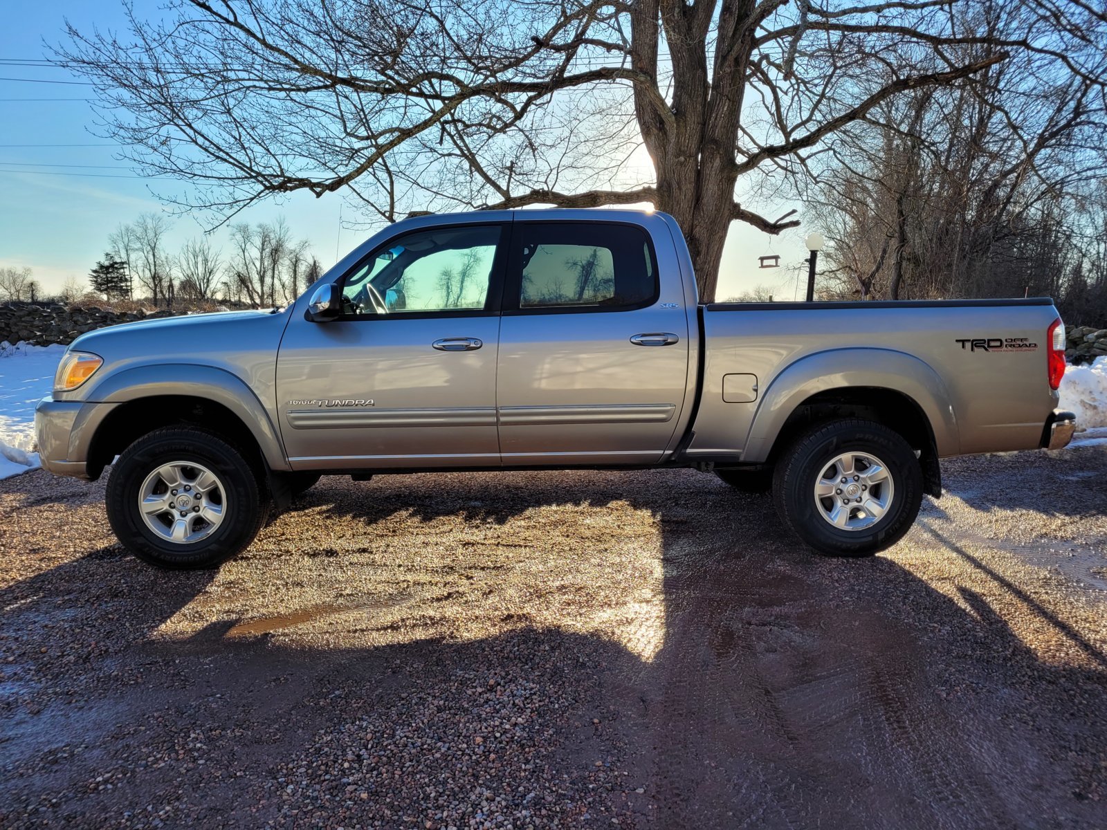

    Can someone tell me if this truck looks like it's lifted? The bottom has undercoating all over, but I don't see and spacers on the front. However the truck definitely seems higher than a stock height truck should be.

    Looks like its lifted in the front. It probably has a suspension lift, so it doesn't have blocks. The lift is built into the aftermarket shocks and springs. That's what it looks like to me.

    The SoAz….. big surprise
    Bone stock
    Center of hub to fender, and what size tyres

    TEXAN....big surprise
    06DC2wd
    you don’t understand the level of nerd some of us are.
    That truck is lifted for sure.

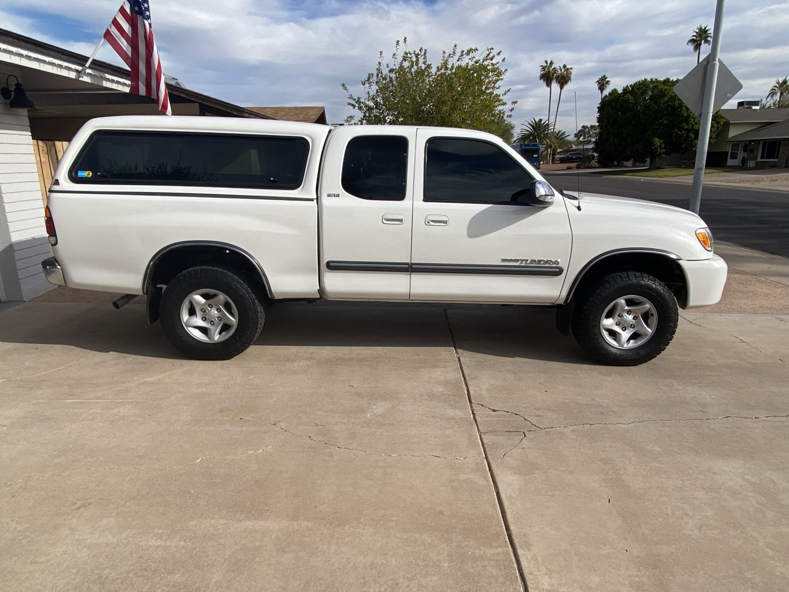

    I agree, because of this. Bilstein 5100s on 3rd perch up front, stock springs.49D7940D-0890-44B5-8E2B-2B3FF167D88D.jpg

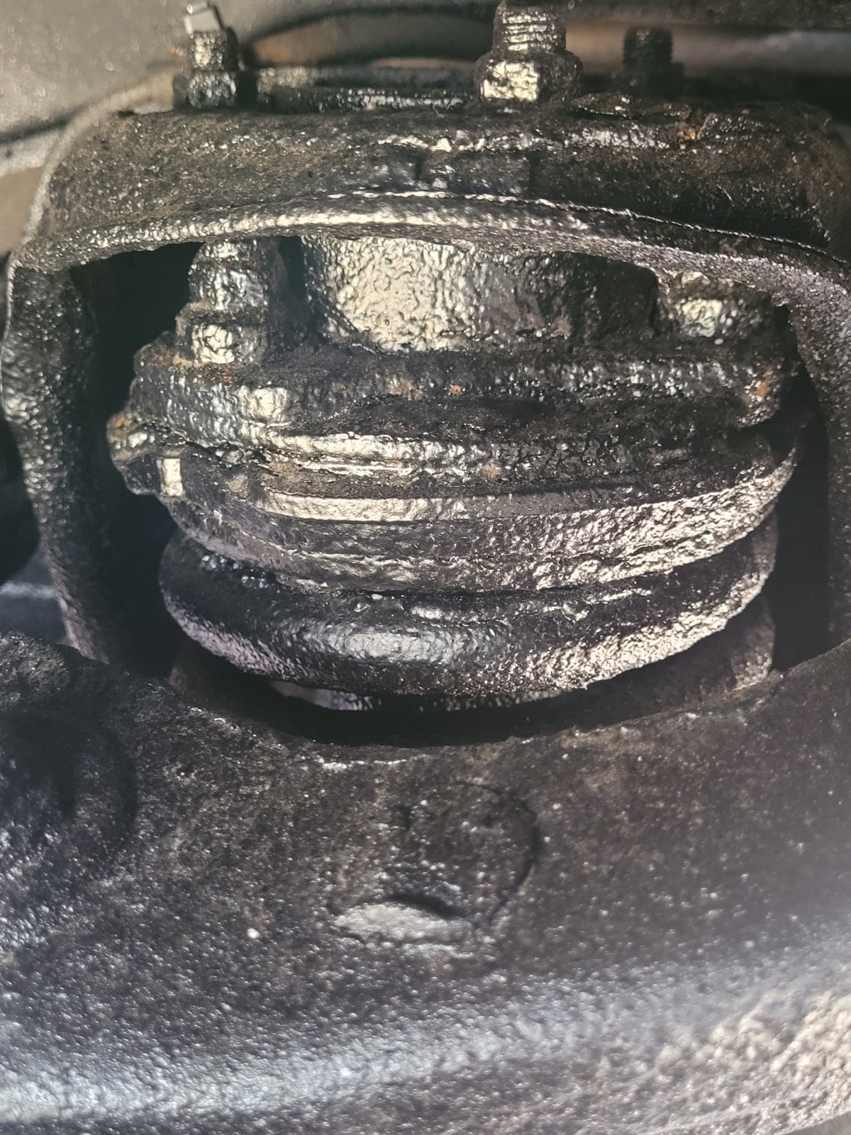

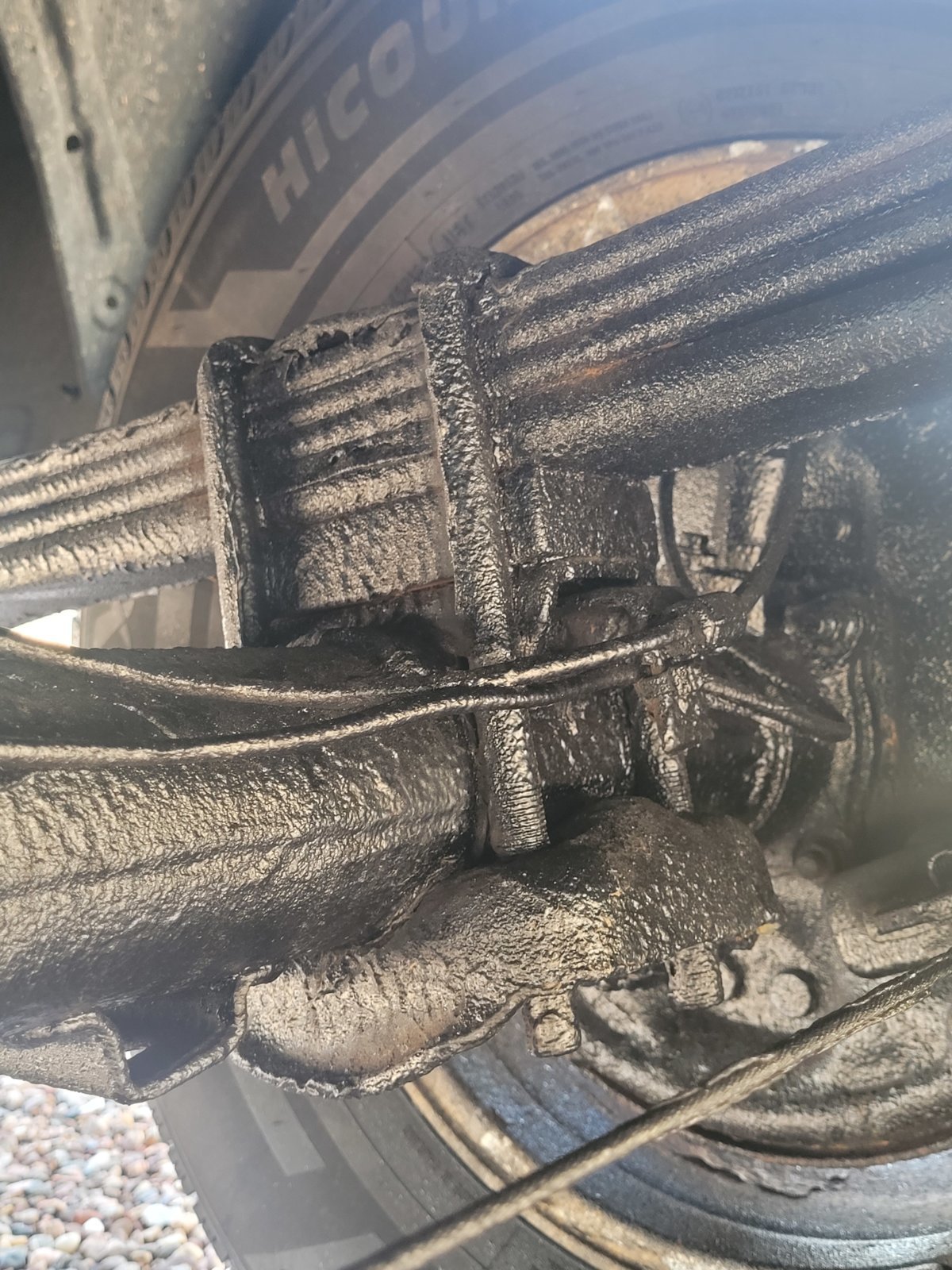

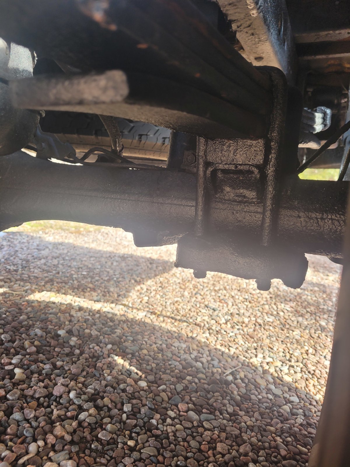

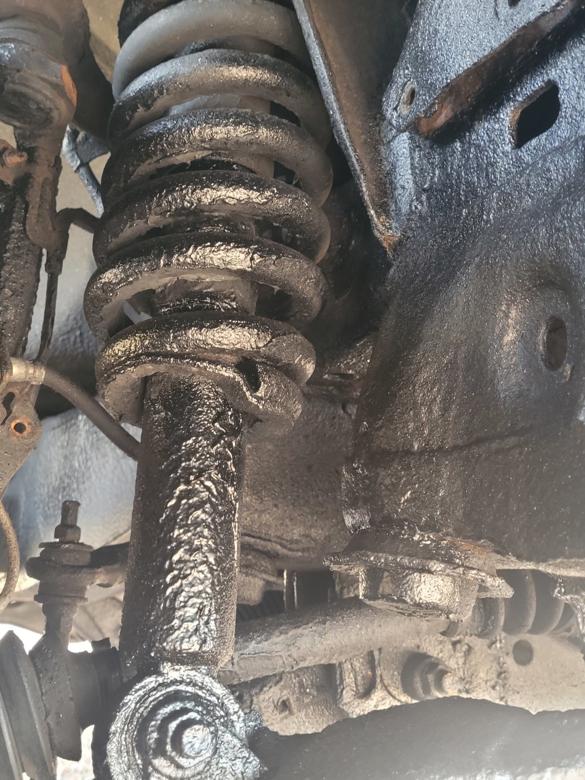

    20240224_102937.jpg 20240224_102954.jpg 20240224_102604.jpg 20240224_102732.jpg
    Measured the front and it was 22.75" from center of hub to middle of fender. Didn't measure the rear ‍♂️. It fits in the garage as it sits now, so height is okay, but I wouldn't mind if it was a little lower. Just want to know so when I buy new shocks I get the right things. I was looking to get the regular yellow/blue Bilstein's, but maybe the 5100 or OME are a better idea. Long term I wouldn't mind some bigger wheels and just adding side steps. Do not plan on off roading at all, most rugged terrain will be a dirt road.
    Excuse the black goo all over, I plan on getting it blasted off and an appropriate coating put on at a reputable shop local to me. Tundra noob, so open to suggestions, but it does appear the front drivers shock is leaking fluid. I do enjoy the process of getting a used vehicle and fixing it all up to my standards.

    So ... you wanna buy / just bought a 1st Gen Tundra, eh?
    You should really read through this. Especially the part about rust. There's a lot to dissect here from your photos. You have strut spacers up front, and lifting blocks in the rear. Both easily removed, and generally not recommended methods. I would be very careful about "blasting" anything under there. By the looks of the frame rail in picture #3, you have some serious flaking that's been covered up by the "black goo". God only knows what other atrocities have been covered up. Hopefully I'm wrong. Structural integrity would be the first thing of concern before putting any money into other components, IMO.

    Yup, definitely lifted, pucked and blocked. And yep, coated heavily, wonder what's hiding underneath? Scary stuff.
