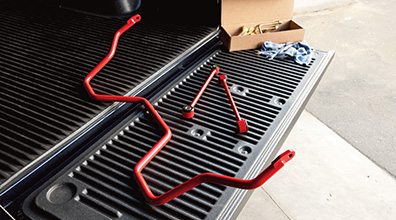

    I was trying to figure out what tools I needed before asking on here but I could not find everything. Obviously I need a torque wrench, but some sockets are needed too, what size? Can anyone advise as to what other tools may be helpful and/or required for this installation? Thanks!
  17. Mar 12, 2018 at 9:22 PM
    #47
    Alptbird
    Alptbird SR5, Limited, TRD, Mutt.
    Mar 12, 2018
    #13524
    33
    Glen
    Houston Tx
    2016 crew max SR5
    Too many to list, I actually have an excel spread sheet!
    1/2 drive socket wrench, 19 & 22mm socket, 19mm wrench. Torque wrench. And something to help you hold the weight of the sway bar up when mounting.
    ccdawnpatrol likes this.

    I have seen a picture of a TRD sway bar that was mounted to the axle by turning the axle bar mounts 1/4 turn to the rear for clearance protection.
  25. Mar 14, 2018 at 7:47 AM
    #55
    ccdawnpatrol
    ccdawnpatrol New Member
    Oct 21, 2017
    #10420
    301
    Salt Lake City, UT
    2017 SR5 MGM CM 4x4 5.7L
    Do you have that picture for reference, or do you think you can find it?

    I wasn't the one who posted in the previous thread, but here's mine. I had to turn it that way to push it out so it would clear leafs during full droop.20180314_162828.jpg
