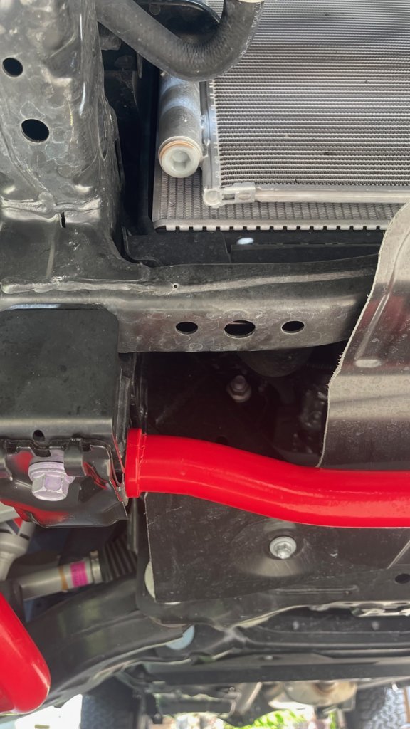

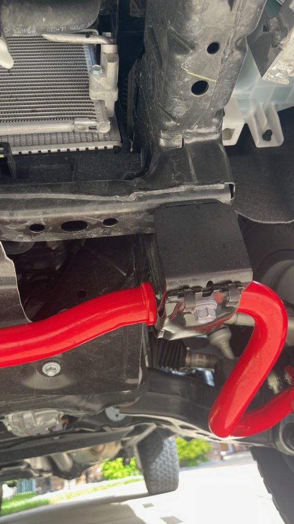

    Funny - I just installed mine today as well.
    Coming from a 3" factory lift, the sway bar end bolt is too long for the trd sway bar end link. I ordered PN 90119-A0579 which I hope is the non lifted sway bar end bolt.

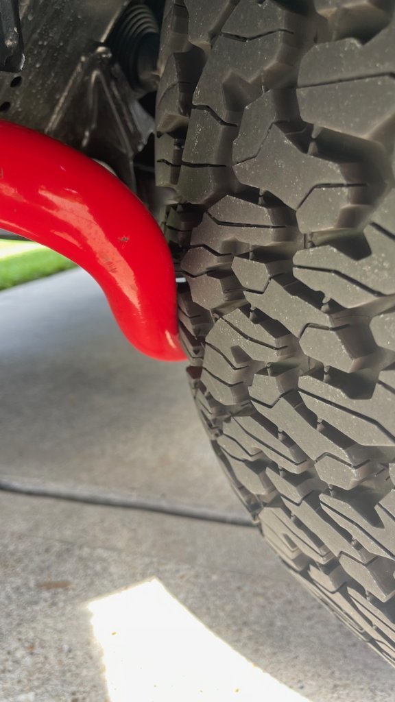

    first: trying to eliminate sway bar rub with the factory 3" lift / 20" TRD wheels / 35x12.5x20 KO2s
    I think that can be accomplished with the TRD sway bar (I gather the geometry is different and allows for larger tires without rub)
    second: I'd also like to do the TRD skid plate without spacers / without having the run the sway bar on the outside of it, if I can get away from the sway bar drop without compromising the ride quality

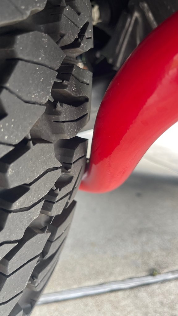

    3" TRD lift 18" Sparco Dakar wheels +29 BFG K03 285/75R18
    @cody.tx Did the TRD sway bar resolve your sway bar rub?
    I just moved up from 275/70R18 tires to 285/75R18 tires.
    I am getting a touch of rub at full steering lock when driving forward now. No rub in reverse or touching when stationary. I was curious to know if the TRD sway had sufficiently different geometry to get ride of my sway bar rub.

    Did you remove the drop brackets or leave it on? Did the new bolts work that you ordered? I just installed the TRD Pro sway bar on the factory 3" lift and realized the bolts were too long - I flipped the spacer around for now but obviously want a better fix

    I removed the drop brackets at first, but after reading online that the drop brackets would help the sway bar perform better (something about the angle being parallel to the ground), I put the drop bracket back. The new bolts worked fine for the end links, but I completely screwed up the drop bar bracket bolt. Must've cross threaded one, and another one the frame nut popped off. I ended up installing a rivnut in that space, but the whole thing was a headache. My warning is make sure you hand tighten those bolts a lot deeper before putting an impact on it.

    I did the same.. uggh.. I still need to repair the thread and will use a helicoil. I think the shape of those bolts makes them prone to cross threading...
